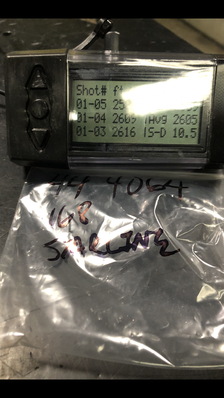

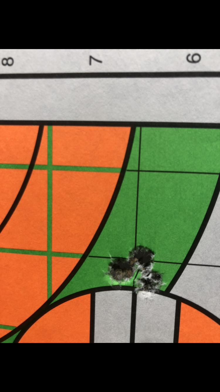

I found that I could never get below 8 SDs with 155s or 168s. But it sure did group nice. Here is what my 700 20 incher does with 168 Speer Gold Dots. I’m a hunter first so I can live with a 10 SD. But for 175,178 and 180s I find I shoot 0-2 SDs most times with well developed loads. I think it’s the nature of the powder.
