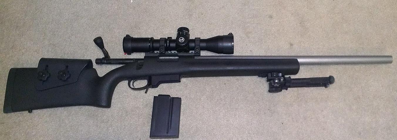

Action: .308 Remington 700 SA"E" series matte
Barrel: PacNor HV, Matte Stainless, 10 twist in 308, 23" x .920" at the muzzle
Trigger: Rem trigger at 2 Lbs.
Trued to perfection. Awesome deal.
From Nora23
Stock: H-S Precision PST035 Long Range stock
Another great deal.
New parts
Bottom Metal: M5 Stealth – Pacific Tool & Gauge
Rings: Badger 34mm on Badger 20MOA Picatinny rail – from EuroOptics
Scope: Leupold Mark 6
Bipod: Atlas BT10-LW17 – from B&T Industries
A bolt knob upgrade - LongRifles Inc.
A stripped screw (due to my own error), a new rail (again with the screw, don't ask), a little Dremel work to fit the M5 to the stock, and build complete.
Total build cost ~$3300.00

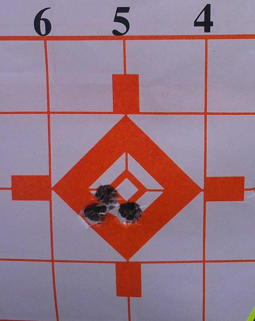

Amateur bolt action shooter printing .75 inch at 100 yards on the first day. Priceless.
It should settle down even more as I make a few minor adjustments and get better at relaxing...

The finished project:
First day settling down on the new build:
From Nora23
Another great deal.
New parts
