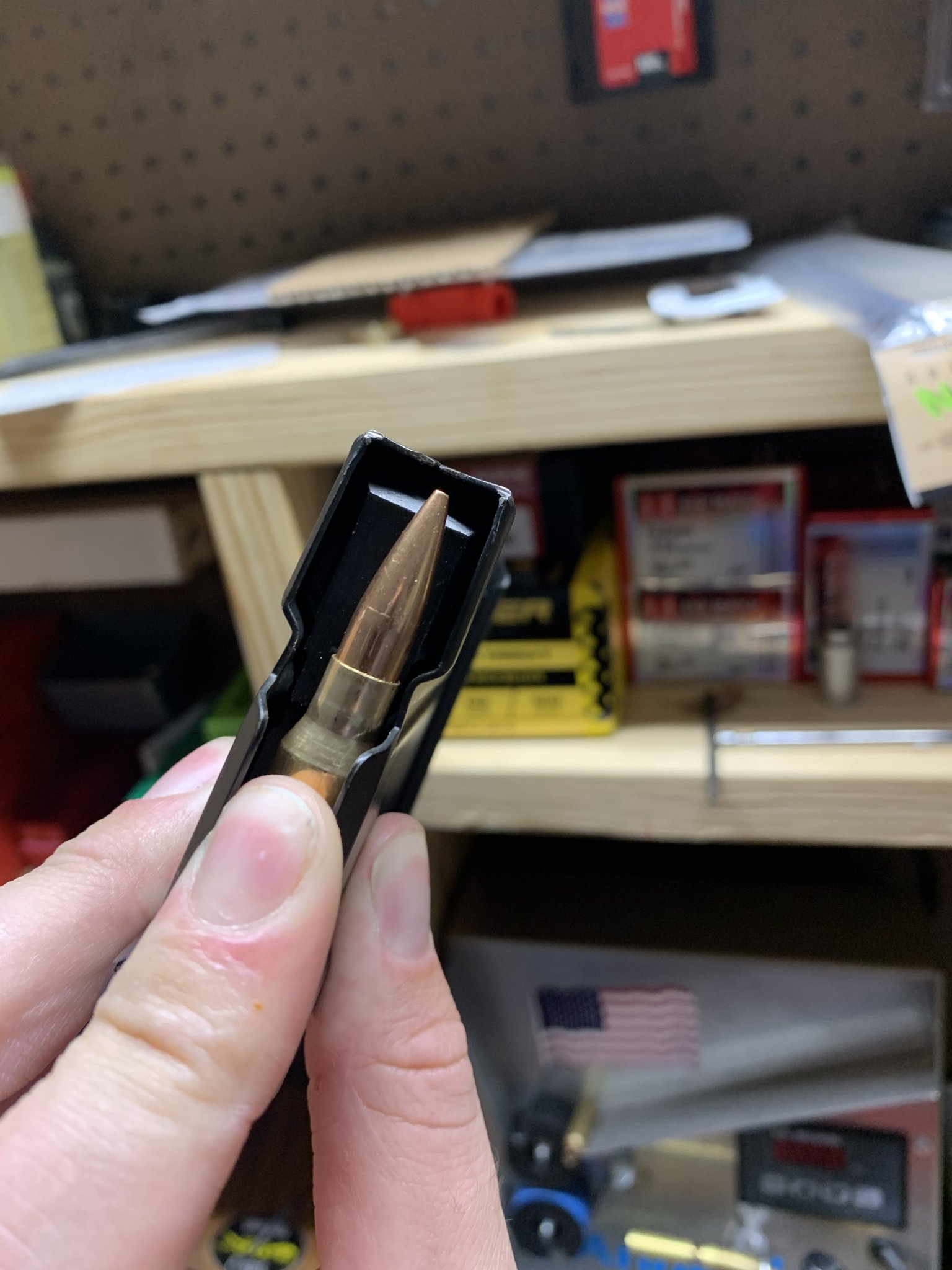

    I can run them to the lands and fit in the mag no problem. But def won’t fit in the AR 10 mag
