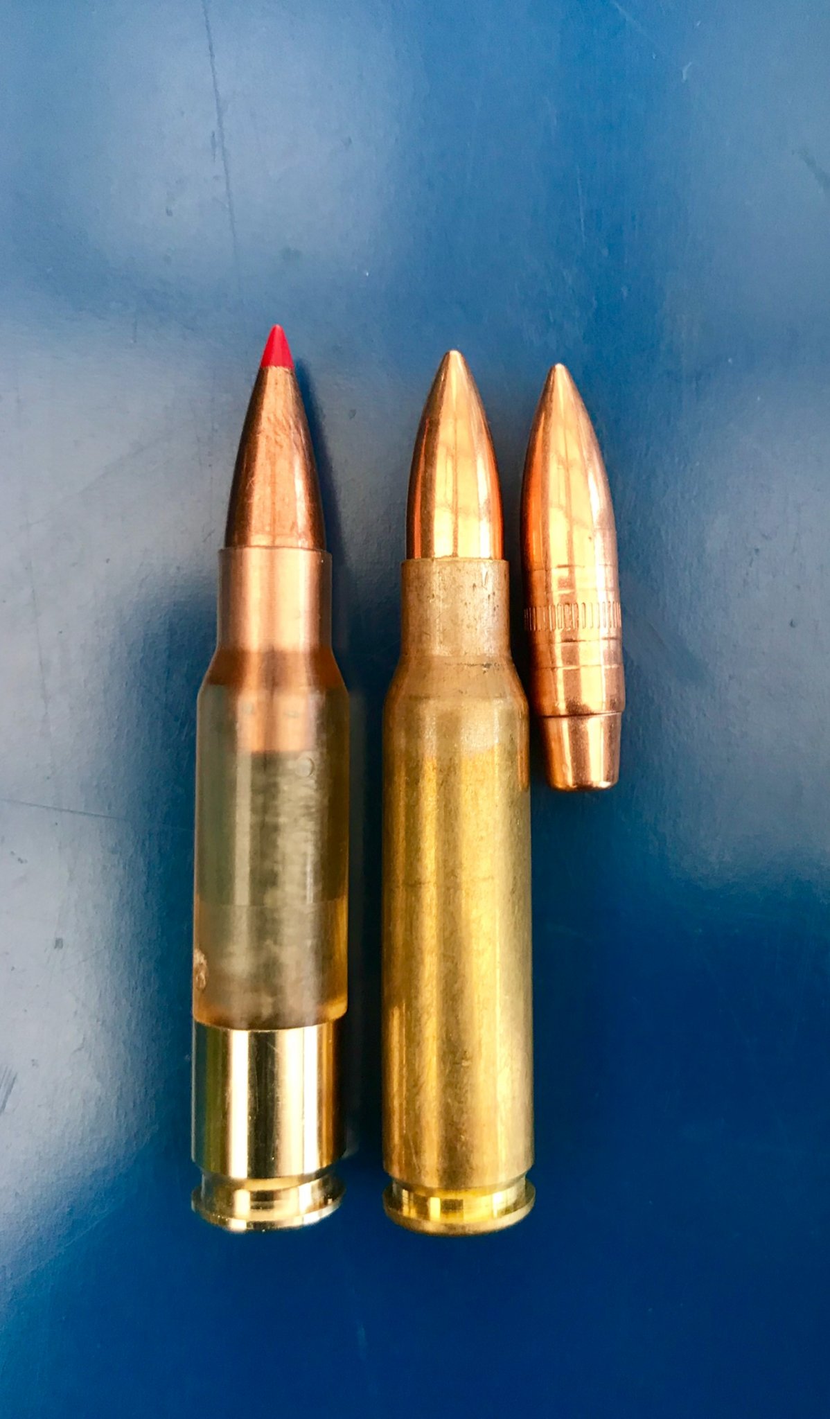

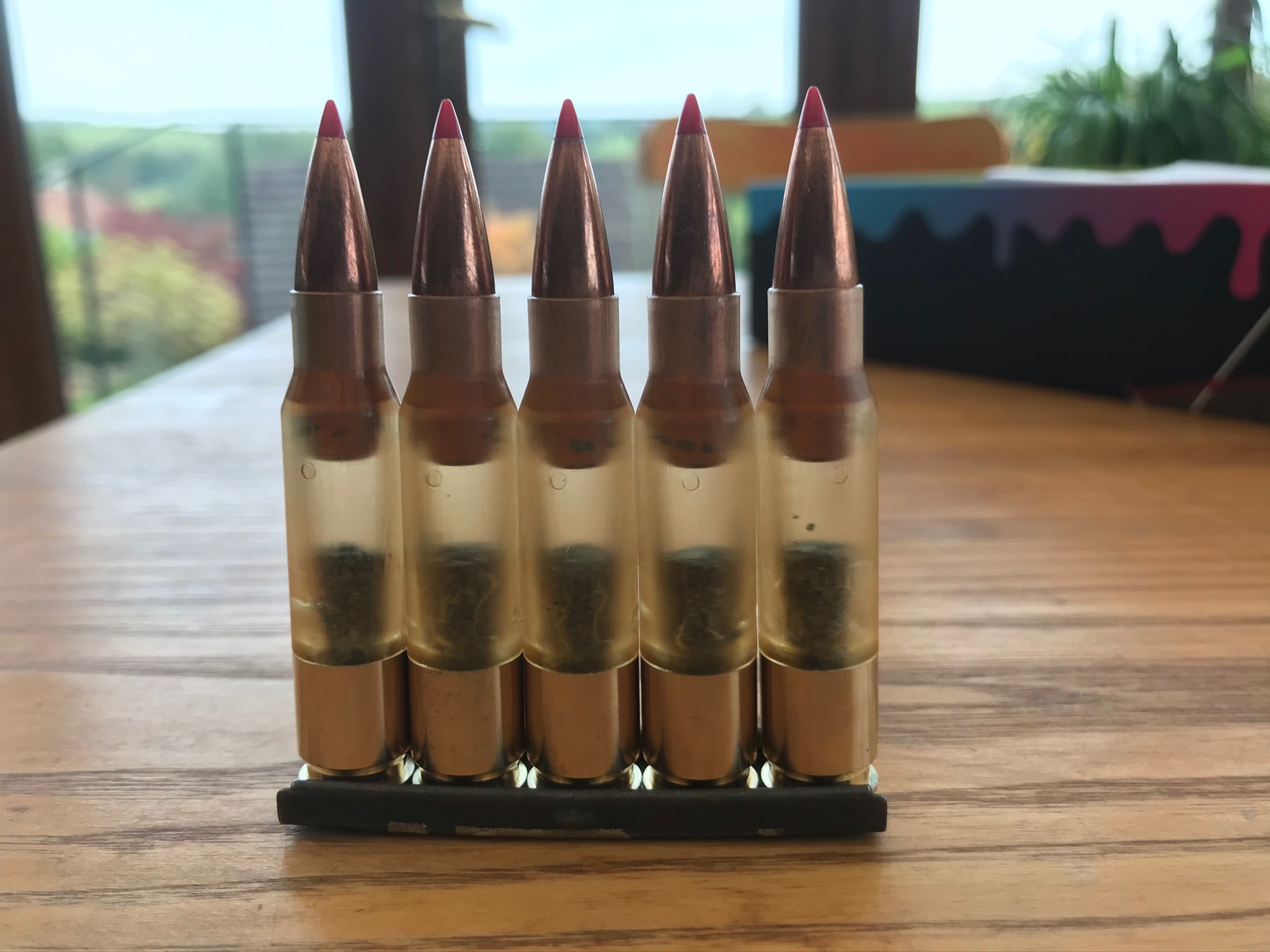

Case in point, these 308/7.62 subs. Right side is my “normal” Lapua load, whereas the left hand round is a tad different. 6.3gn Autocomp behind a 178gn Hornady ELD. Case capacity is roughly half that of a normal 7.62mm cartridge.
