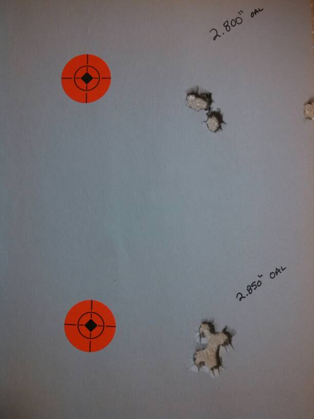

i jump the 178 a max bullets .060. secant ogive bullets started the myth that closer is always better. i had good results jumping bergers at .060. it is just what each gun likes. but the a max is a tangent ogive design that is not as sensitive to seating depth. my go to loads are 44 varket and a 168 a max and 43 varget and a 178 a -max both loaded to 2.8. you just have to experiment and see what each gun likes. i shoot tons of hornady bullets they are half the price of the others.

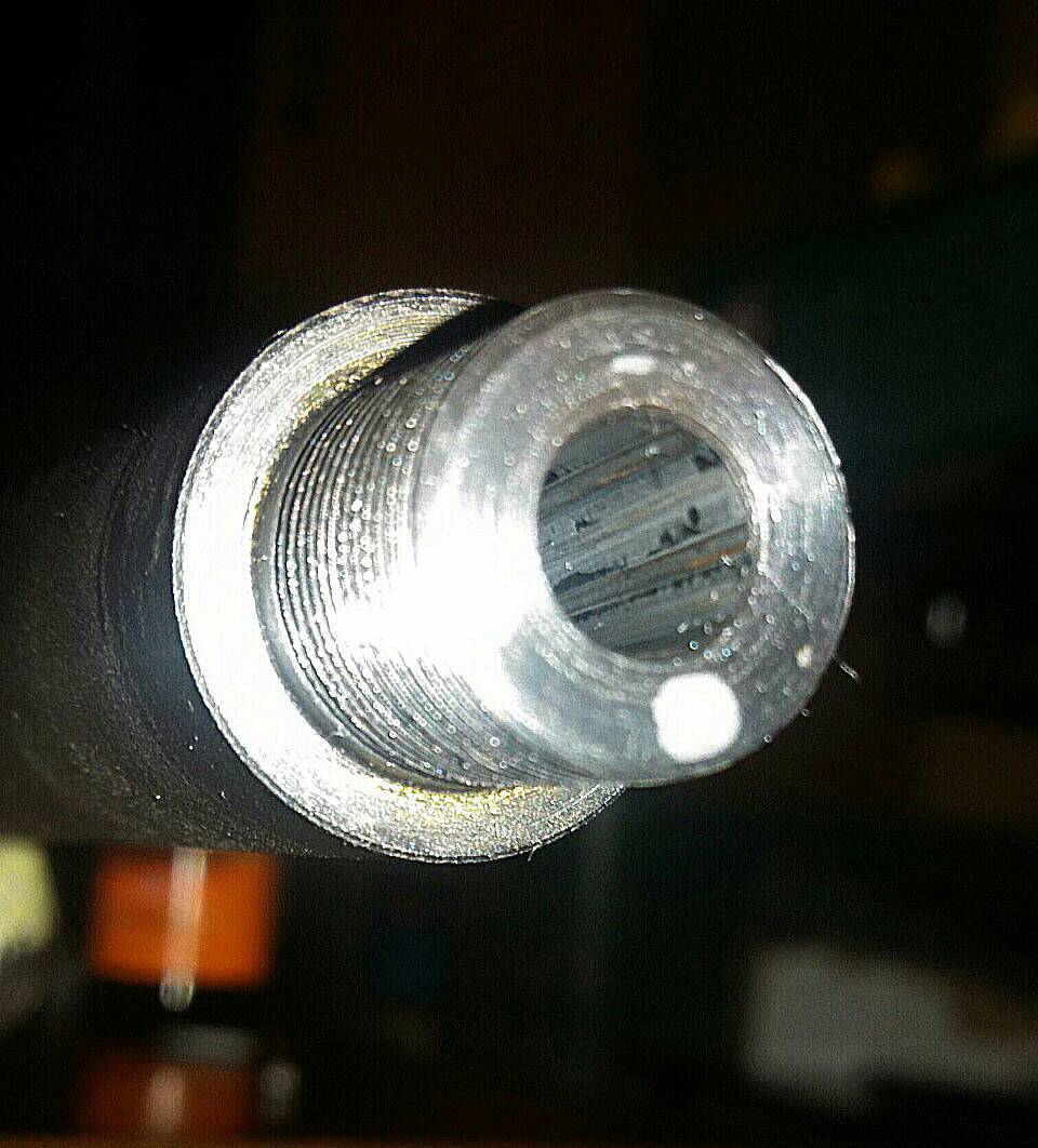

Got some better results. I think it was due to dirty barrel. Picked up some Bore tech Eliminator and cleaned it real good also reset my sizing die. Might tweak a little bit buy overall happy now

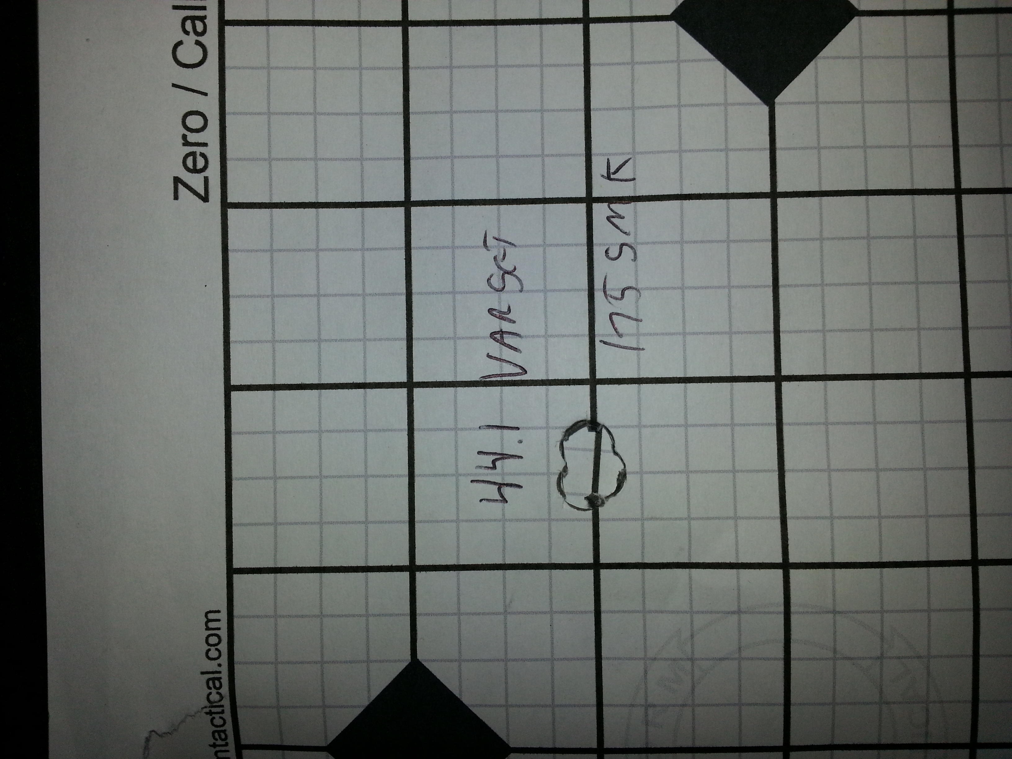

I love the 175 ' s I get a nice sub MOA with 10 shots using 44 grains of Varget loaded to 2.805 with Winchester brass. Using Lapua brass I get more velocity using 43.7 grains of Varget but the same size groupings. Try some out. My gun loves them
+1 on 44g Varget behind a 175 SMK. I think it's a pretty standard load, as well. Lots of folks in this game are having success with that recipe.
