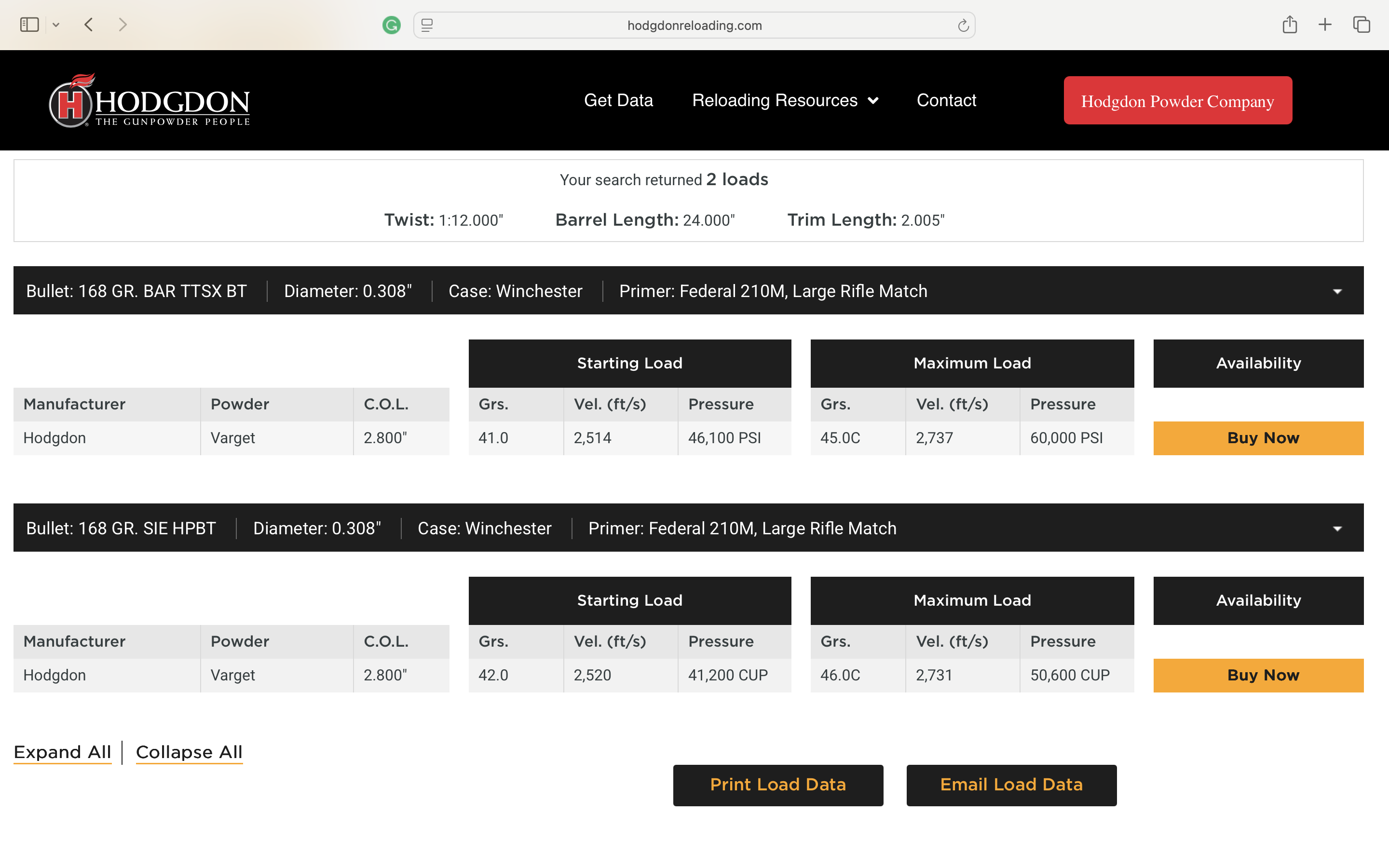

Something seems wonky. I don't own/run a .308, but just by pumping what you've shared about your load into Hogdon's load data site, with 168s and Varget, it doesn't appear ~42gn should be showing pressure (and while some primers are better than others as far as consistency, IDK if different primers really matter much as far as pressure/MV IME, so I wouldn't even factor that in or worry about that as long as they go bang).

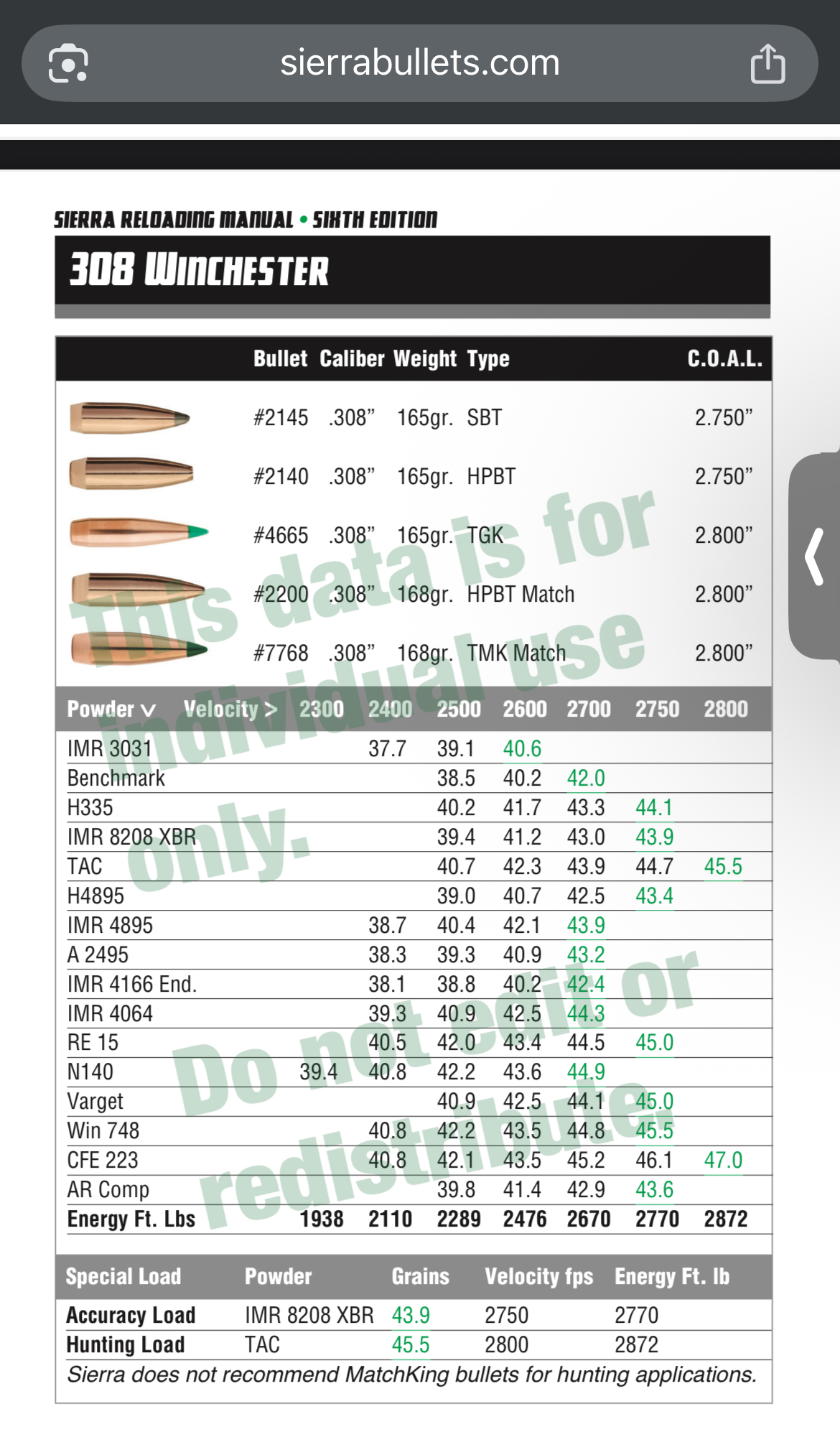

For cross reference here’s sierra’s load data. Looks like they have max for varget at 45gr @ 2,750 fps. I wouldn’t expect him to be getting sticky bolts at 43 grades either but I guess each chamber and barrow is unique. As you said there could be a carbon ring or something.

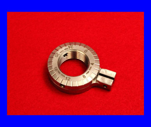

Opinions on click-adjustable sizing dies? Looking at Whidden. Hate to spend the money but it would speed up my process. Whidden offers dies with or without bushing for the same price. If I went with a bushing die rather than expander mandrel, that would really refine my process. Wonder if the bushing in the Whidden die can be removed if I don’t like it, or just go with the FL die. Will ask Whidden before ordering.
bushing dies are FL dies. The click adjustable just moves the die up and down for bump. you should get the bushing die. you do not need a mandrel. but if you later choose to use one you buy a smaller bushing and then expand with the mandrel.

I used Hodgdon data until learning GRT. It wasn’t in line with reality. They tested with different brass. In hindsight, it was a headspace issue. That was probably before I learned about shoulder bump, and how changes to brass dimensions effect pressure.

Never saw the need for an adjustable bump die. The die body has a 14TPI thread. 1/32 turn is approximately 2 thou. Seems easy enough to measure the shoulders and adjust any die to get the required 2 thou jump. Then lock it in place. I have a sizing die for every target rifle and a general die for playing around with my hunting rifle.
