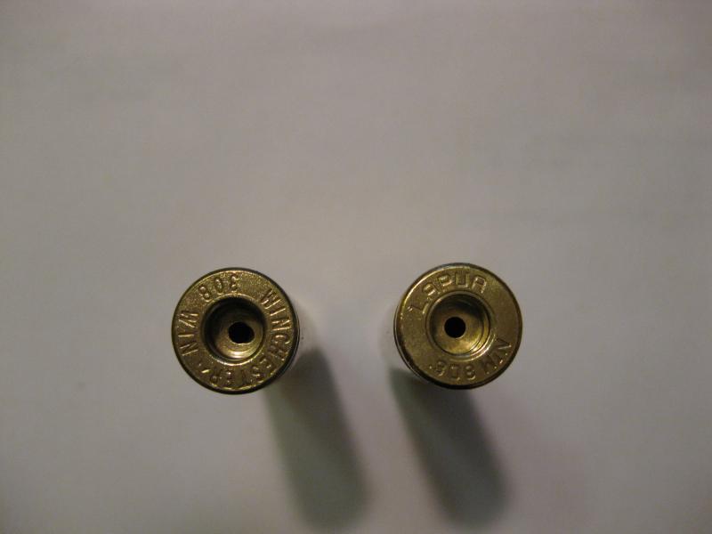

New reloader here, I was sorting out my once fired brass and I found some that the primer pocket flash hole where oblong in shape compared to new lapua brass I have. Is it safe to reload the oblong primer pocket flash hole or just trash it? The tool I used was a Harvey deprime tool.

One brand is $75 per 100, the other is $45 per 100.
I wouldn't worry about it too much. Sinclair sells a tool to uniform the primer holes to .001" over SAAMI, but I don't know if I'd go to the trouble.
