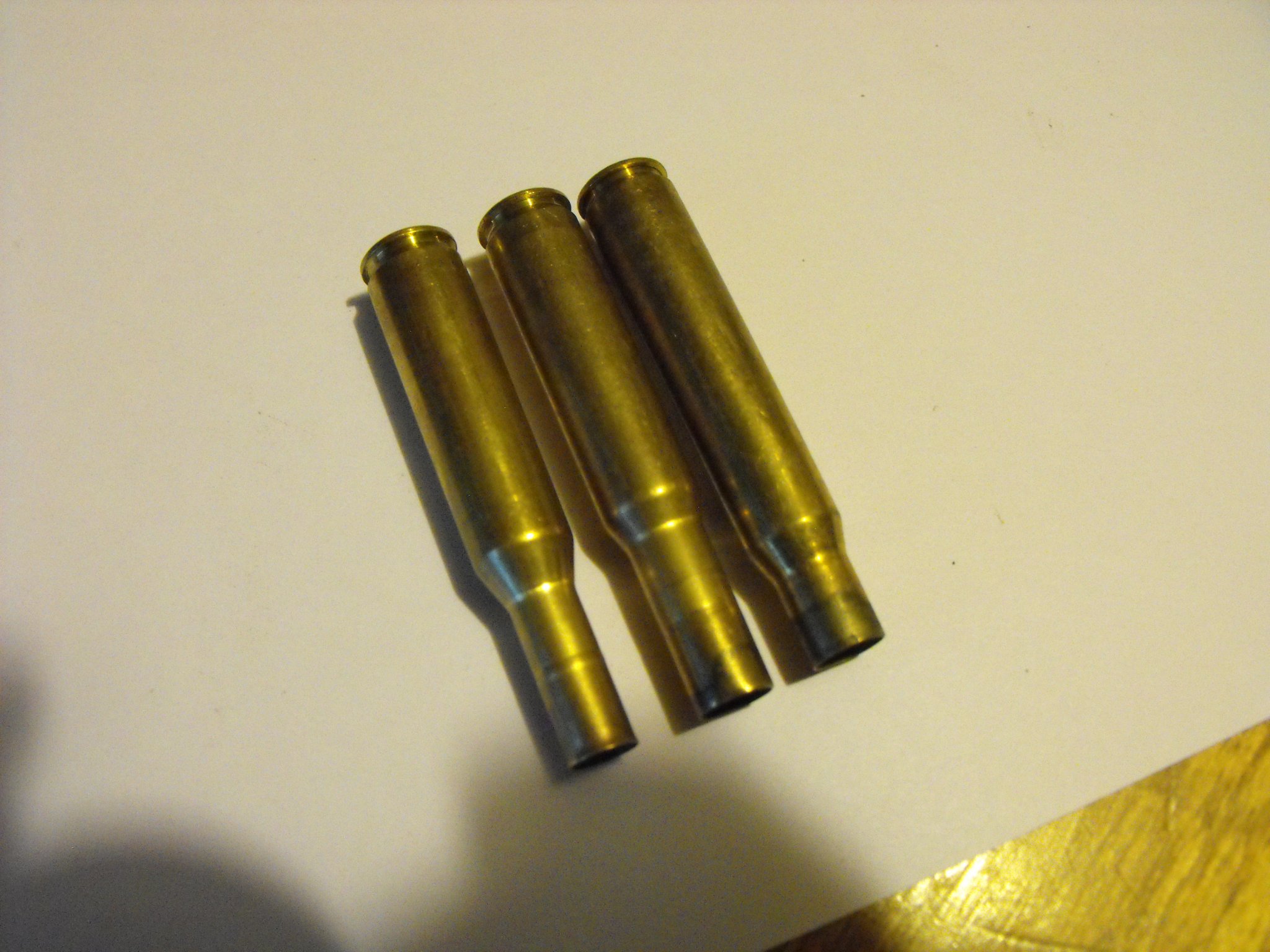

For my Tikka 260rem I formed brass in one step. Lapua Palma 308win, converted to 260 did not require neck turning. I even made "custom" neck fit brass from 30-06, all sized down with Redding type-s without bushing and deccaping pin. Lube, anneal if necessary, and go.
