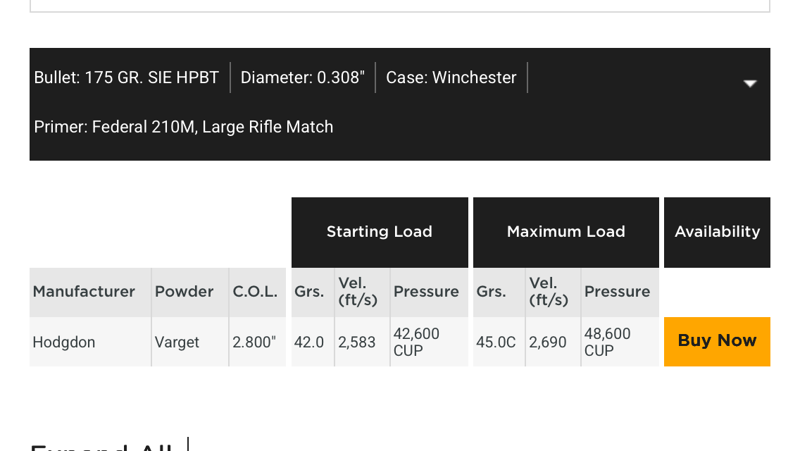

I was looking at the Hornady data yesterday, and they don’t actually have load data for the 174 and Varget in the manual.
I was intrigued by the bullet, as well, until I found my gun likes the 169 SMK. Might be a fun exercise to load some up and see if they’d do well enough to be competitive.
Just use the 176 ATip or 178 ELD data.

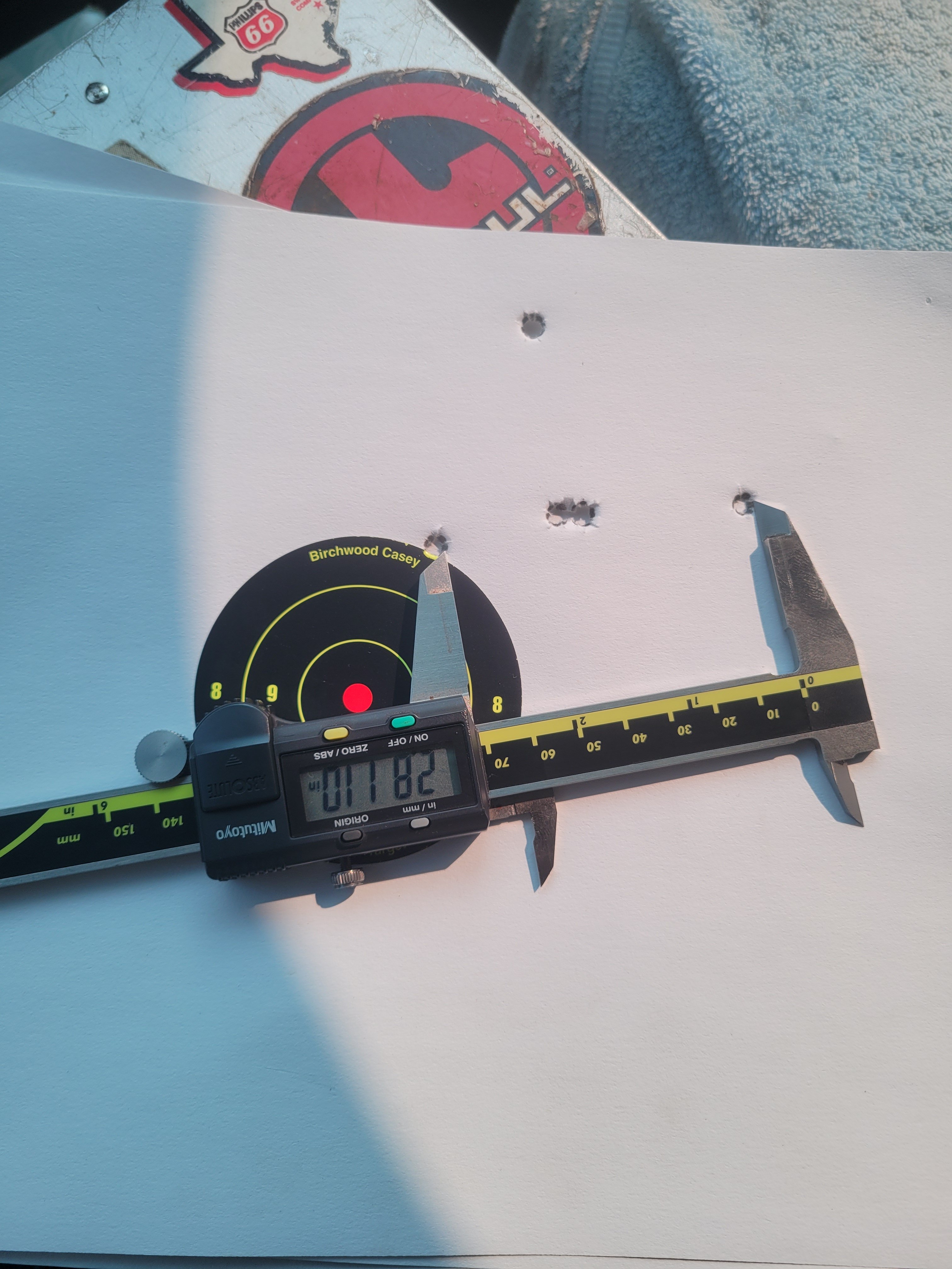

I shot this group at 600 with my 6 dasher and some really poor loads (they did group well at100) running an sd in the low 20's and es in the mid 50's.
