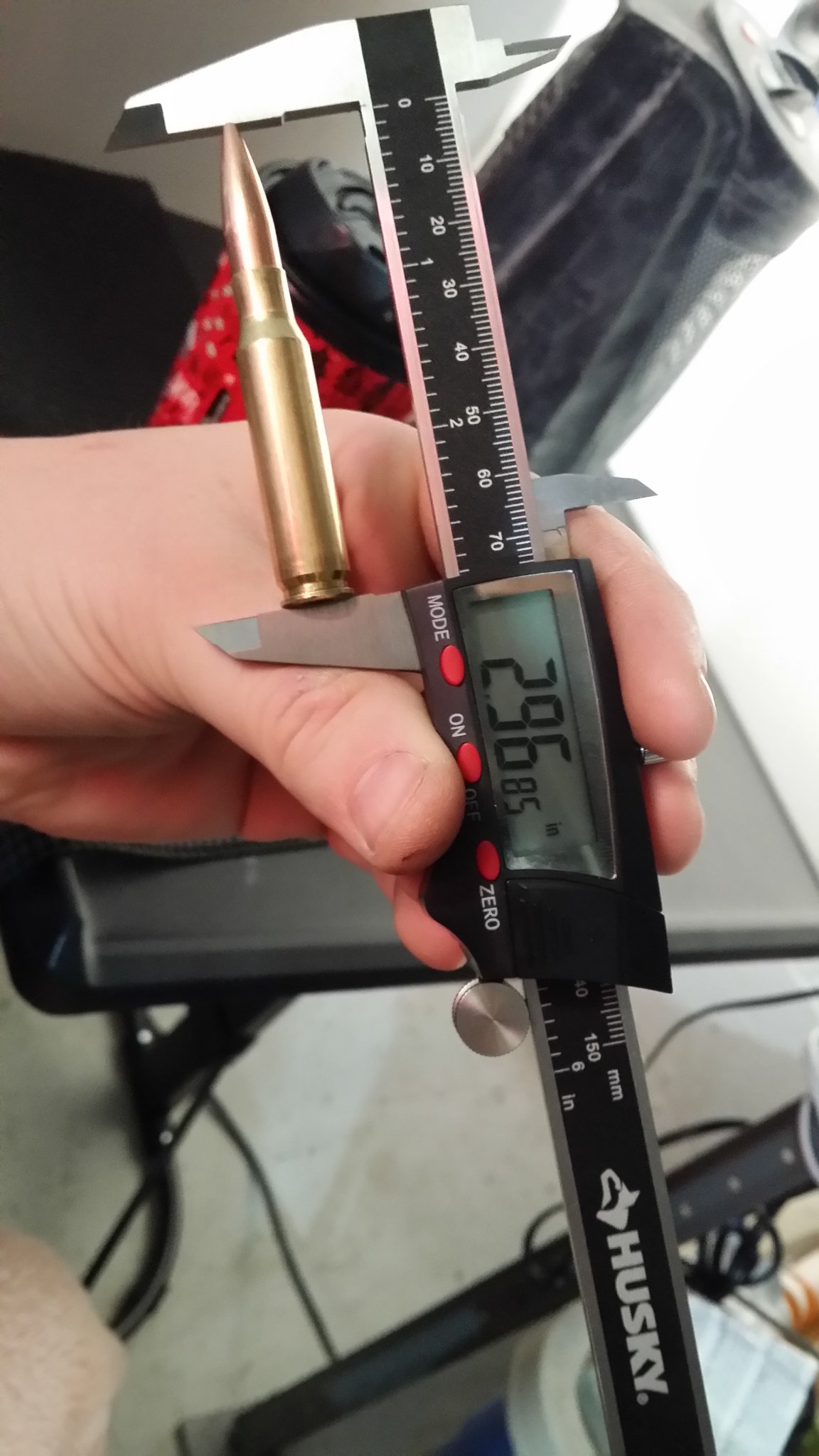

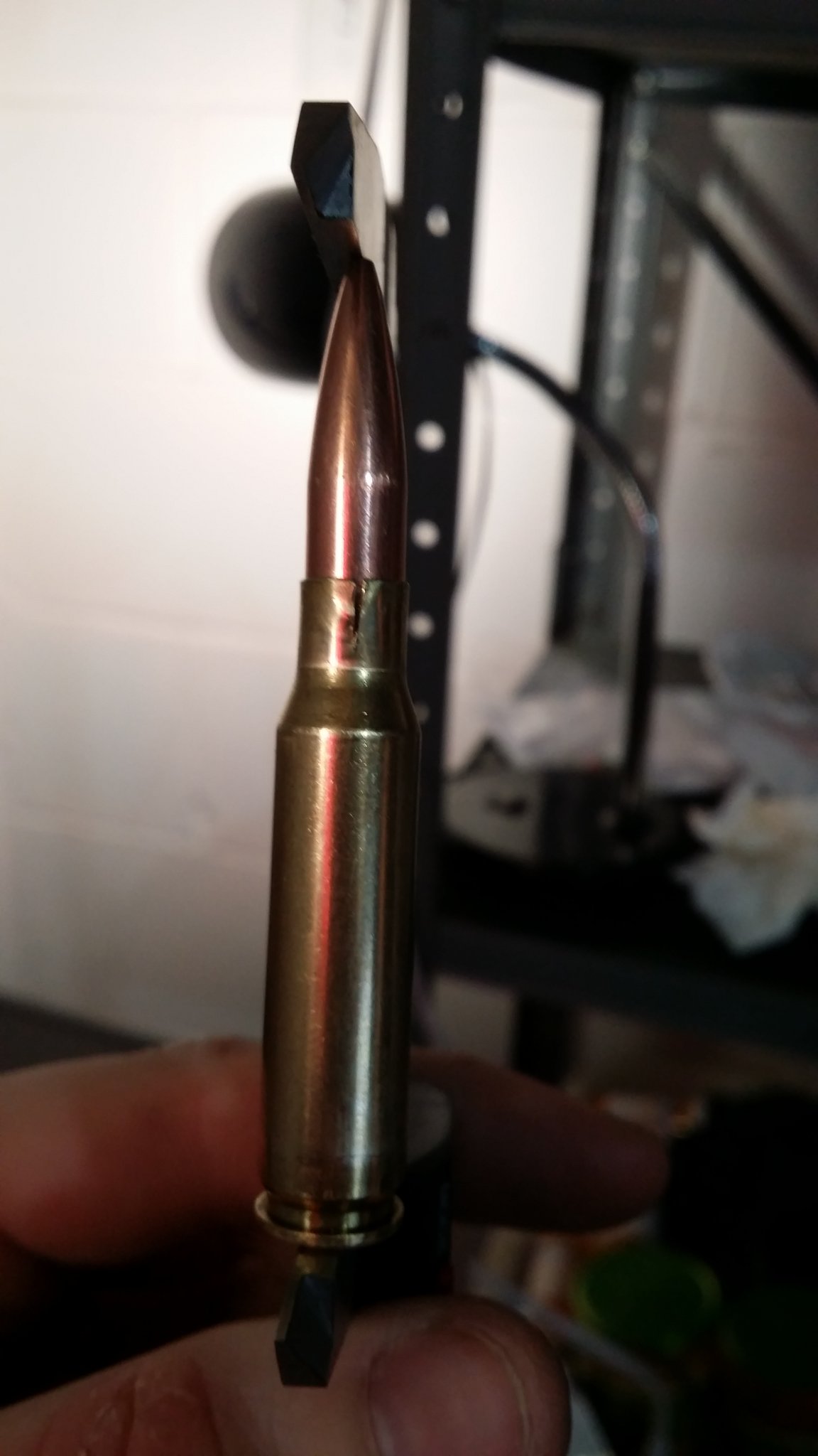

Take a fl sized case and cut a slit down the neck. Stick a bullet in the neck and push the round into the chamber. Push the round out of the chamber with a cleaning rod. Measure the oal. That’s where the bullet touches the lands.
Don’t use the bolt.
Reactions: jLorenzo
10/4 pretty simple. Then use the ogive comparater for OAL measurment?
Look right? Just used a razor down the neck and FL sized again to get it concentric.

I've been loading mine around Hornady book COAL at 2.810 so it appears I've been running a lot of jump. Any idea where to start jump wise?
That’s the idea. But cut the slit all the way down into the shoulder because you want only slight resistance on the bullet.
In my rifle the 178bthp hits the lands at 2.935” I reduced that by .020” to start.

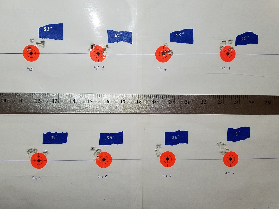

Here is some load testing I conducted with Varget and 178gr Hornady HPBT, going from 43-45.1gr. Loaded to mag length. I believe 43.2gr was book max, so use my results with caution.
