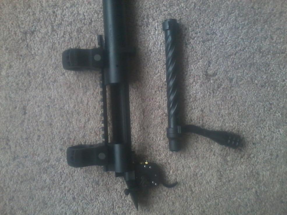

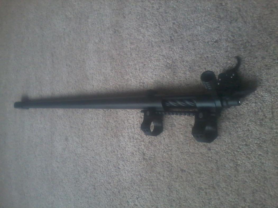

for your viewing pleasure. now just waiting on the stock and scope.......i hate waiting

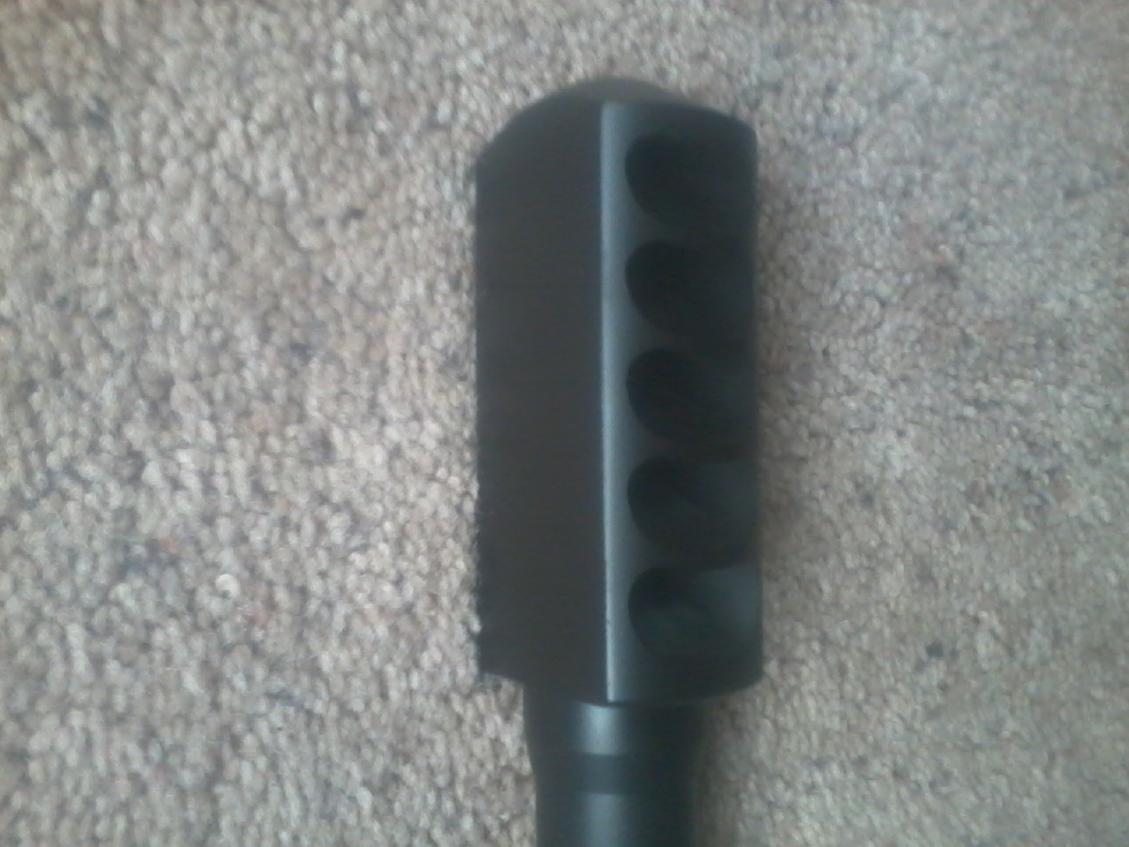

Really, REALLY like that pain killer brake. Was thinking fat bastard for my 338 build but worried it wouldn't reduce recoil enough. That one looks like its ready to take on a 50cal!

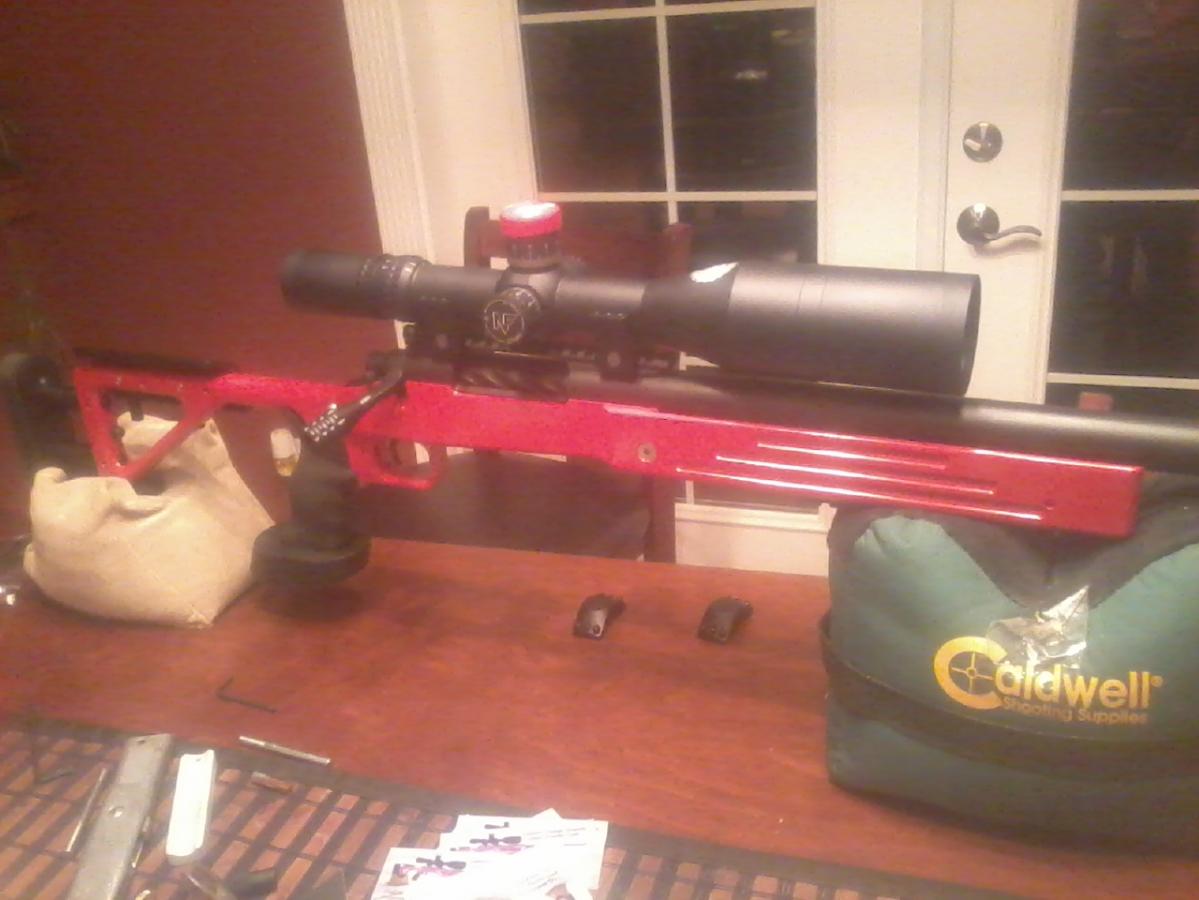

Looks good man. Mine is about a month from completion. I like that you went with an unusual color
really looks like competion orange from the old muscle car days. i am more than happy with it. 3 guy's from the range today only stopped to see what the hell it was.lol
ya the brake was overkill but this thing kicks like a 223 now. i have shot a 338 edge with a fatbastard brake and i would have used one but was already going over the top with this build so i thought what the heck. kirby says the brake is rated for 130g an up. im gonna be low 90's. it's about the size of a pack of cigarettes.lol
