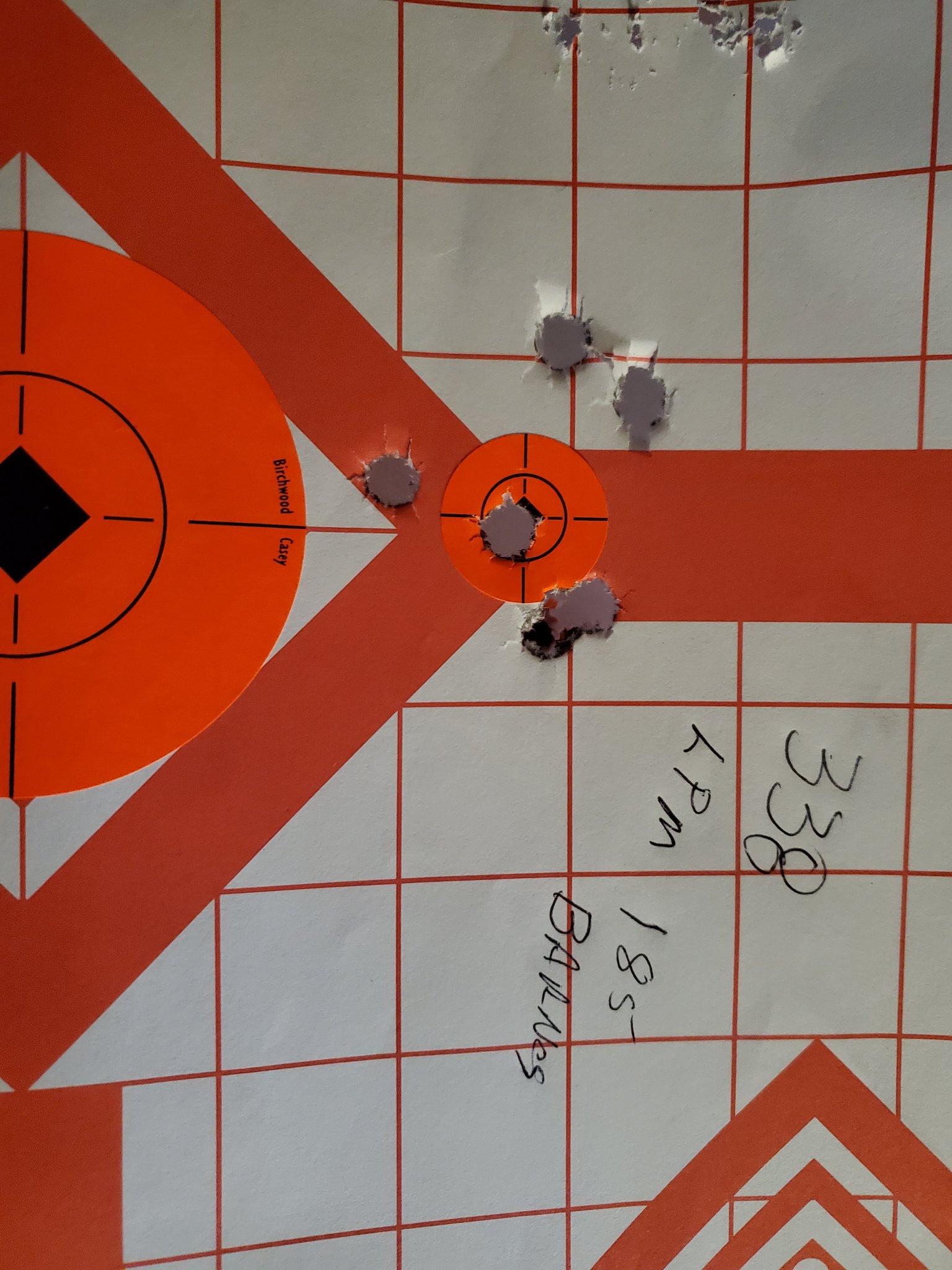

Ramshot Magnum powder works fantastic in my 338 Lapua , 210's , 185's and I just tried the 160's!!! This works amazingly fast and extremely accurate!!! This is a 160 Barnes with 116.2 of Ramshot Magnum powder!! 104 yards !
So missing high by almost 3 inches is good? Cold bore shot? What is your velocity? How about a 10 round group...
Reactions: GS-62
Zeroing it , I set it 2-3/4" high because I am going Elk Hunting!!!

You set it to purposely be 2 3/4" inches high at 100 yards because you are going elk hunting???
Do you know the POI difference for the distances you may actually shoot an elk at from setting it dead on at 100 yards?
Why such an "odd" amount difference? Why not even 2" or even 3"?? But an exact 2 3/4"???

I will not be using 160 for Elk,, White Tail only!!! The 210's is my Elk cartridge!!! I do appreciate the input!!
