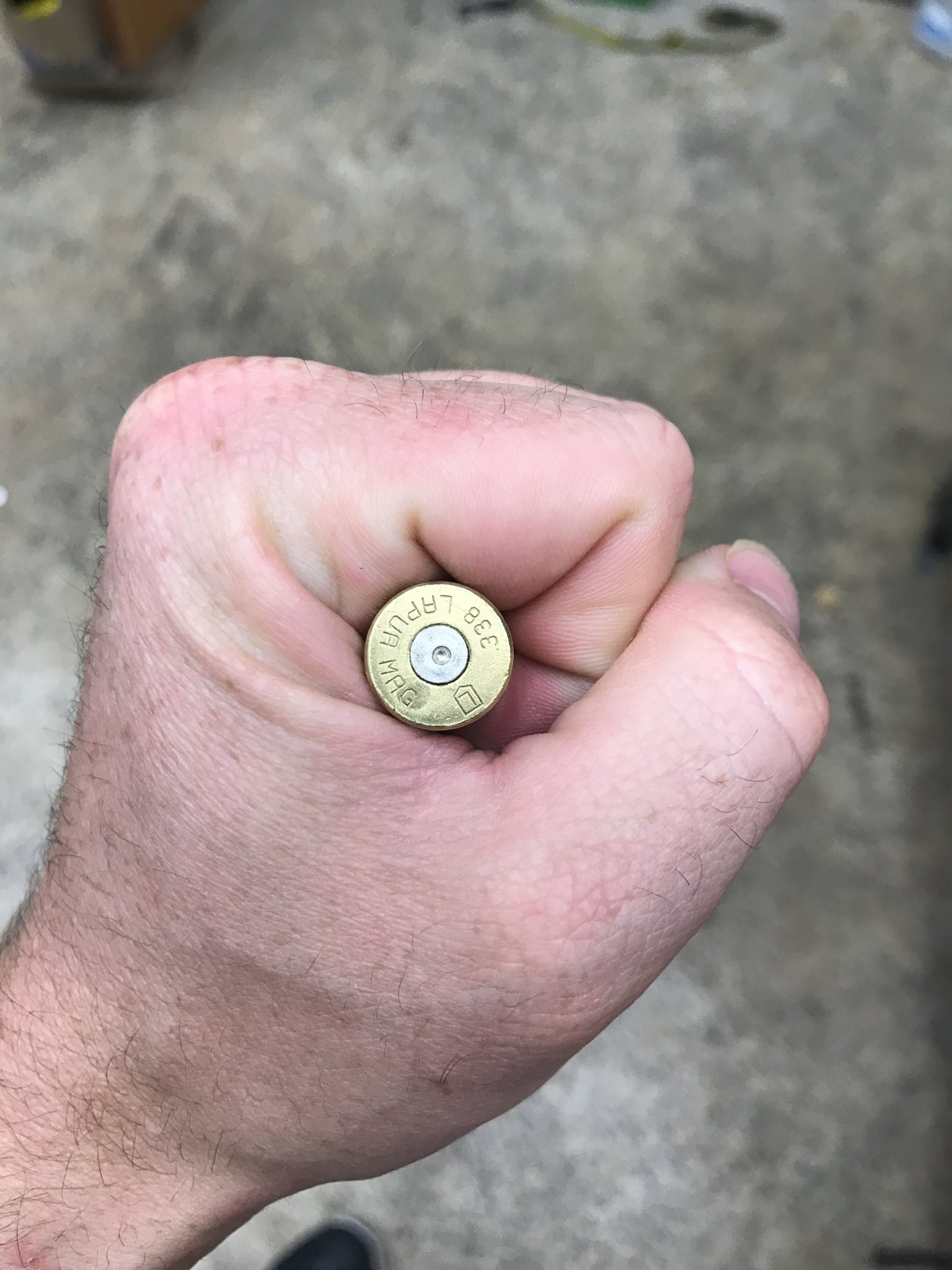

    Pics of the highest hand loaded case.
    7108806
    7108807

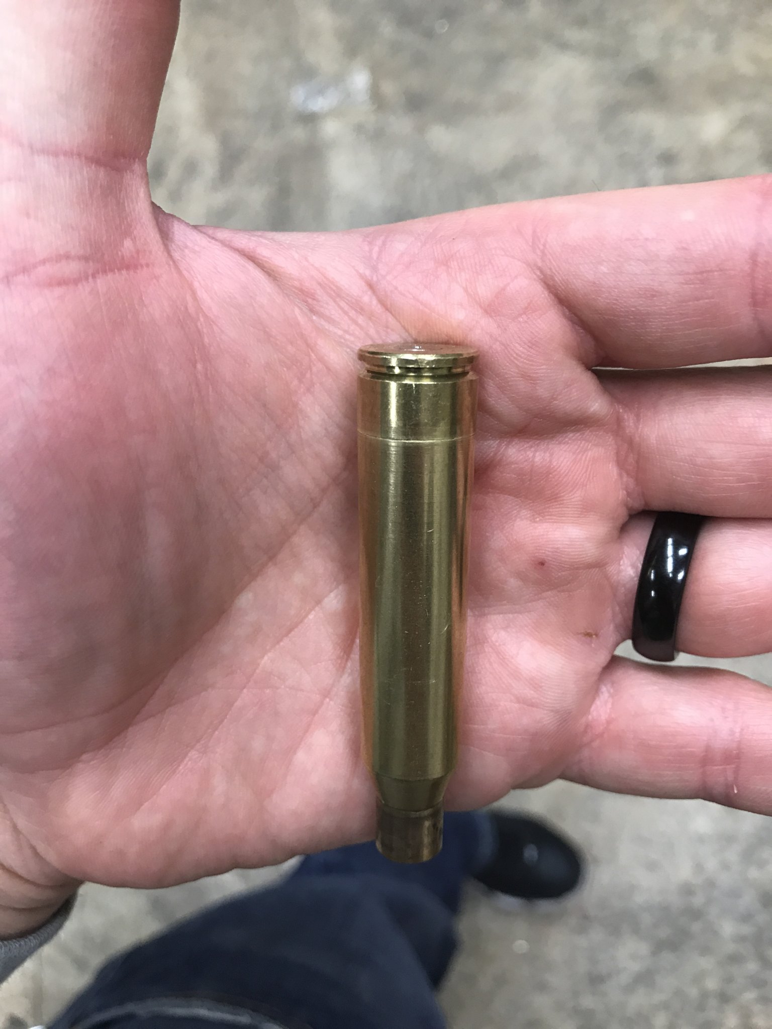

    I understand if I did that every time it’d severely decrease brass life but doing it once ever shouldn’t lead to case head separation unless I’ve got an excess of headspace. If a person follows the instructions on the die it shouldn’t cause a KB.
    7108895
    I did some more measuring this morning. New lapua brass measures about 2.265 on my comparator. Somehow putting my body die on the shell holder is way over sizing the brass. I’m gonna try again with my new brass. I’ve got about 400 pieces of this once fired brass sized like this. About half of it is 8 thou longer so maybe salvageable after fire forming with some light loads

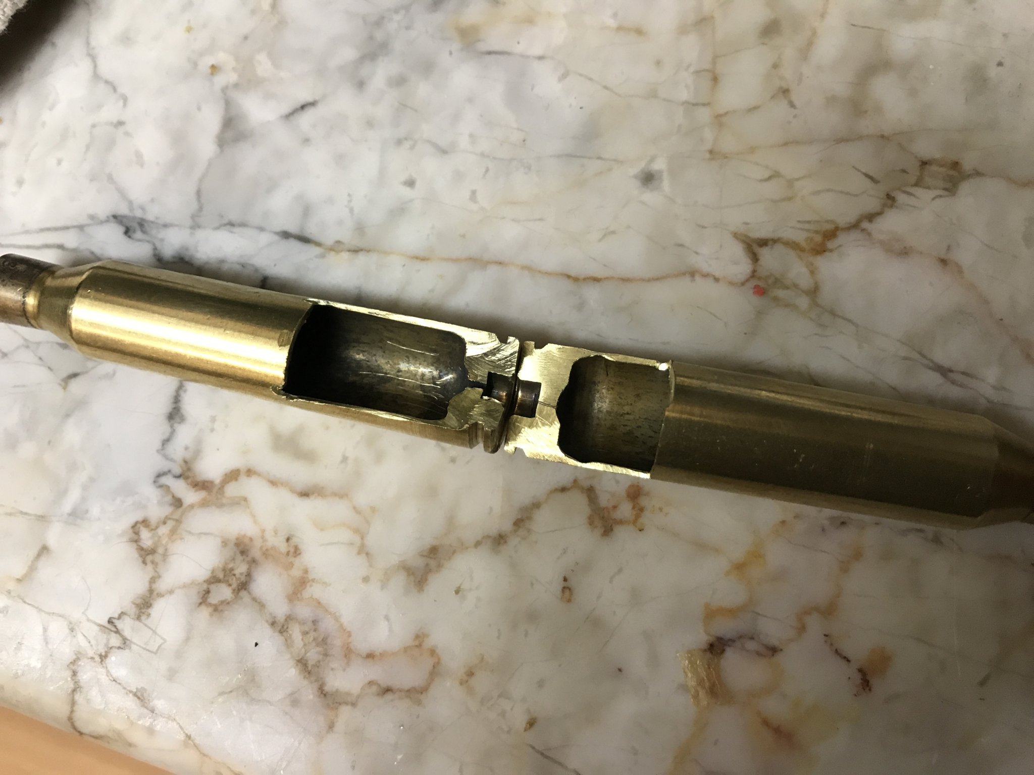

    I sectioned the highest and lowest load. No sign that I can see or feel of incipient case head separation on the light loads. I’ll load some more up to test. If that goes well I’ll have a few hundred rounds of trigger time if nothing else.
    7109323
