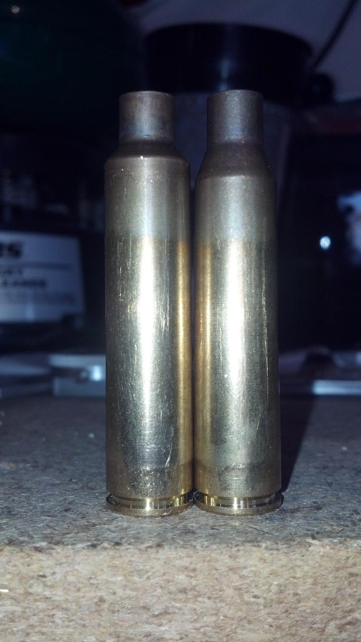

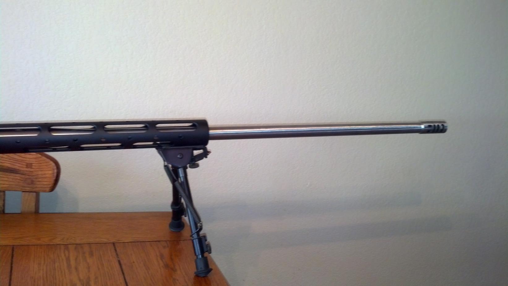

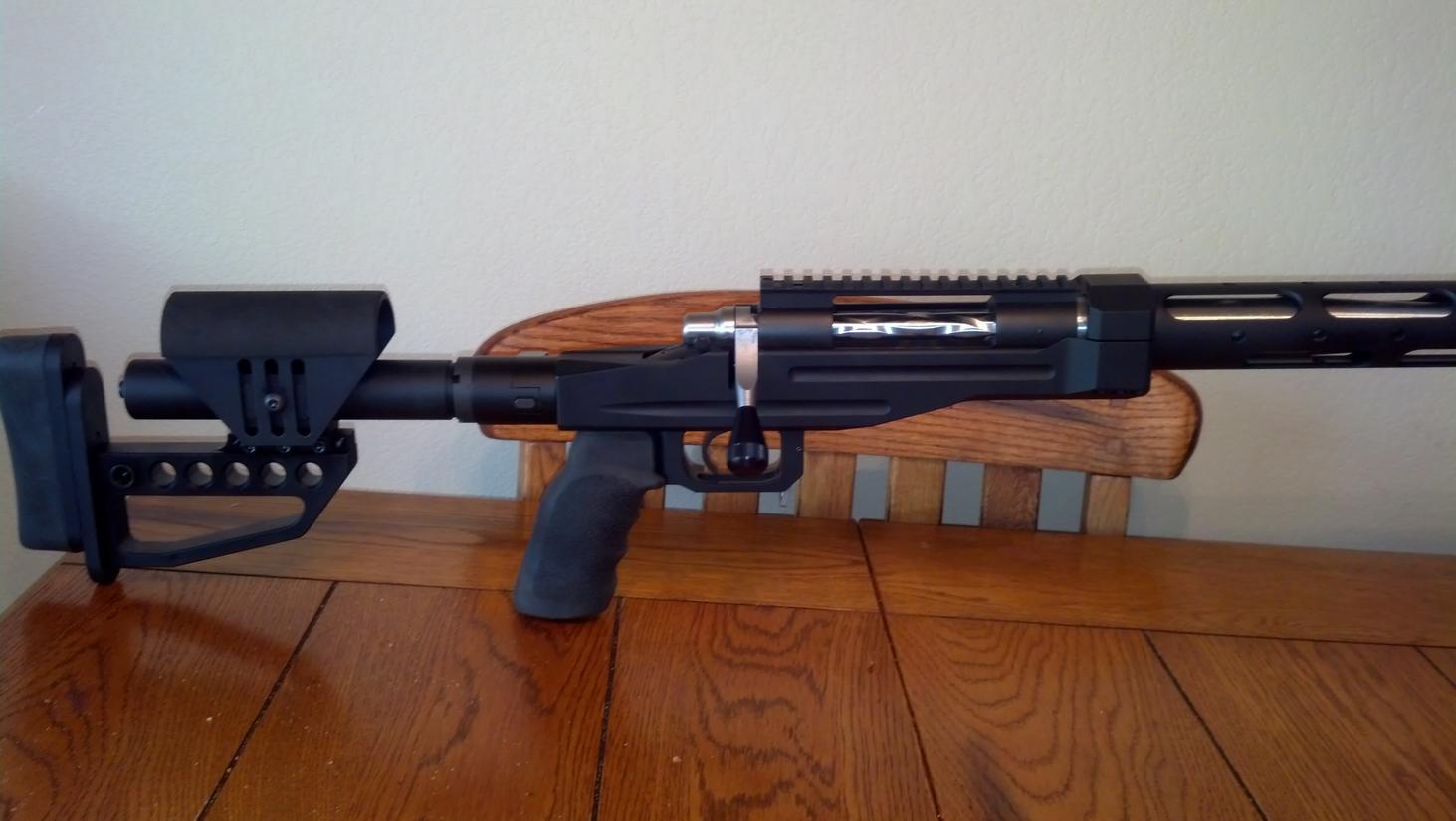

I just finished building a 338 Lapua 40 degree shoulder. Im looking for some load data. Has anyone built one before. I built mine on a 32" broughton barrel. Remington 700 action. On an XLR stock. I am going to run 300 gr. SMK's. I think maybe Retumbo, N570 or RL 33 powder.

SAAMI spec on the 338LM shoulder is a cone of angle 39°59'48", which for all practical purposes is 40°. Are you saying you built one with a 80° cone section? If so, I'll bite: what are you expecting to gain out of that 'cept another grain or two of powder capacity?

There was smith out this way building quite few of those. The goal was higher velocity specifically with the 300gr bullets and pro-longed case life as the .338 Lapua brass isn't the cheapest out there. Next time I bump into him I'll ask what the velocities he was getting and how many loadings out of the brass.

Decided to try out RL33 with some hunting VLD's. Been using 98.7gr Retumbo with 300smk from 30" getting 2920fps but with pressure signs.
RL33 102gr
berger 300gr hunting VLD
3.844" OAL with .025" jump to lands
CCI lg rifle mag
ave 2943 with SD of 4
4 rounds touching at 100yds

Seems like all of these rifles are performing about the same. And getting great results. Anyone else have any feeding issues. I have improved mine. But its still not Silky Smooth.
Never will be smooth with the 40* shoulder. 3000 FPS is all you can get out of that case. Brass will live longer at 2925-2950 FPS and probably shoot better.
Reactions: pengilly
Rigmaster10:
Have you had any issues other than you early feeding issues with the 700 Action? I was in the middle of a 9.53 Saturn build when several people suggested that I would be pushing the Remington Action too hard. I stopped the project for a bit, but now I am having second thoughts. How many rounds do you have through you rifle? The accuracy sounds insane.
There were some feeding issues in the beginning. But with some mag work and polishing feeds fine now. And as far as pressure its a matter of pressure x area x mass formula. Actual force on the action has not changed. Yes there is more recoil compared to a standard Lapua mag based on the amount of powder burned. Just look at things in terms of a piston. Going to 375 in the same mass of bullet will exert far more force on the action than a smaller diameter bullet of the same mass.
