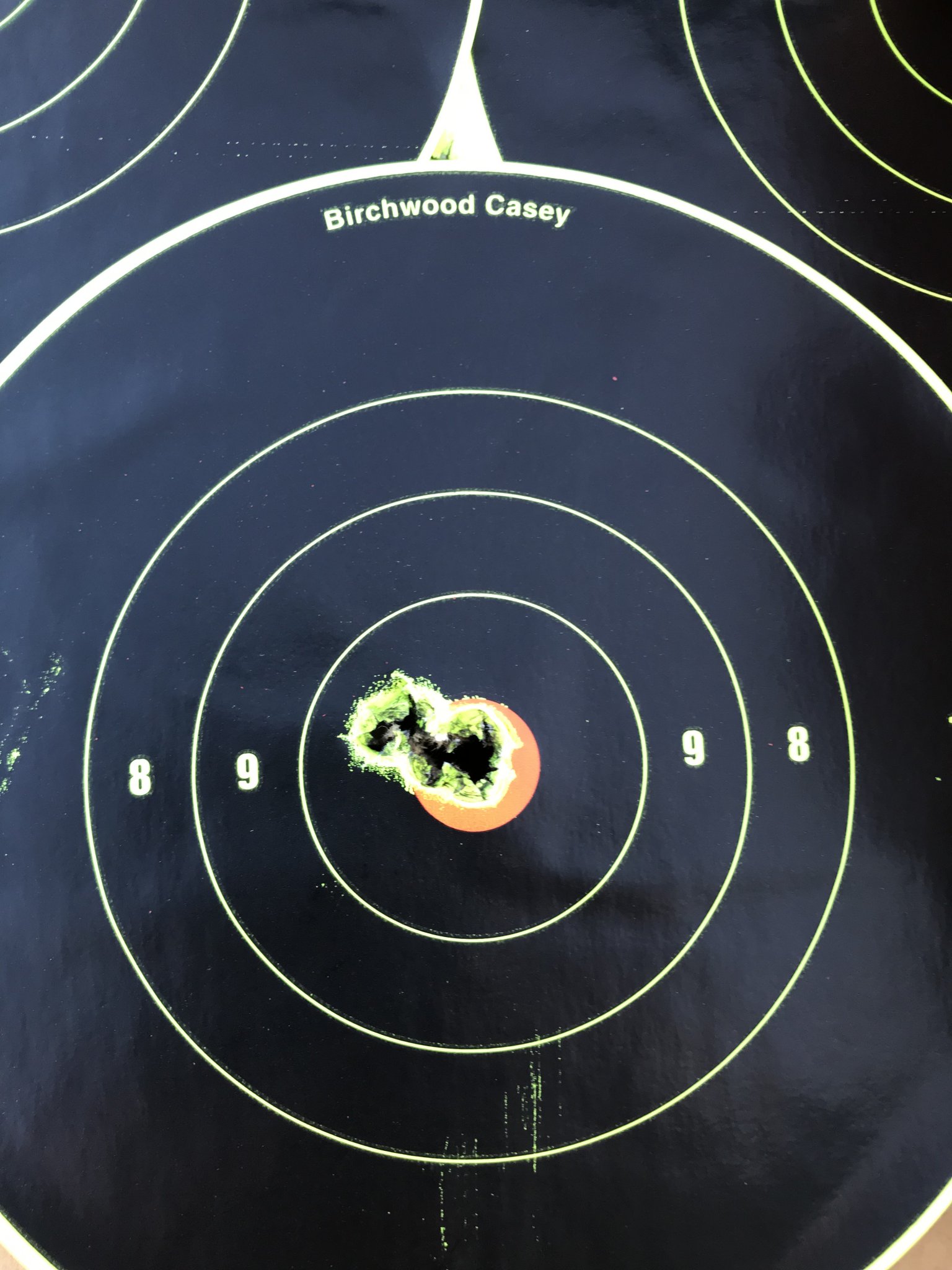

Since you have a 338LM barrel I'd go that route. Here's a 5-shot group of what my 338LM AXMC is capable of:
If you decide to part with your 338LM barrel pm me ?
