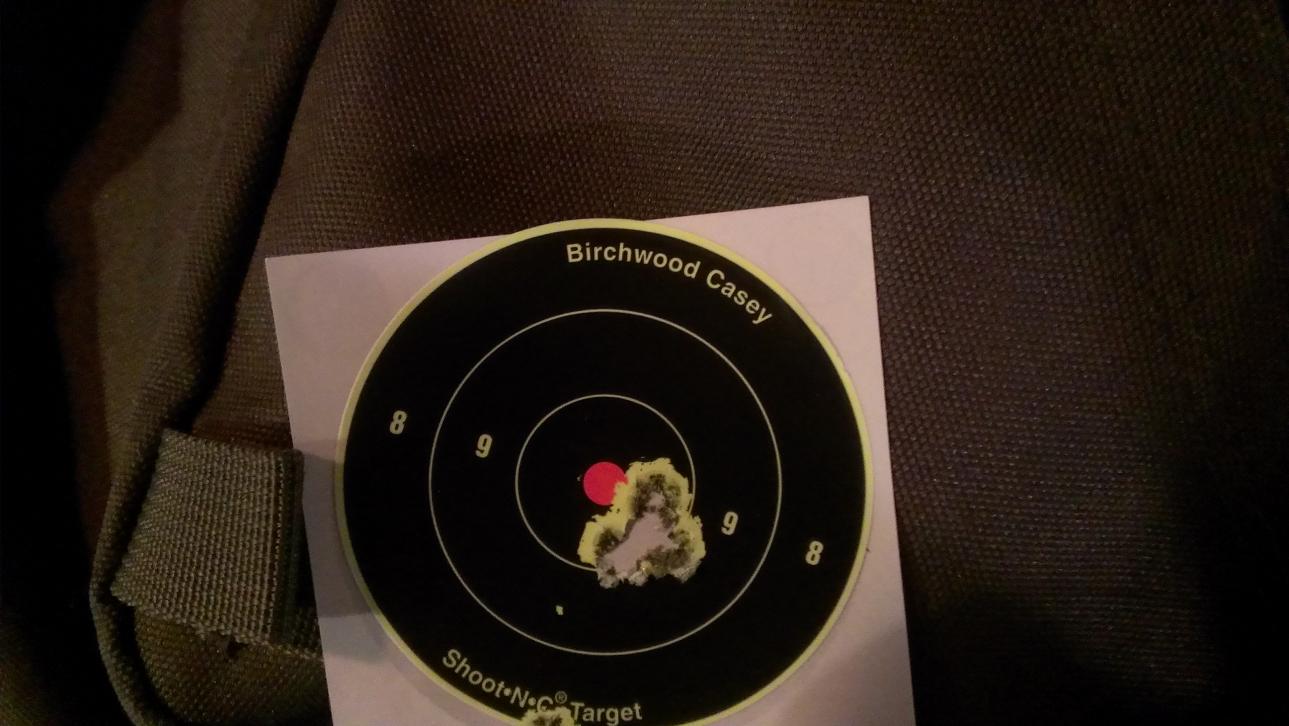

Well I got to do a little shooting this afternoon. I have to say I am very happy with R33. I shot 20 rounds of 338 with the last 5 using the R33.
The load was 93 grains R33
Fed 215m primer
lapua brass with 7 reloads on them
I used the length I always load too because it works in my gun 3.674
2609 was my low
2621 was my high
I got a nice pattern until I pulled the last shot which is the low one.
Fed 215m primer
2609 was my low
2621 was my high
Robp5t
Good shooting, I am also good at pulling the last shot ;)
