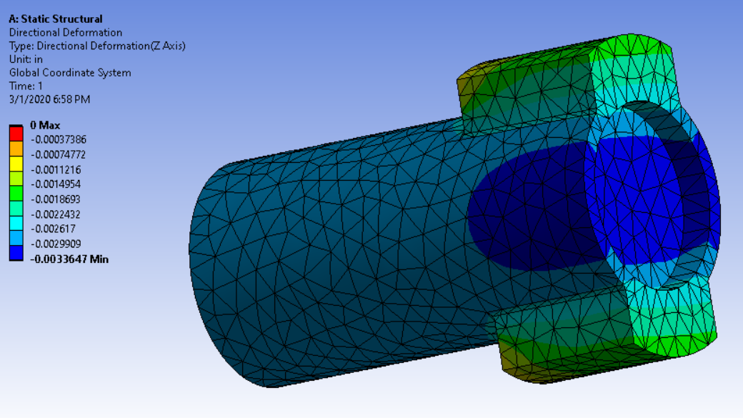

Hi guys and gals I'm new to this forum but have been reading it for awhile now this subject is curious to me because I see a lot of people saying that a rem 700 can't handle the 338 LM but I haven't seen any one show any FEA done to see what it's limits would be. So I made a simple model in solidworks and then ran it through Ansys with a load of 15000lbf on the bolt face to simulate a really hot load and for material properties I used 4340 at 35 rockwell c scale and this is some of the results.
The displacement which is bolt flex and that is about 3 thousands of an inch and again this is in a perfect world.

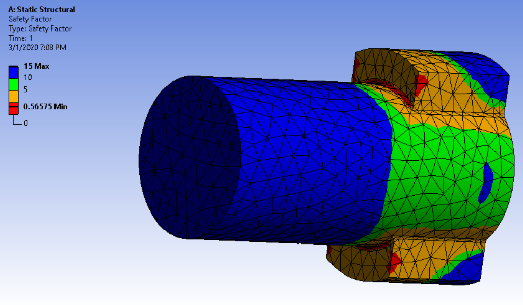

and here you can see the safety factor isn't great it is still fine cause this was done at really high loads.

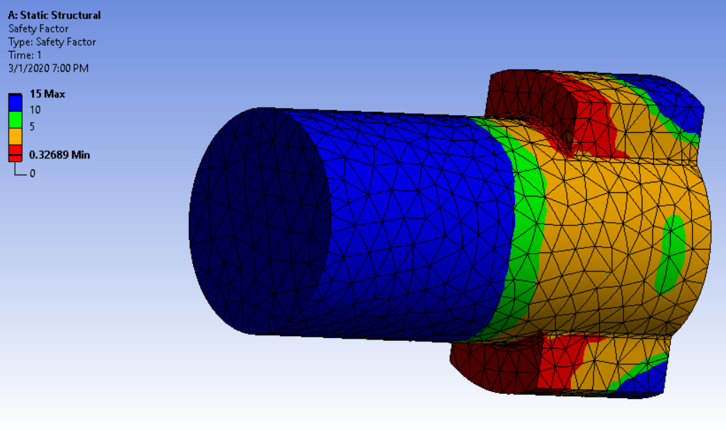

and this is the safety factor of a 308 at about 72000psi. So I would say a rem 700 should be able to handle a 338 LM.
I believe the weak part in the system is the bottom lug in the receiver. If you could make a model of that and run the test like you did on the bolt I would be interested in seeing what those results are.
John
The weak part of the system is the meatbag pulling the trigger. ~15,000 lbf is just the normal 338LM operating pressure. Re-run it with an operator-induced pressure spike e.g. cleaning rod or errant cleaning patch. How does your safety factor look then? Does it work? Yes, until that one mistake occurs where it goes very badly.

By my math bolt face is taking 17650lb @ 65,000psi chamber pressure. Assuming equal distribution of that pressure across the bolt face.
I've never needed to delve into it, but I'm curious how you analyze a dynamic loading situation such as a firing event where you have a variable pressure curve. Everything I've done for school or work so far has been static load conditions.
Also curious what the stress levels reach in the material and fatigue limits.
The way the Ansys runs is by a ramping up the force to maximum but I can set a fatigue test to see what it will look like after so many cycles. when you did your calculation did you use the cartridge base or the inside of the diameter of the cartridge at the base.

I will make the cut outs and rerun it at lets say 25000lbf and see what happens. But these are perfect world numbers so they won't be exactly how the receiver would preform.

I'm not sure how a case head separation would effect the thrust on the bolt it could go up or go down because a drop in pressure as the gas escapes around the bolt head. But when I run the next test I will set it to experience 100,000 psi and see what it looks like. And if I have time I will try to do a version with the bigger bolt size.

It's good to see Mr. Tooley comment on this thread. I was just curious what the bolt would look like from a simple FEA study and it showed under perfect conditions to gain anymore information would require a much more in depth study which I feel unnecessary as it will still only show best estimates of what the is capable of. Real world testing is the only true way to find the capabilities of the action. That said can you build a 338 LM on a rem 700 yes it is possible but I think an action that has been beef up to handle the higher load would be a better option for a carriage of this size. As far as the defiance vs surgeon XL the defiance will displace more than the surgeon XL as the elastic modulus for steel is pretty much constant among different steels. So the thicker the steel the less it will displace for a given force.
Your measuring the wrong part. See comments I made earlier.
Do you mean measuring wrong as only showing the bolt and not the interior lugs. Cause I ran the simulation with the front part of the receiver and the front part of the bol.t But only showed the bolt. But my receiver lug size could be off a little cause I don't have a receiver that is taken apart to get proper dimension for the lugs. If you have the correct size I would greatly appreciate it.
The issue is the expansion around the circumference of the chamber.
Yes that is one of the issues with using such a large round in the 700 with relative high pressures. the brass will stretch in all directions because of the thinner steel. when I ran the simulation I was just concerned with bolt flex and if there were any stress concentrations on the lugs them them selves. Cause a lot of people were saying the action wasn't strong enough but weren't showing why. the action and barrel can take the pressure but it is far from ideal and I would recommend a larger action cause of increased safety factor and increased brass life.
I'm not really talking about the lugs. I offer you explore what the front ring is doing ahead of them. .140" ish cross section of material with helical grooves (threads) cut into it along with a small gaggle of holes poked into it. (base screw holes, gas check, and front guard screw)
I have some free time coming up so I will try to model the front half of the receiver and barrel connection as accurately as I can and run the sim again this time with pressure to simulate pressure in the case it's self and share what I find.
