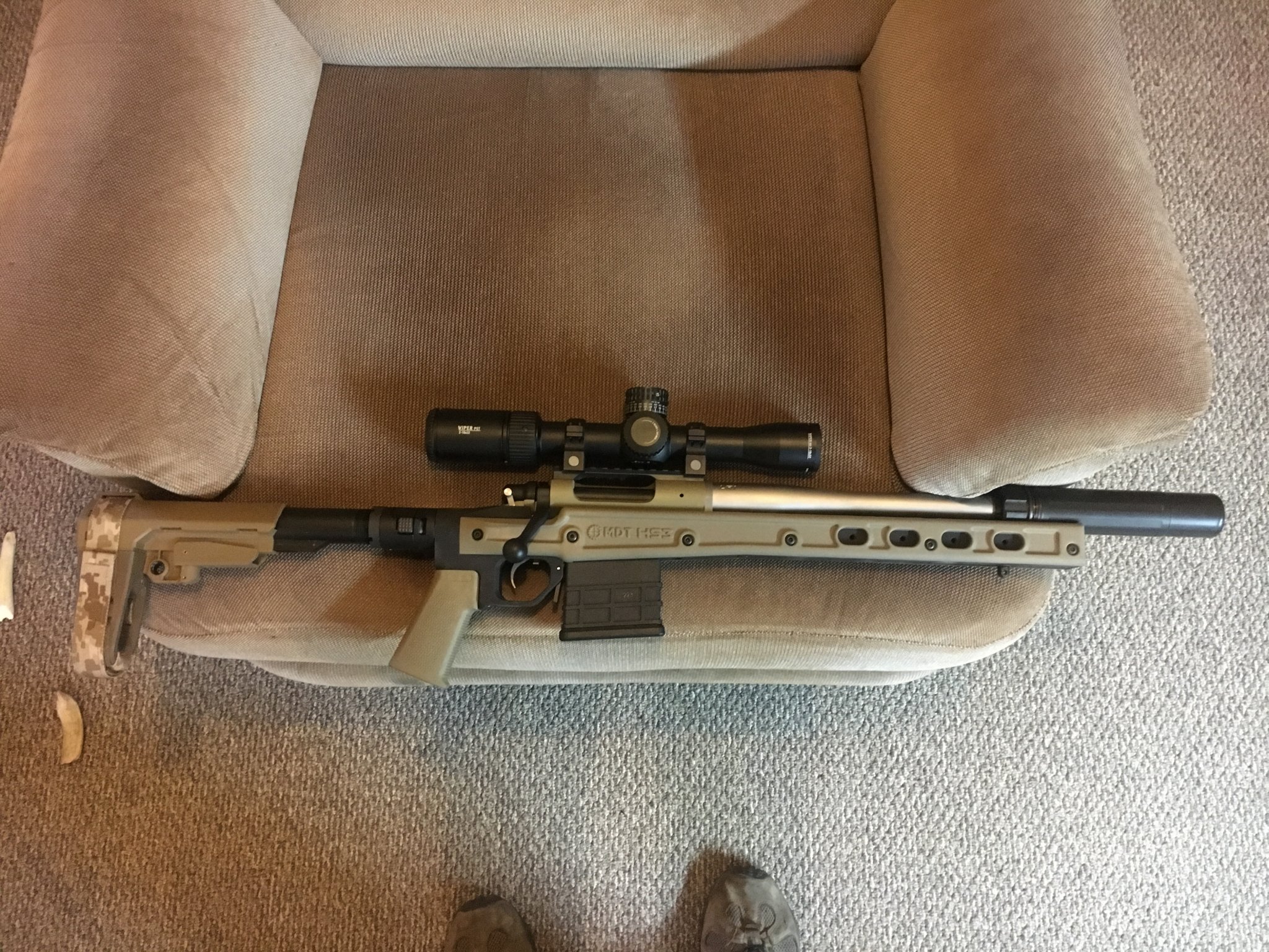

I have a LRI built KraZy Ivan.
Built on a Remington 700 with a 8 twist X-caliber barrel. Quiet with a 9mm can and Hollywood quiet with my Sig 338TI can.
Shooting 300 gr SMK at 1020 FPS.
You should do a “pistol build” with a 11 inch barrel and Pork Sword Chassis ;)
