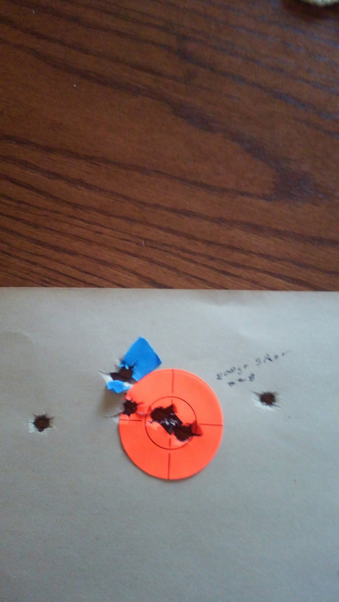

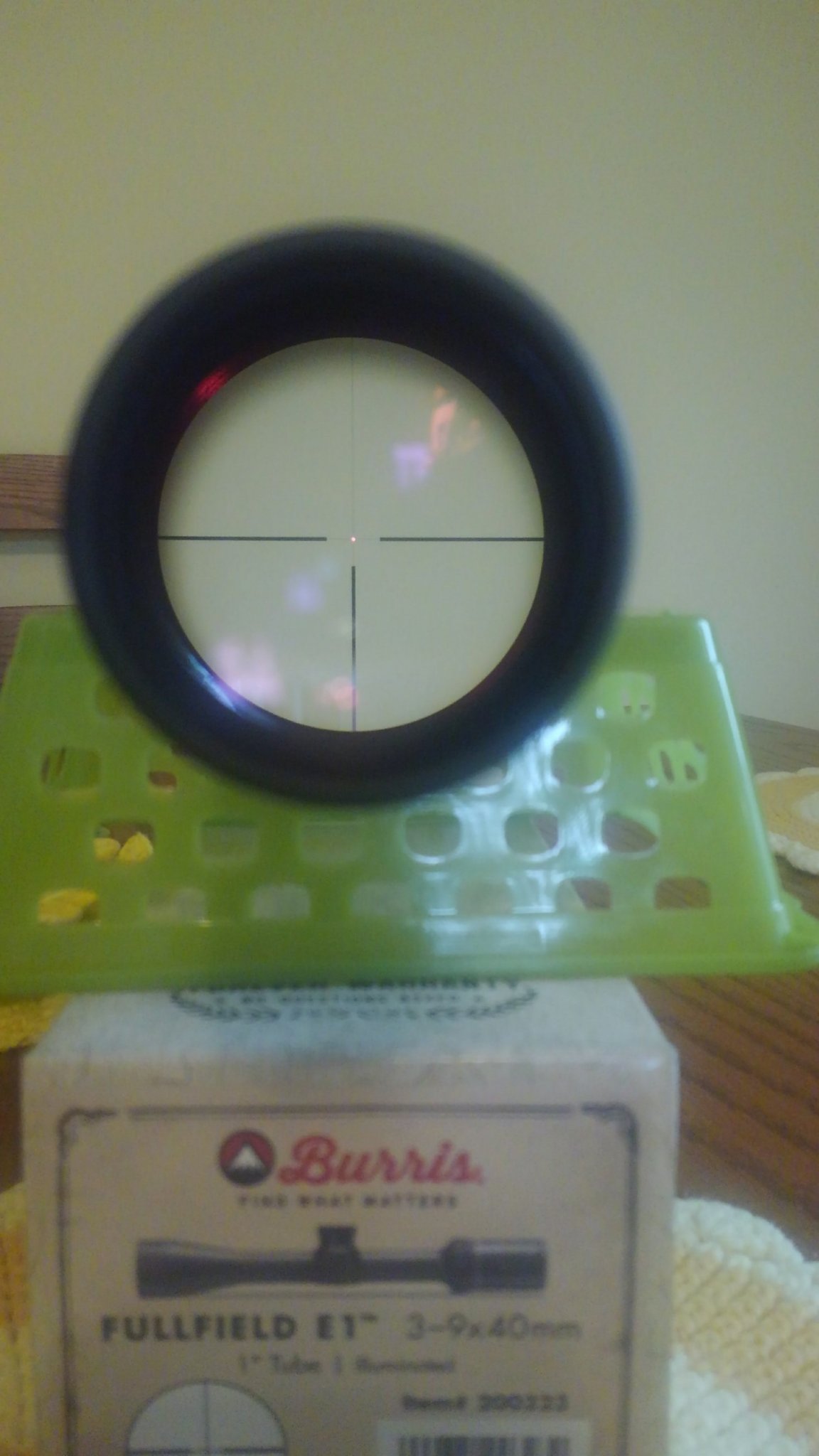

I got the M70 last week and broke it down and cleaned everything , mounted a different scope on it and threw together 10 get me on paper book loads out of the Speer manual. The scope is a Burris E1 with a G4 E-dot
72.0grs of R19 and the 200gr HC seated .015" off. Book says 2592fps out of a 24" barrel. Bore sighted at 25yds and went to 50 to center things up and walked it out to 100yds to tweak it. First shot 3" right at 3 o-clock and and over adjust , #2 landed 3" left at 9 so I split the difference and #3 landed at 11 so I droped down an 1" an #4 was at 9 but close so 1/2" right and the next three landed center.
This is a stock M70 Classic with a stock heavy trigger pull .
Maybe not up to some standards but I'm happy with it since it is a hunting set up and it has room for improvement.
