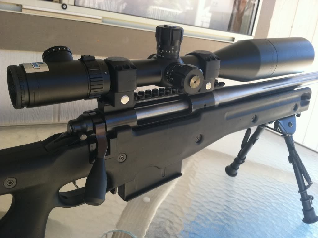

Here is my first semi-custom rifle with the help of Keith at Phoenix Custom Rifles. Still needs to be Cerakoted.
Build specs are:
Remingtom 700 LA (trued: bolt lugs, lug recesses and receiver face by PCR)
Varminter bolt knob (installed by PCR)
Remington .338RUM Sendero take off barrel (set back, chambered and headspaced by PCR)
AICS 1.5 Stock (w/ recoil lug recess opened up for oversized .300 Badger lug by PCR) and 5 round AI .338LM magazine
Ross muzzle brake (installed and timed by PCR)
Base holes opened up to #8-40 (PCR)
TPS steel alloy 20moa base
30mm Chimera rings
Bushnell Tactical Elite 6-24X50 FFP scope
Bone stock Remington trigger (soon to have a Jewell)
Let me know what you think. I'm very proud of it:
[img:center]
[/img]

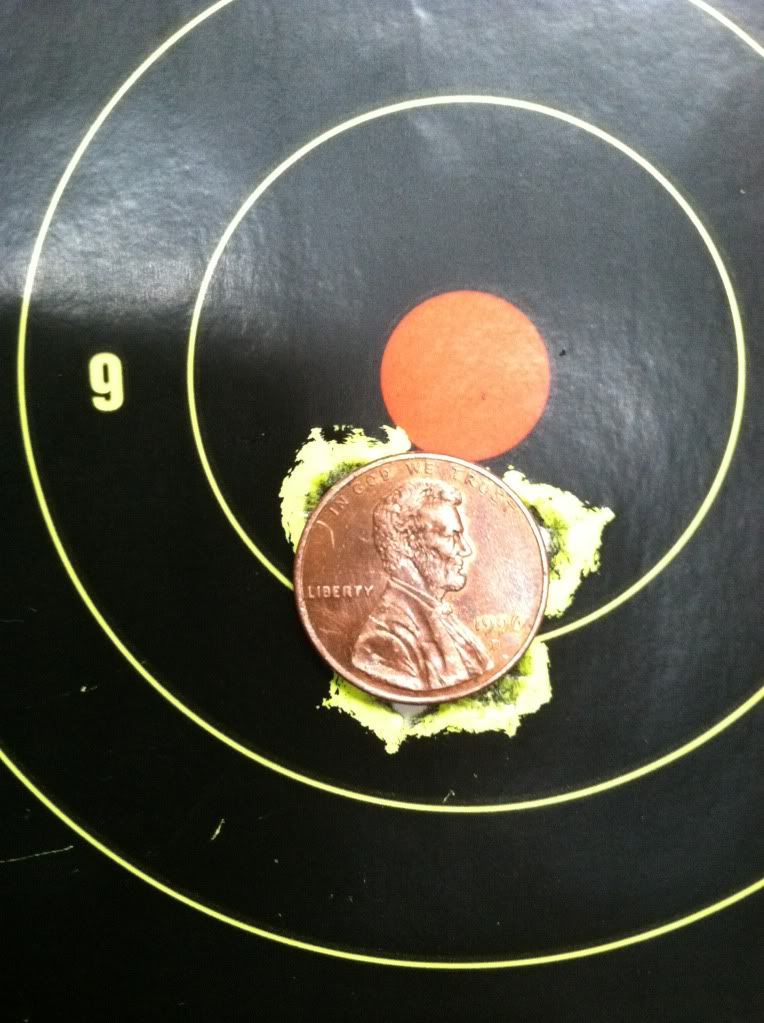

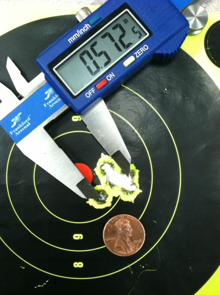

Finally got to shoot it this weekend and here's my best 5 shot 100 yard group during load testing w/ 300 gr. SMK's:
[img:center]
[/img]
[img:center]
[/img]

I really don't have a problem with the trigger. It breaks clean at about 2-3/4 #'s. I may not go that route if I can keep making groups like in the picture. When I stretch it out for long range, it might make a difference. Good luck on your next build. Thanks for the comments.
