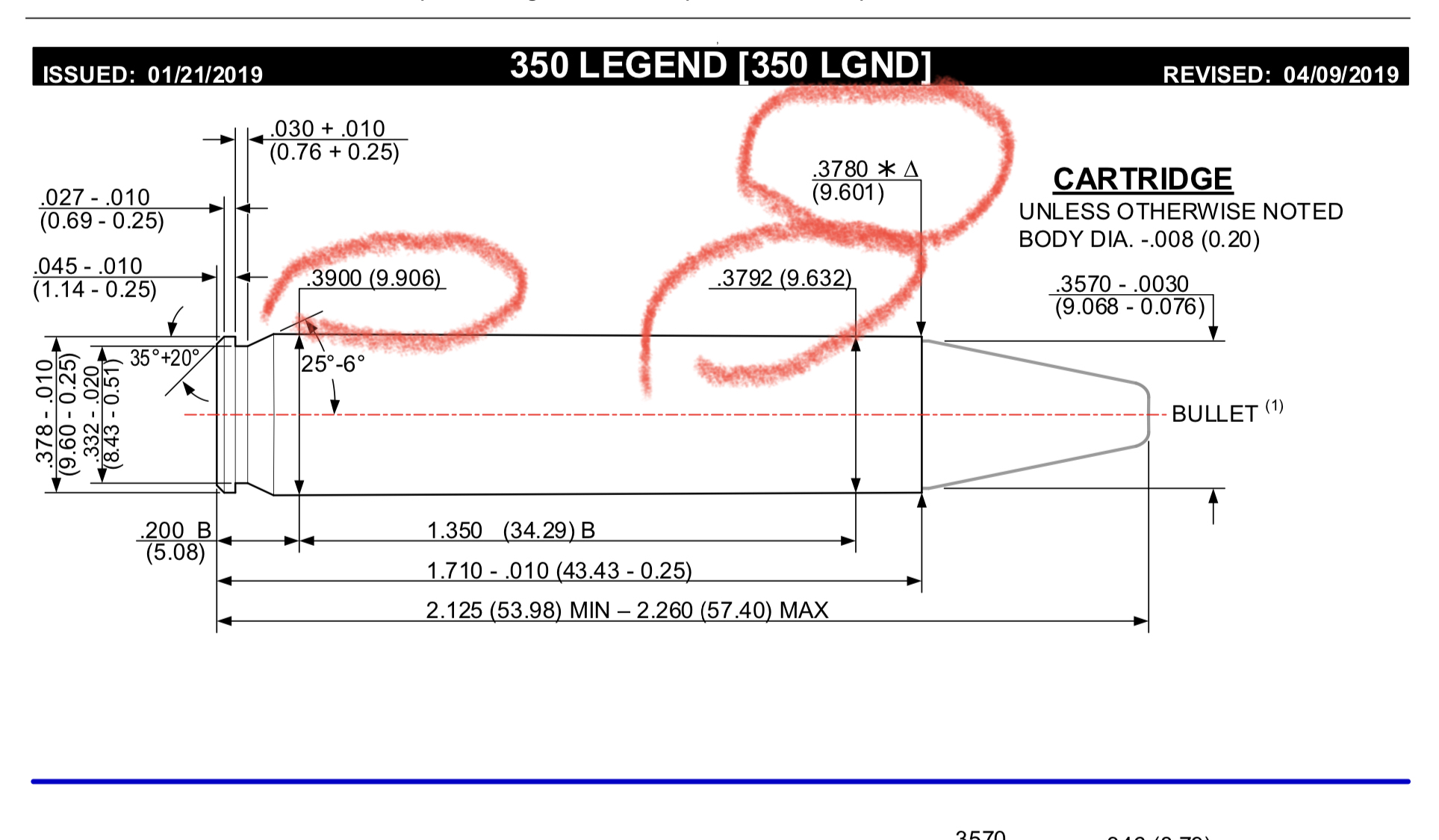

I know that your issue seems to be length related, and it is possible that you have a short chamber. But your comments about the difficulty chamber the very short COAL had me wondering about the dimensions I circled.

I did notice the COAL and in fact the Sammi spec above, likely showing a 147g or similar, shows 2.125” oal. That’s why I’m asking about your finished cartridge diameters as noted in the spec.
Do you have a way to measure those diameters?

I'll try some 147 XTP over the weekend and I'll also measure according to the drawing you posted andd let you know. Hoping to take some chamber / throat pictures as well and maybe some pics of the fired brass so you can let me know if you see any signs of overpressure.

at 0.200 the brass diameter is .385
at 1.55 the brass diameter is .376
I'll color the cartridge with a marker and see where is rubs tomorrow but if my measurements of the cartridge are correct then I definitely have a tighter than spec chamber.
the brass length is 1.703 and the diameter in there is .375; at 1.710 it's just the bullet which measures at .356

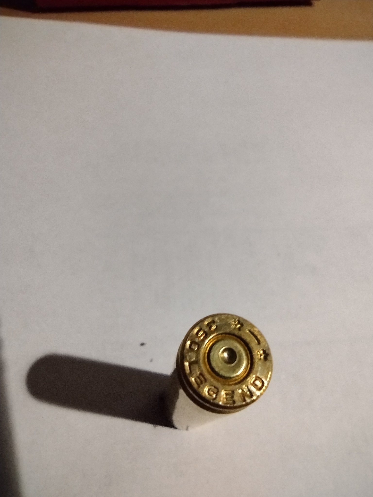

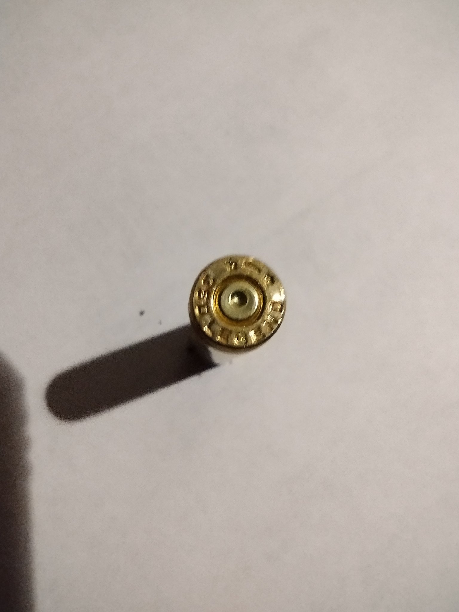

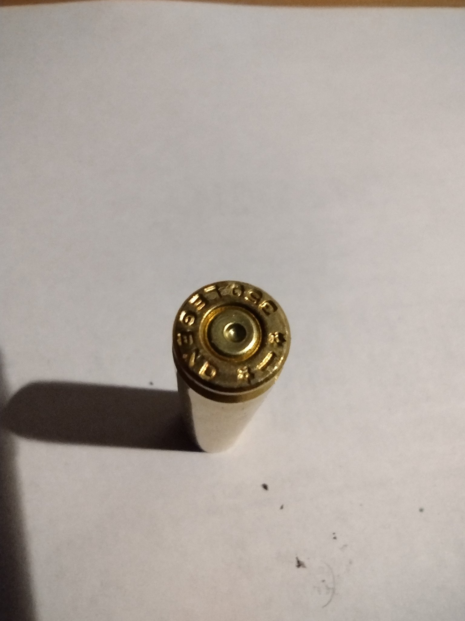

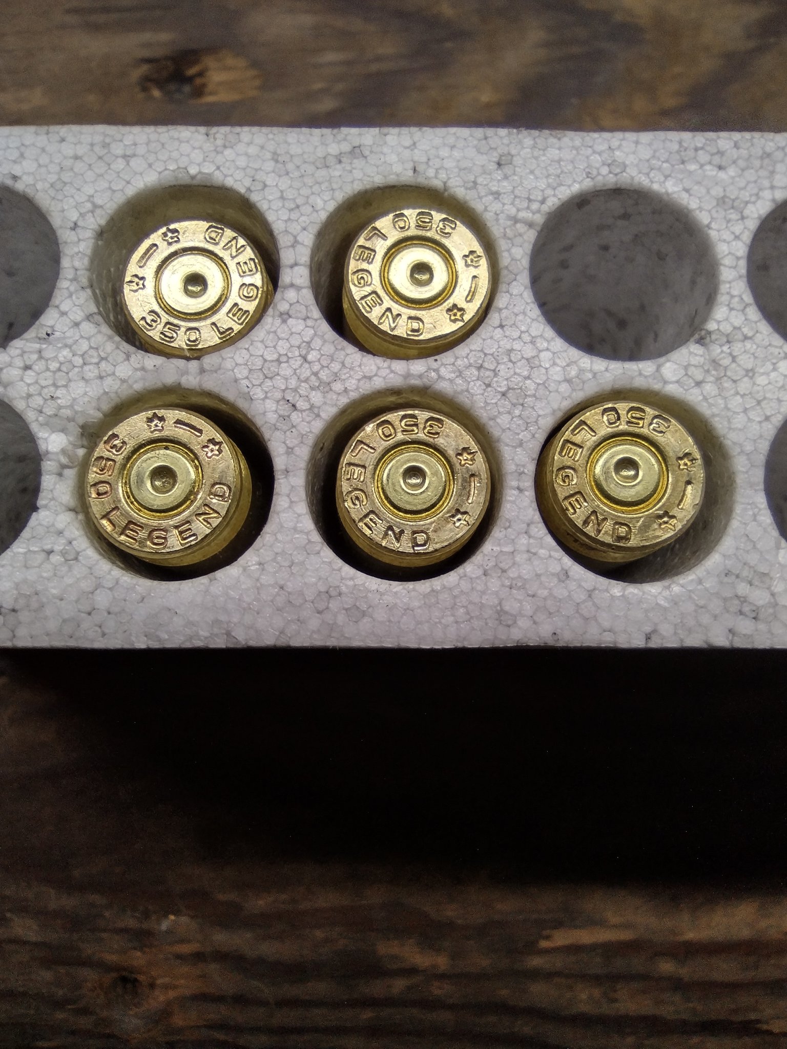

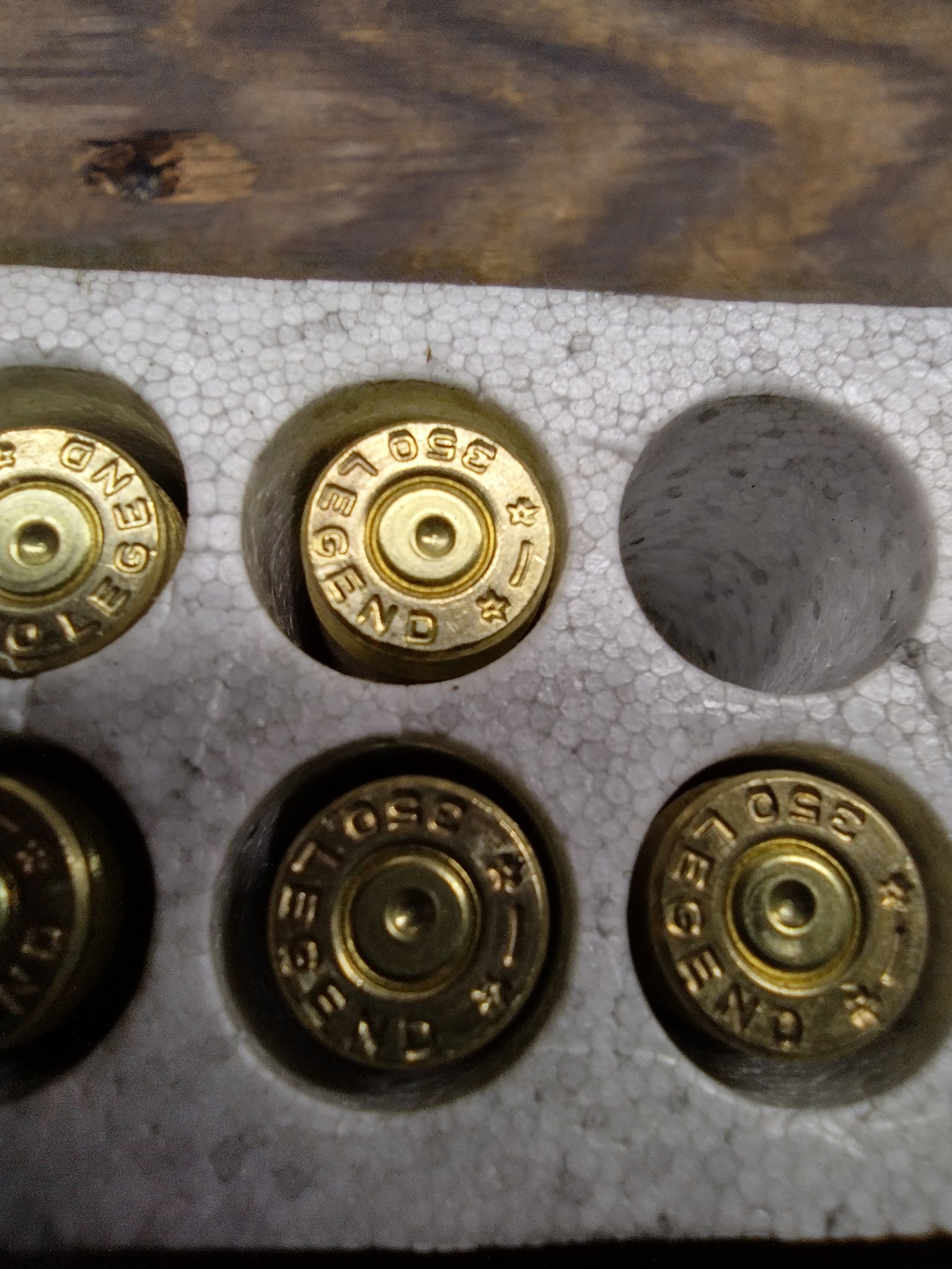

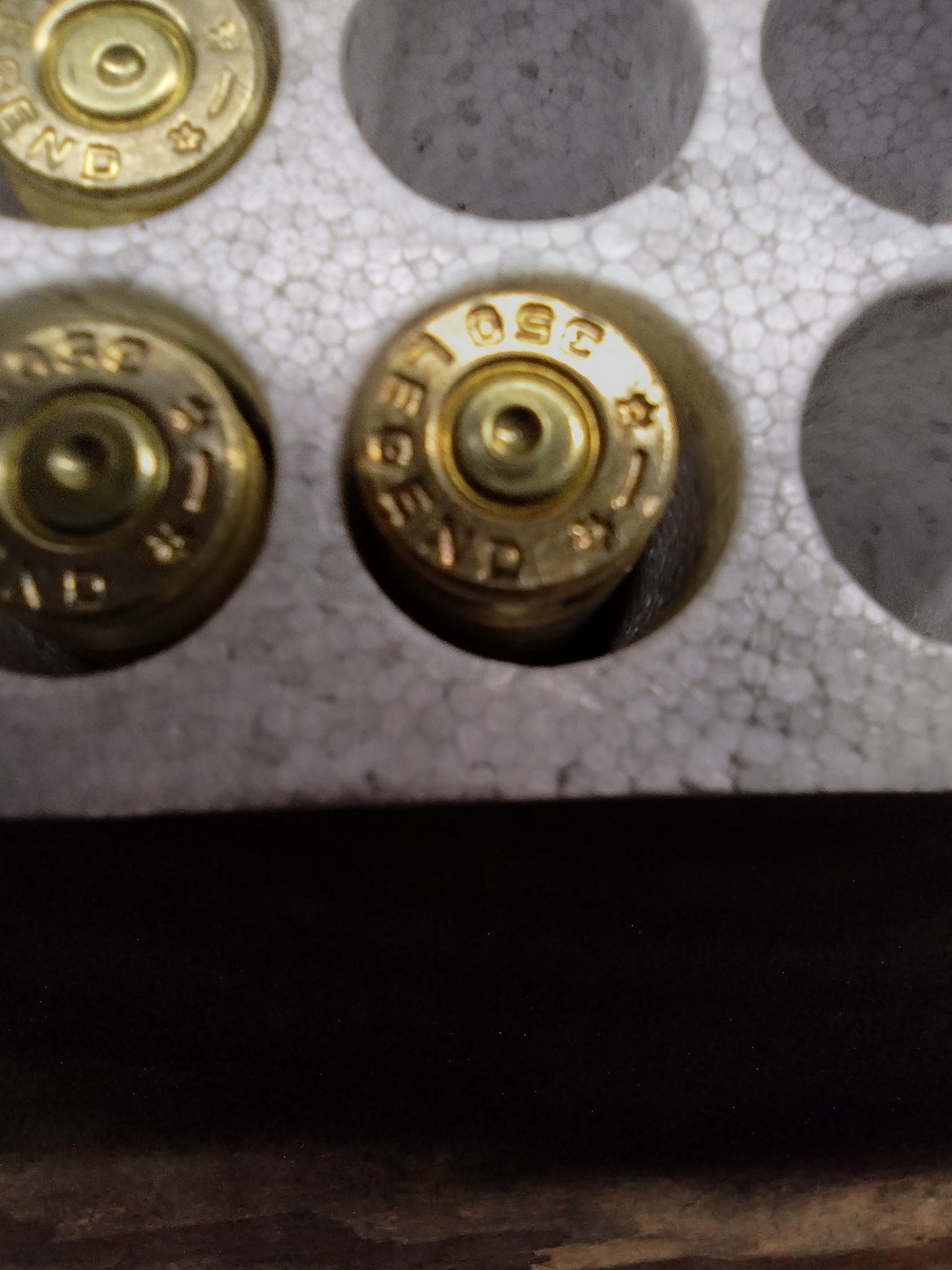

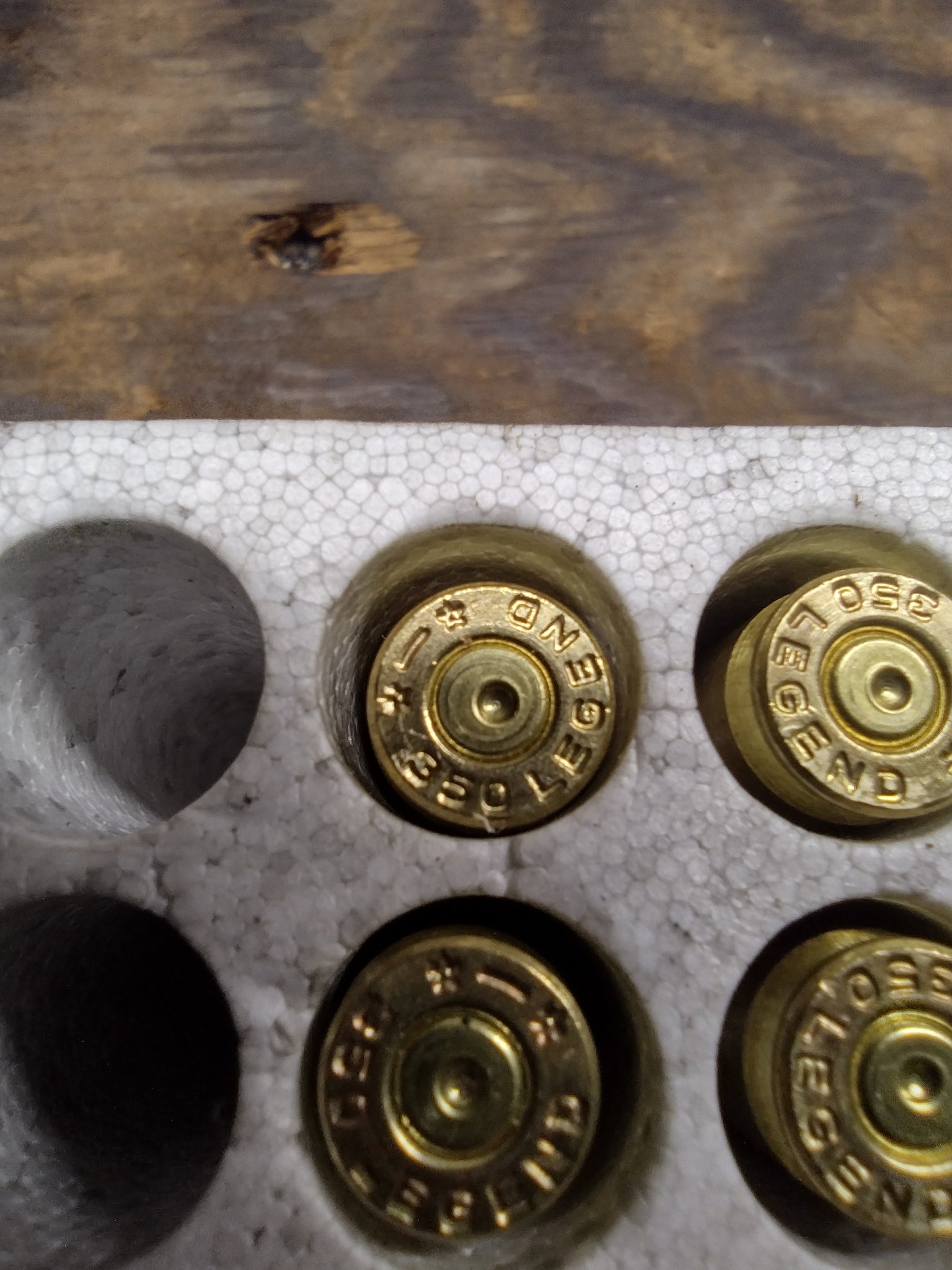

First 6 images are the fired cases, 5 individually and then all 5 together.
Please let me know if you see anything that would lead you to believe they are over pressure.

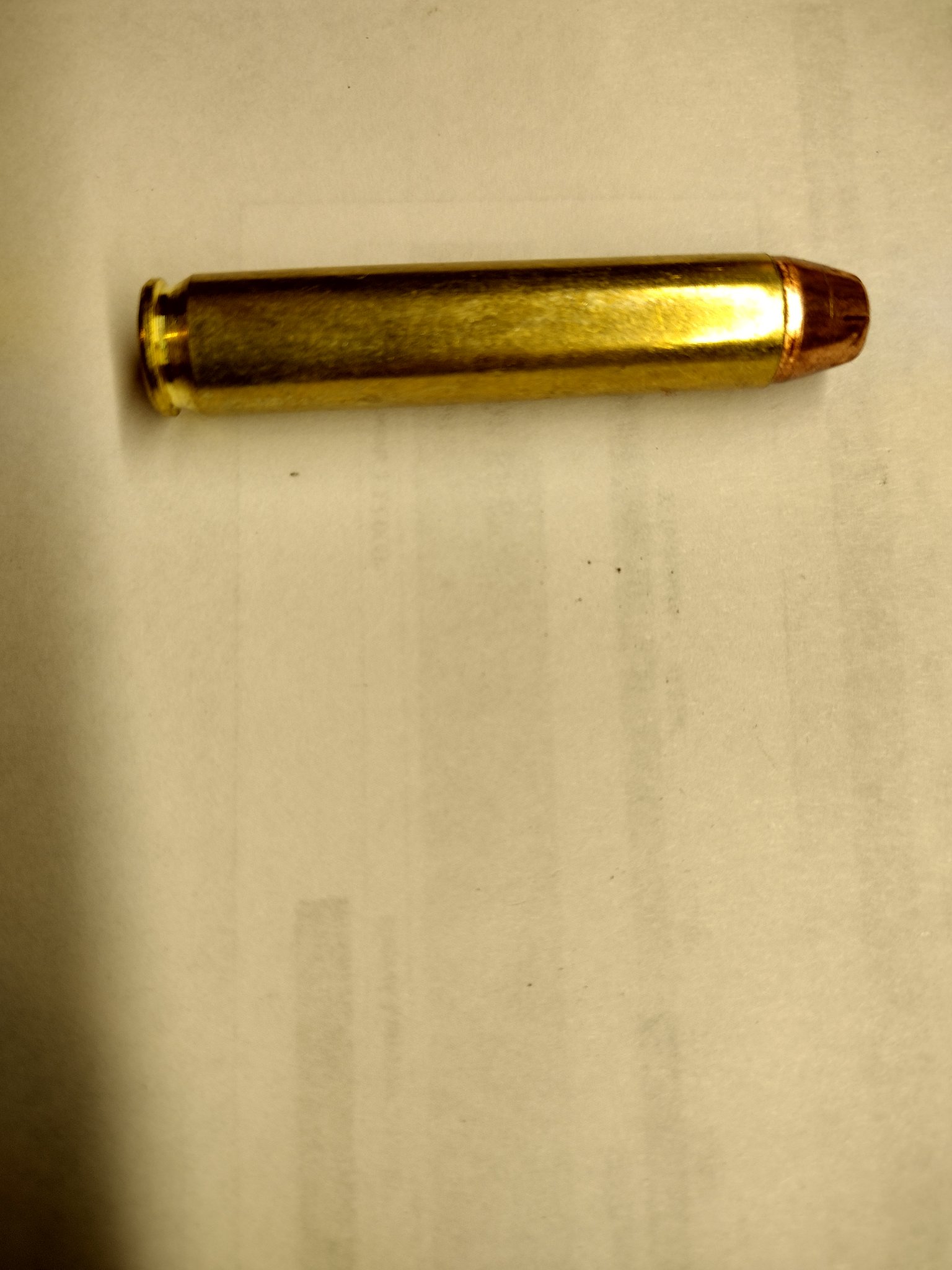

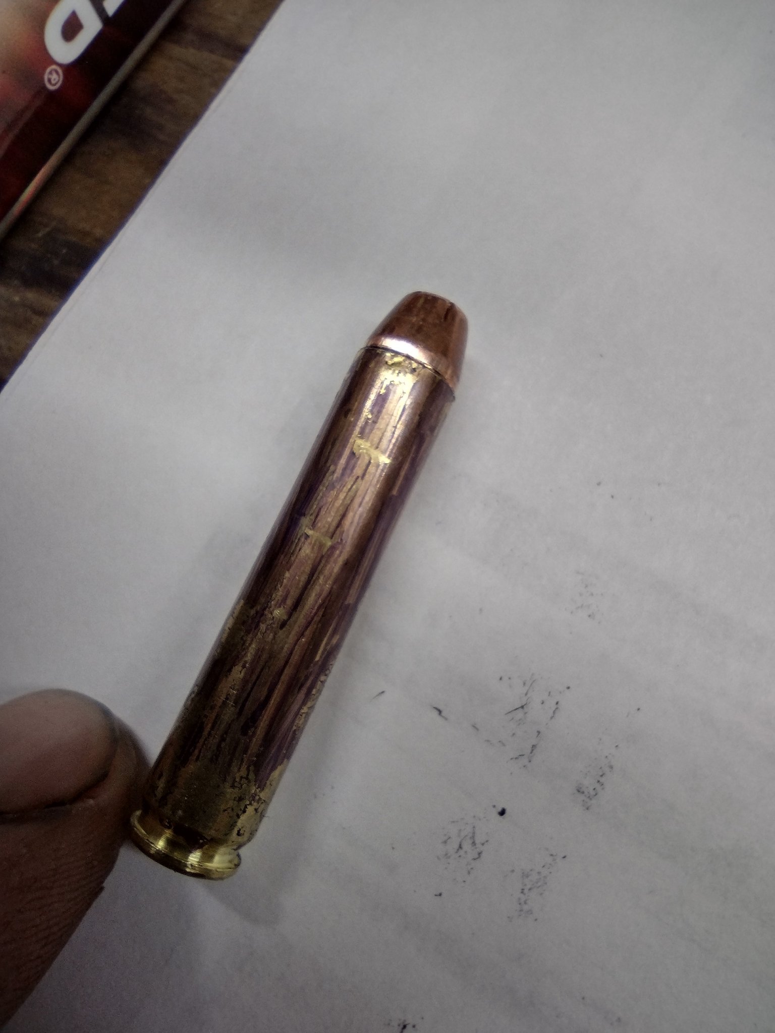

The last 2 pictures are the cartridge as loaded and the spot where it seems to rub on the chamber, feels like that is exactly where the bullet ends.
Not sure it can be seen in these pictures but the bullet shows signs of rubbing on the throat as well.

I think that this pretty much confirms that things are tight in the end of the chamber. Whether or not Savage will think so is the question. If you could swage the bullets down another 0.001-0.002”, it might make the difference you need.
As to pressure signs, I do see ejector marks on the last two. Not a lot, but there are also some primer signs. Again not a lot. To me, this is most likely due to the small diameter of your chamber at the end.
Especially in production rifles, reamers are known to wear. Just a reality of machining.

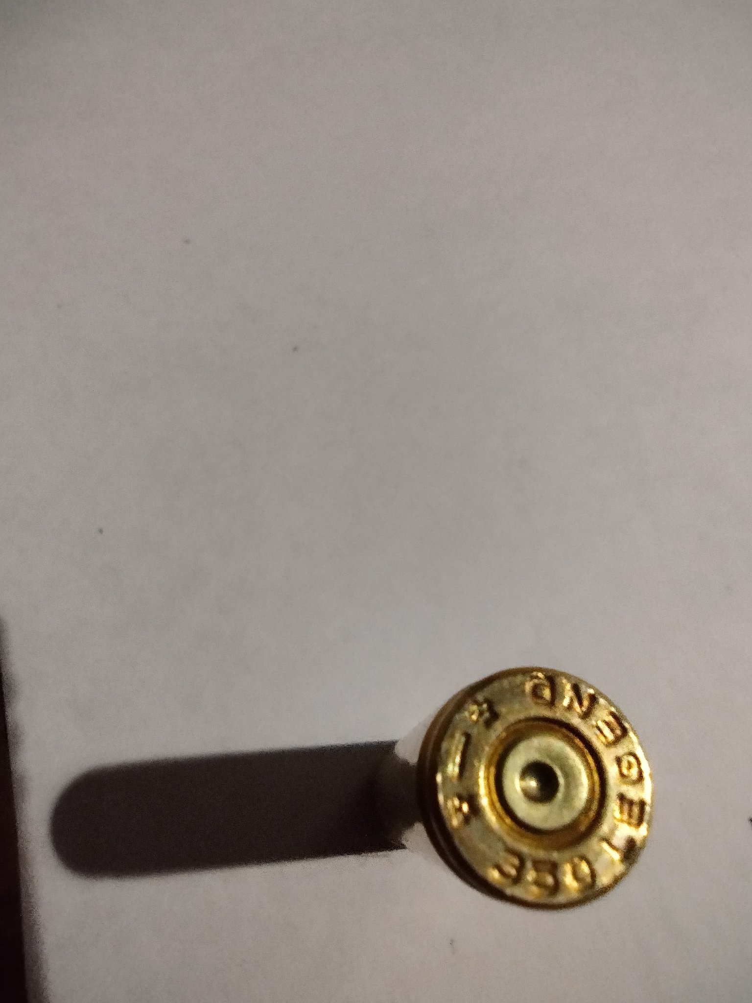

I'll post a picture of the fires case in a few, got to grab my phone. If someone has the time, can you please confirm there are no visible pressure signs?

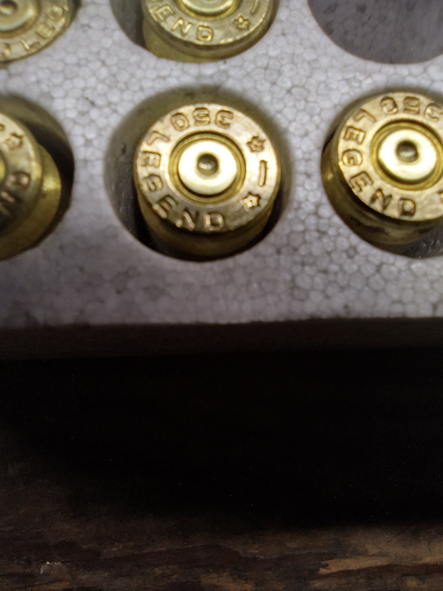

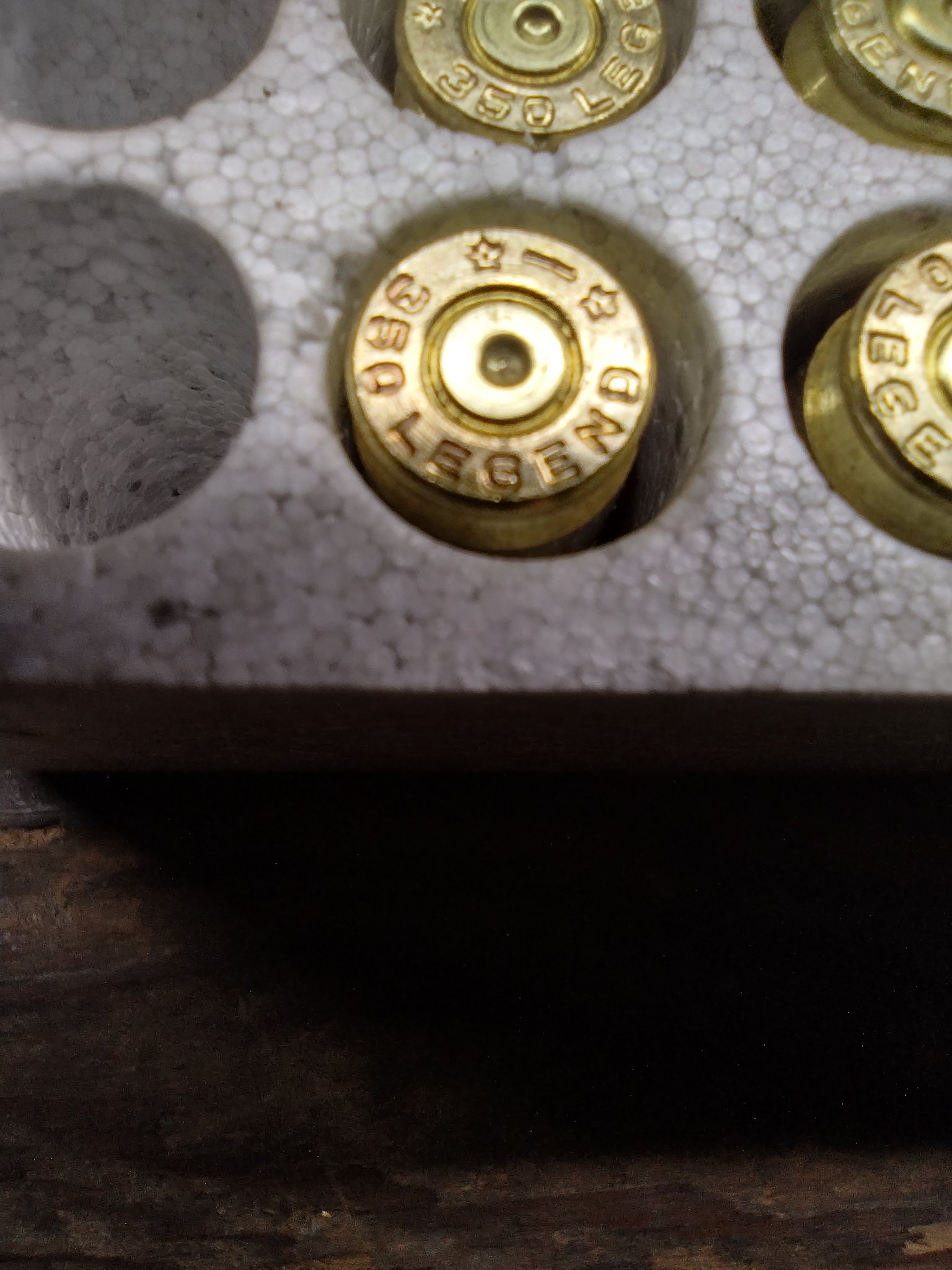

These 4 images are all the same case, just at different angles to make sure the glare doesn't obstruct any of the image.
At least to me, the primer looks not as flat, not as cratered and I can't see an ejector mark. Maybe I'm just overly optimistic.
