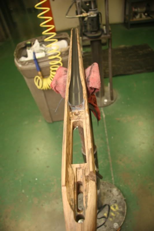

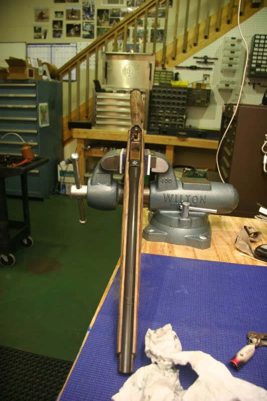

This ones going to be pretty detailed. I've got two to build for the trip to Africa. This is number 1 and is well on its way.

Better barrel harmonics by fully bedding- rather than free-floating- the barrel?
Re: 375 H&H Mannlicher project
There are a lot of secrets to working with Mannlichers. That one is bedded in the forend to seal it. However the barrel is done in a manner that it can move like an M1A and come back to the same point. If you bed the entire channel and just let it ride it will shoot like total crap.

Honestly when you get to that many hours you start counting by the week. Each bedding job took roughly a week to complete alone.

Beautiful work Jered! That stock and work on the muzzle/front sight area is amazing. Can I trouble you for a closeup of the rear sight and your QD rings?
Very nice. Are the quarter rib, front sight, nose piece, and mounts your's or from outside? Also did you do the checkering?
Regardless, it is very nicely made up with exceptional visual balance. Beautiful work.
