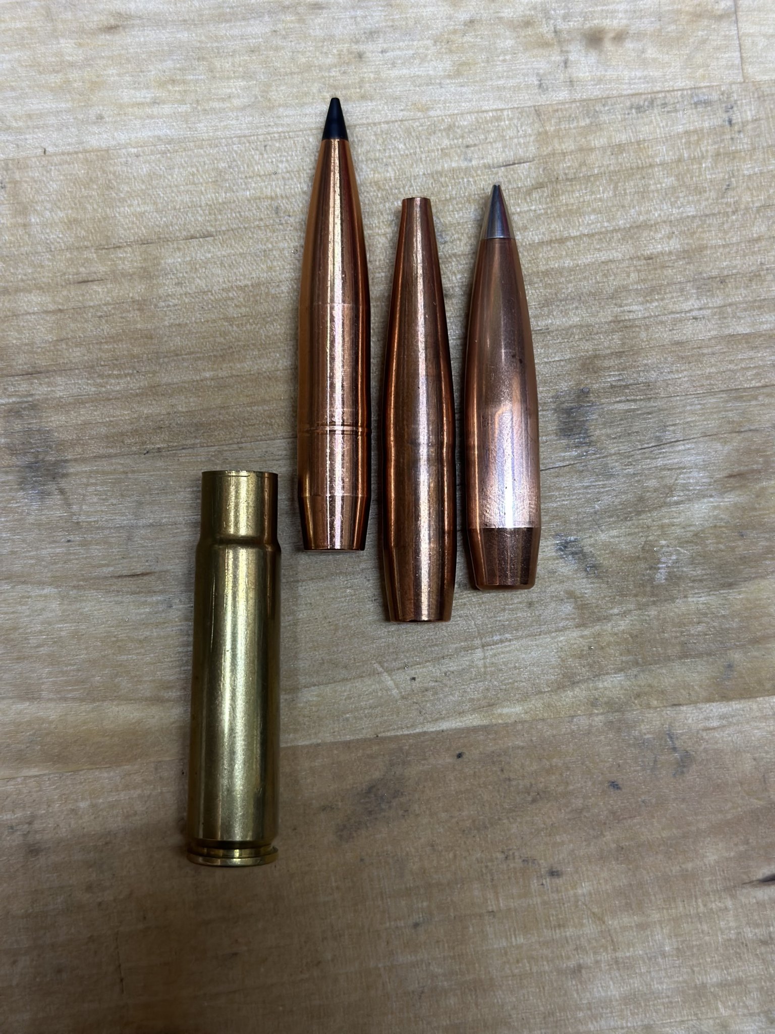

I noticed that. It should give me a place to start on my 270gr Speers, which are the cheapest bullet I have.
The Maker, Peregrine, and Accubond may take some figuring.
Speaking of bullets, I have some other ones I am keeping an eye on.
Lehigh 185gr CC. Intended for the 375 socom, I think, but one reviewer used them in 375 raptor.
Cutting edge maximus 250gr.
Hammer makes some lighter weight 375 cal bullets, too.
Oh and some speer 235s for plinking.
I still like the Maker design the most. I think I would like the petals to stay attached.

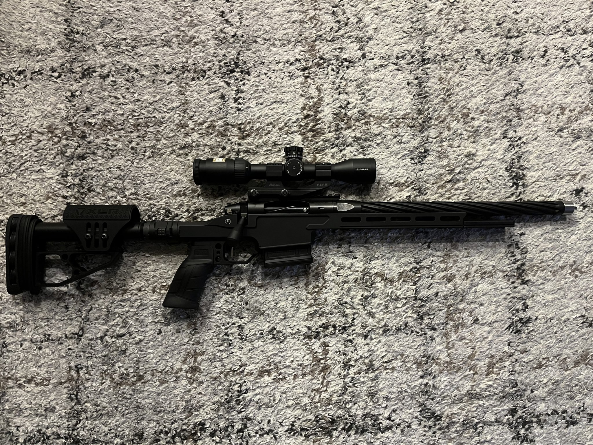

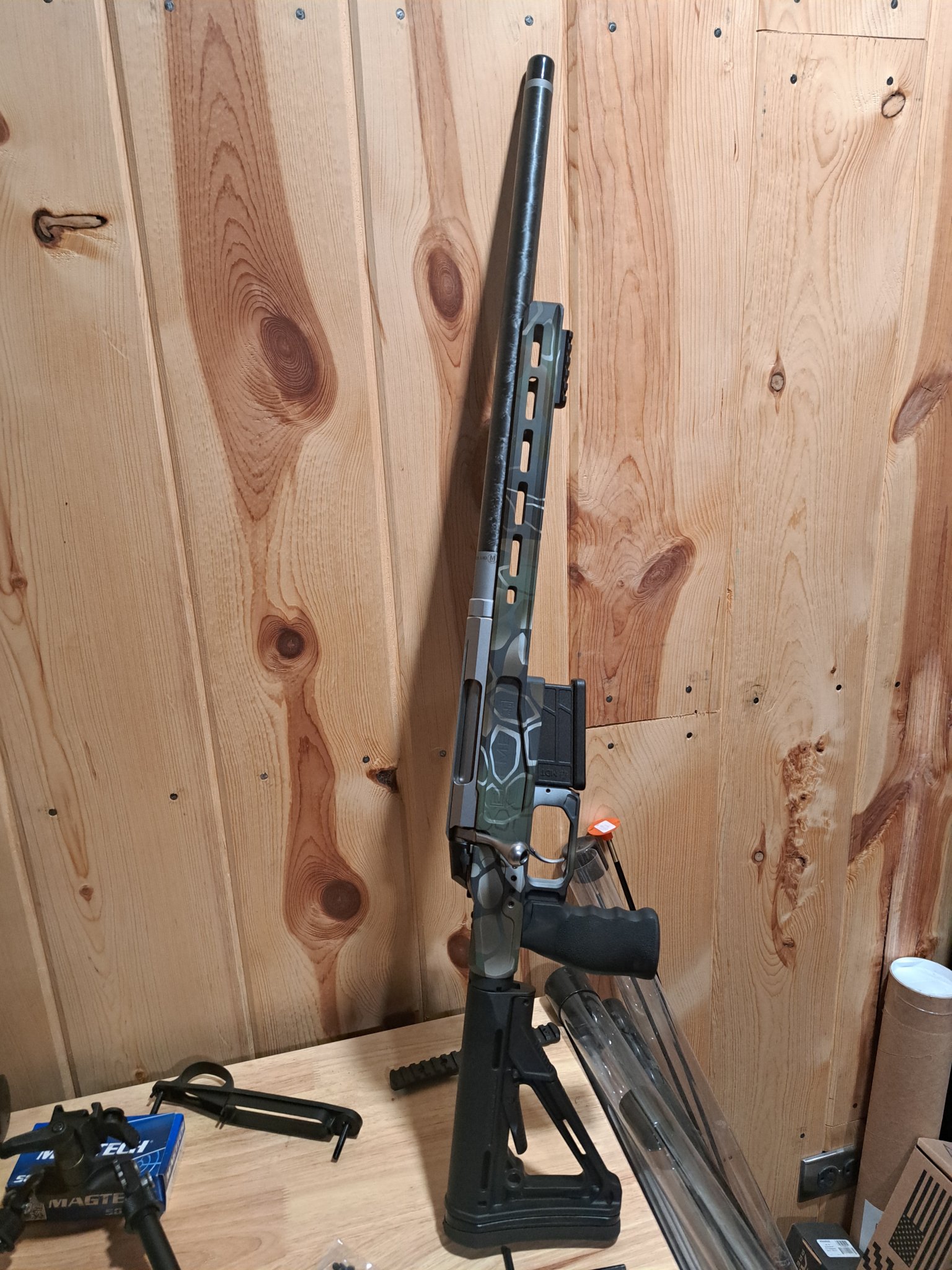

Finally complete, other than scope choice. Just took this one off my CVA Scout. Did my best to support as many manufacturers as possible in this build.
AB Raptor 10 is still in jail & patiently waiting for a seating die. Any thoughts on a sight? Been thinking 1-8 LVPO.
Zermatt Origin action
Black Collar barrel
Timney Hit trigger
Ultradyne Chassis
MDT Grip & Folding mech
XLR Stock

You might look into a 2-something power scope.
I have a lpvo and a 2-12, and I am not sure I see the need for down to 1x.
Just something to consider.
Will definitely consider that. Was thinking LVPO more just for the compactness. The temporary scope mounted is a Nikon 2-7 which is fine size and magnification wise, but will definitely get something a little higher quality, maybe in 600-$700 range and will mount it much closer to bore.

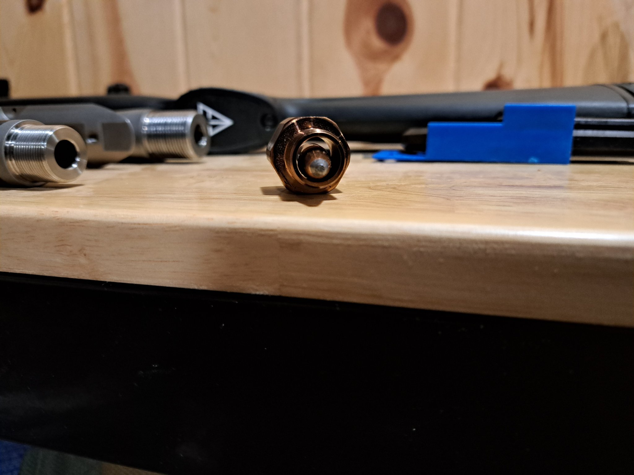

For anyone running an AB raptor can, remember the reflex mount comes back over the barrel and this may effect your gas block and the ability to adjust it.
The reflex may also hit the handguard unless you are using one with a large inner diameter. The big aero precision handguards will cover the can, but not by much. Too close for my comfort, So I got a shorter reflex mount.
Just another thing to keep in mind.

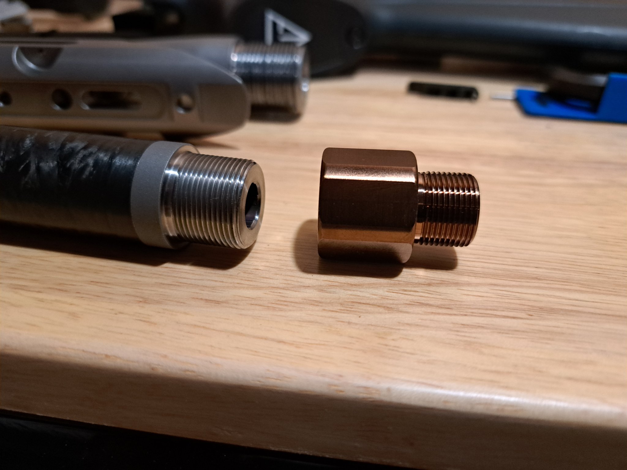

AB makes an adapter from 3/4 to 5/8. Adapters can introduce issues, but the guys at mos-tek were okay with AB's precision.
Also, there are two reflexes. One for bull barrels and one for skinnier barrels. Make sure your barrel diameter will fit!
Here is the adapter.
Here is a .375 270gr Speer bullet sitting in the adapter showing plenty of clearance.
AB only does 5/8 reflex mounts, but they also have adapters for 3/4 (like mine above) and 1/2.

You might already know this, but in case you don't, if your barrel diameter near the muzzle is larger than 3/4" then you will want to order a bull size reflex.
The standard reflex won't fit a barrel diameter larger than 3/4".
Absolutely, you pointed that out earlier and the adapter being as big as it is made me think the larger barrel is needed, necessitating that thinner reflex. Thanks for the reminder

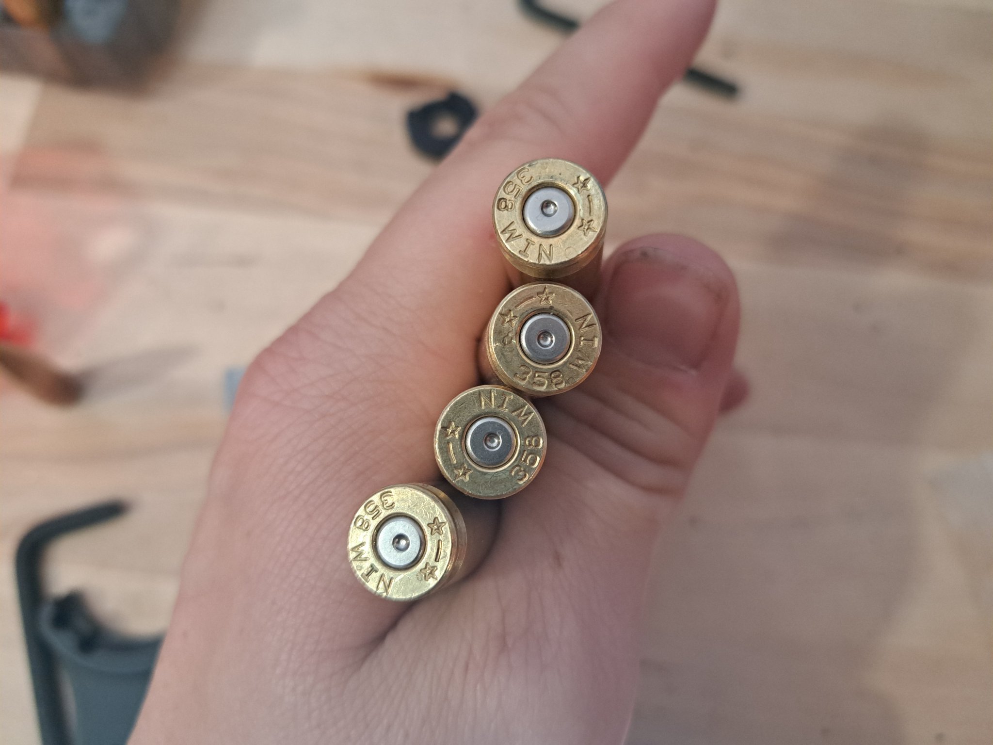

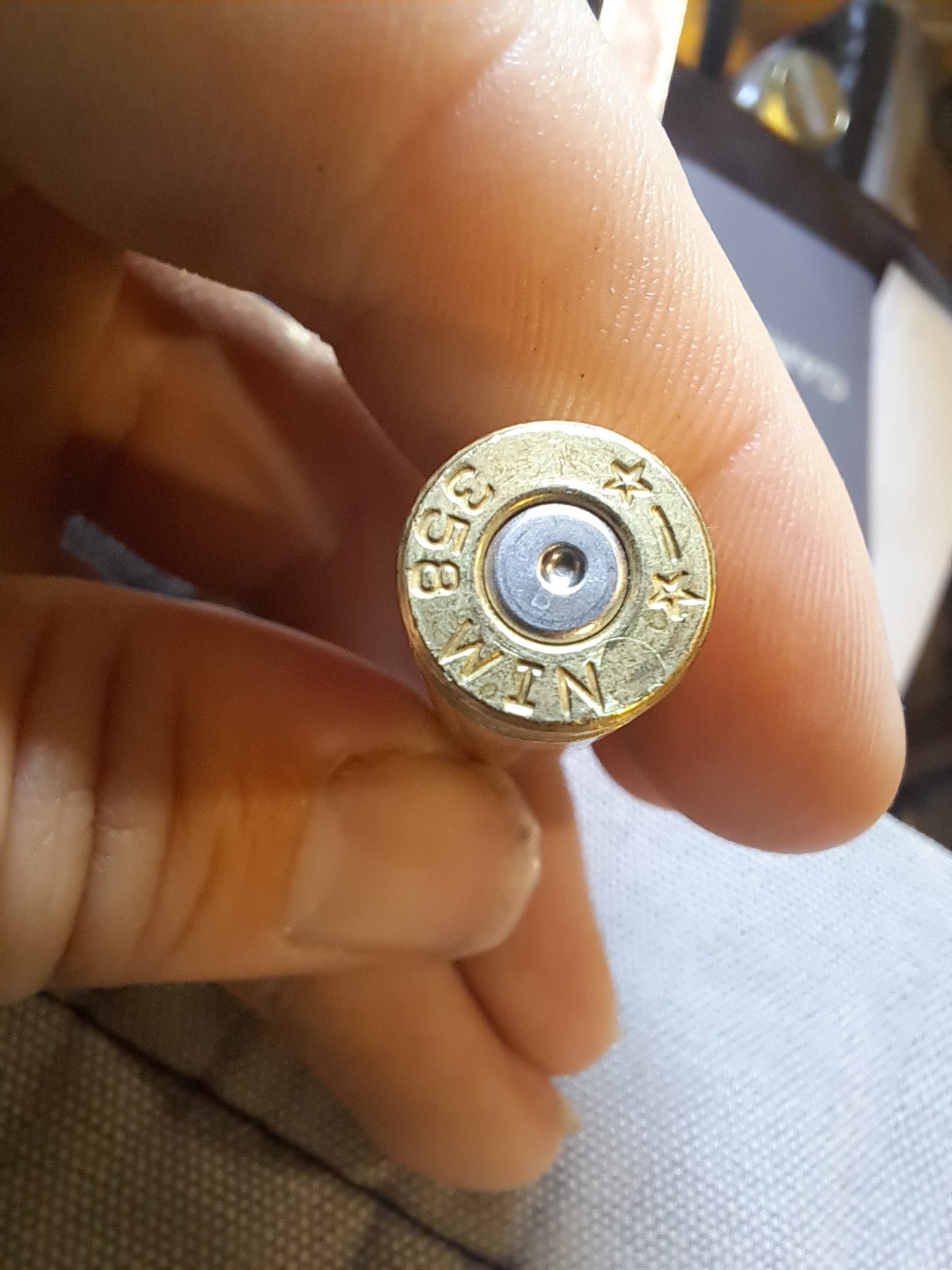

I had some time to kill, so I made some 270gr speer loads.
18" barrel. OAL 2.790 RL-10x
41.5gr- 2175
42gr- 2195
42.5gr- forgot to write down
43gr- 2238
Top brass is 41.5, bottom is 43.
The last picture is the 43gr. I can see a faint ejector mark, I think. Your thoughts? I'm new to reading pressure signs.
