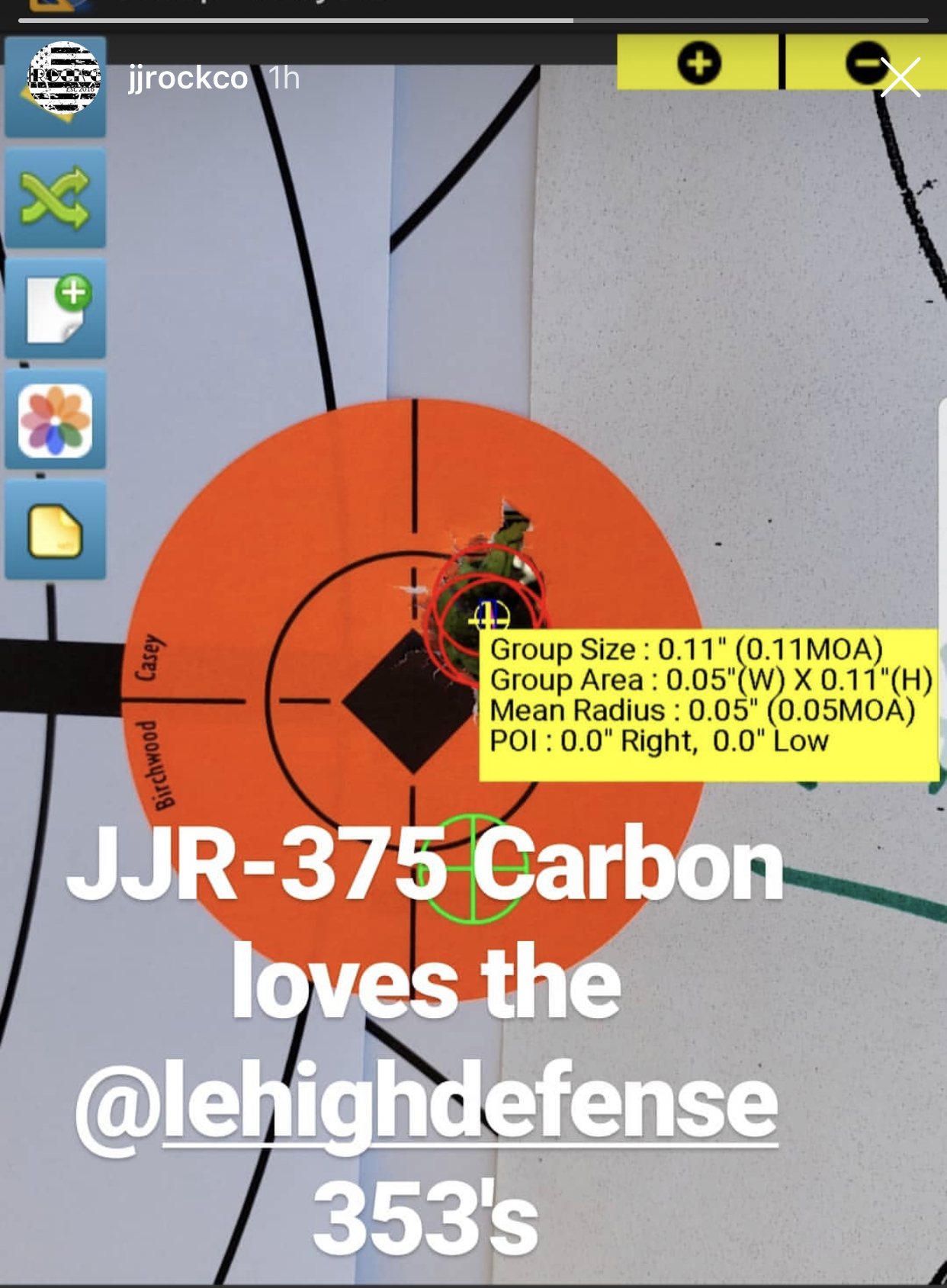

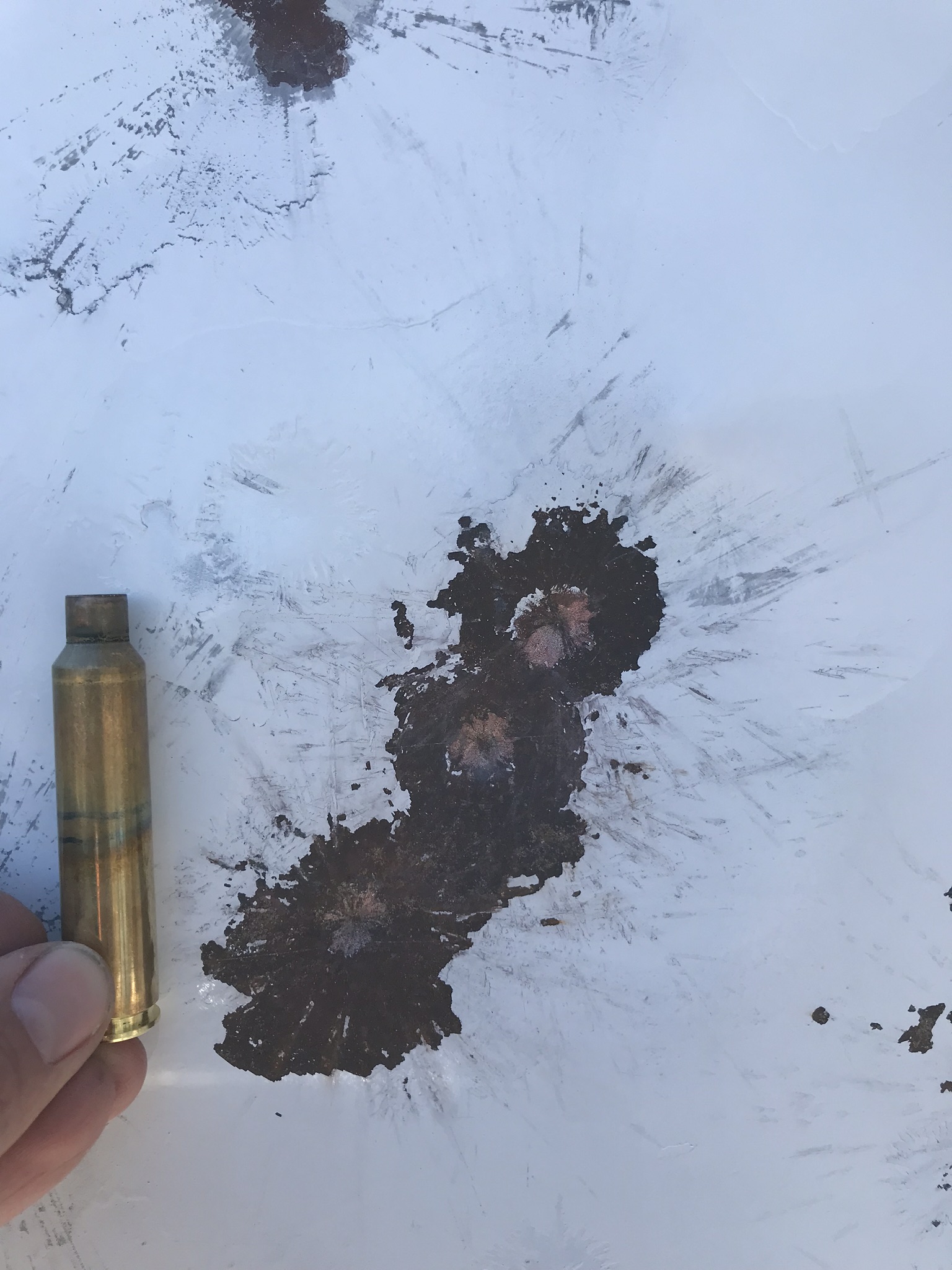

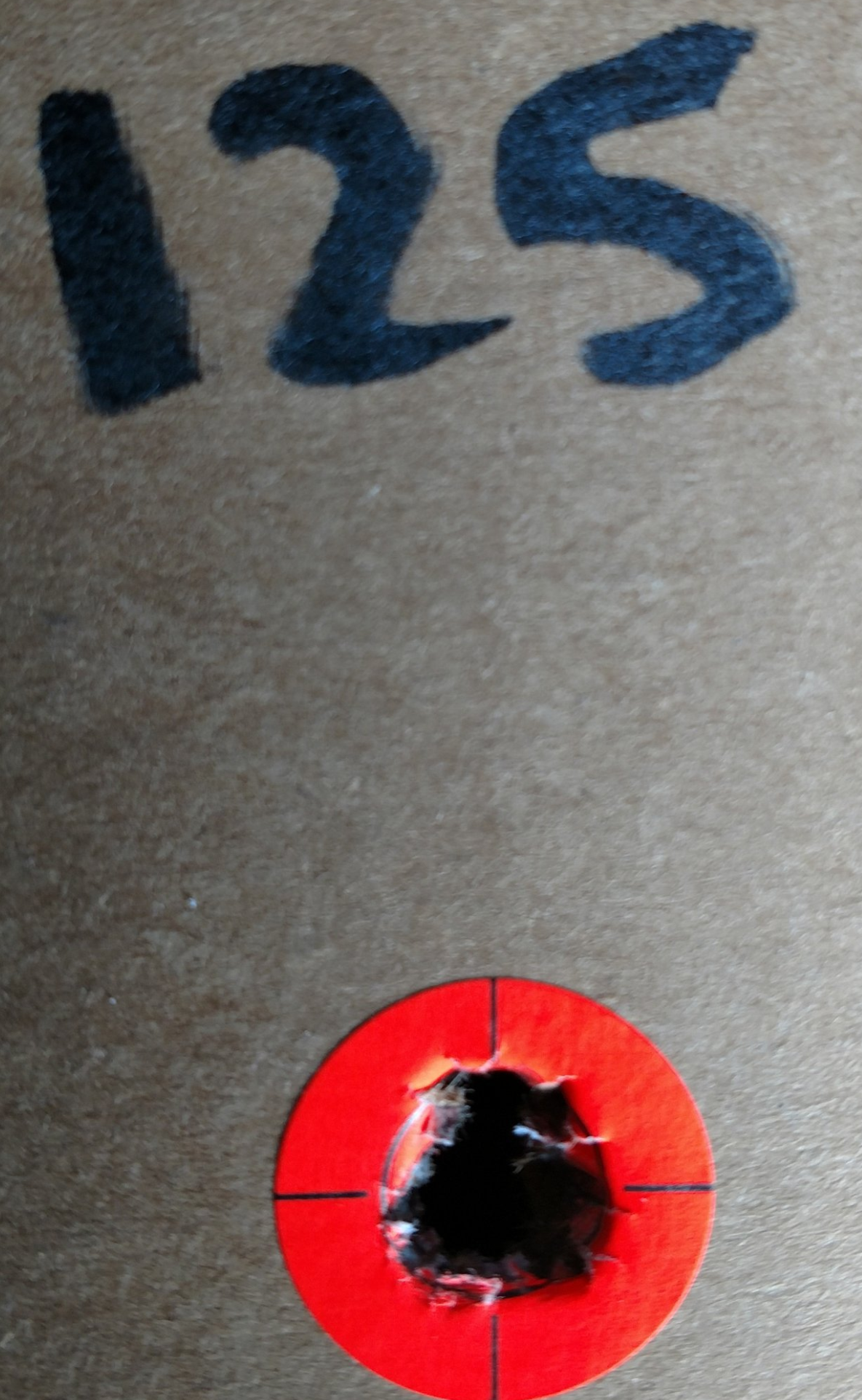

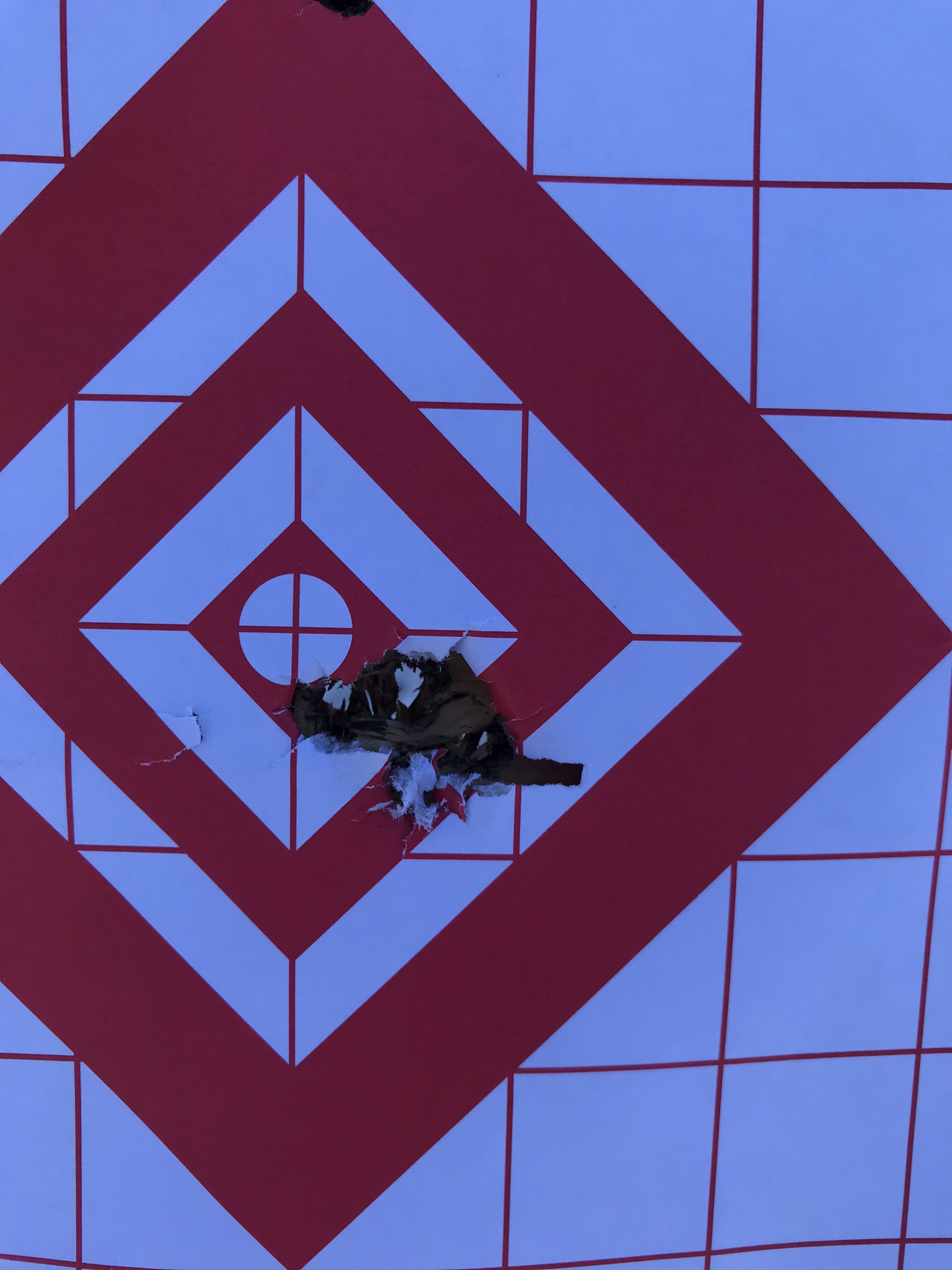

For the shooters using the various 375 cartridges what do your groups look like up close?
I have been and will be doing some more load testing with 350 Sierra's 361 Flatlines and 400 Cutting Edge bullets and want to get a handle on what to expect.
1 inch
3/4 inch
1/2 inch
1/4 inch
What have you been seeing?
