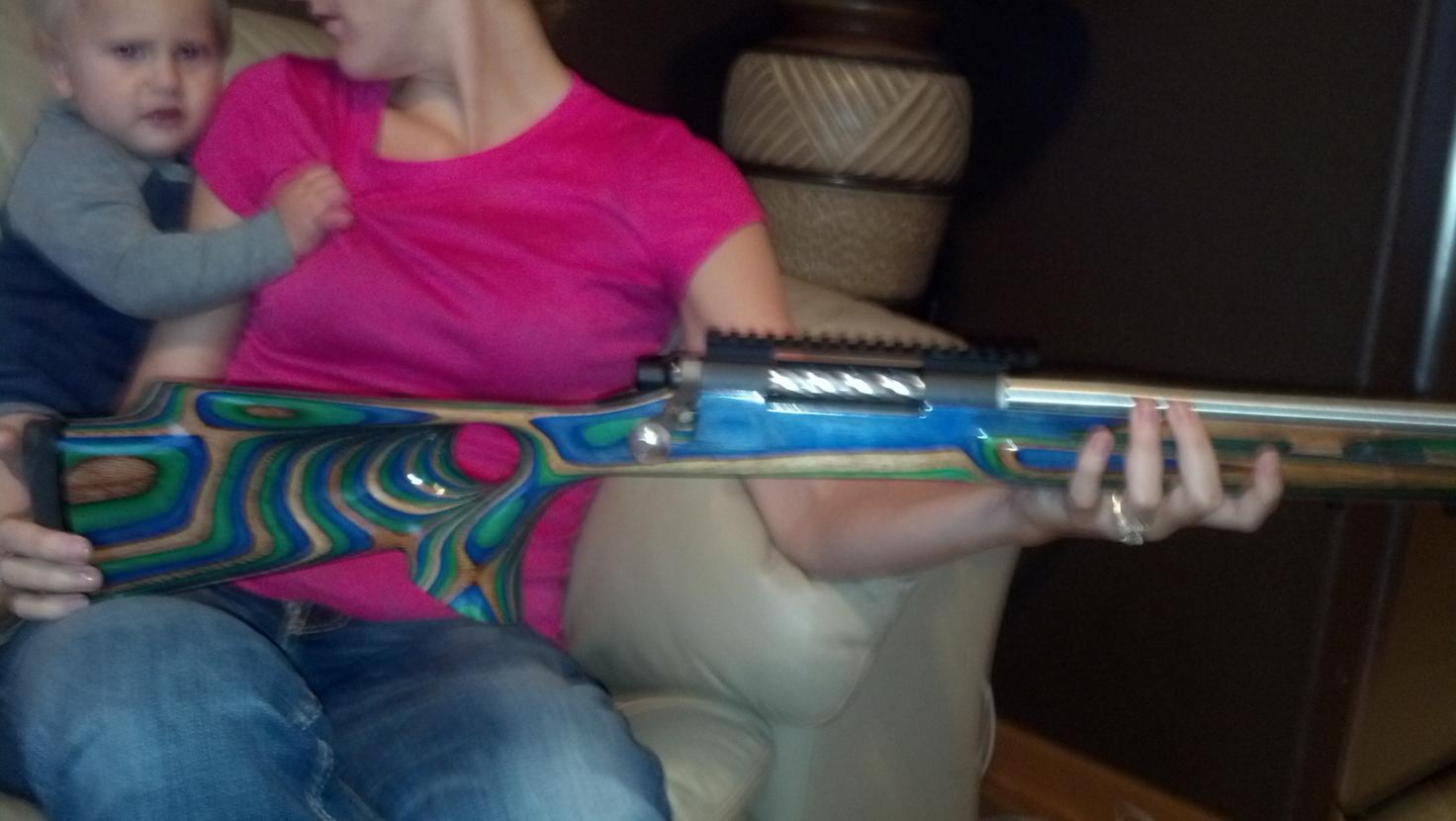

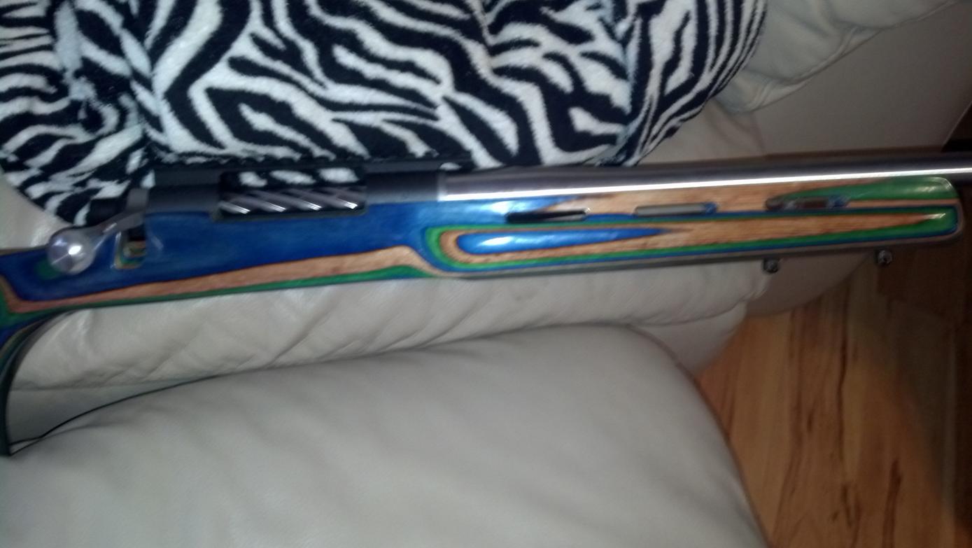

    Well I finished the 375 Hammer. With 85 grs of 4831SC I got 2590 fps. In the initial tests. No pressure signs. I am going to switch to IMR 7828 SSC it should get me to 2700 FPS mark with a 350 SMK. The rifle was shooting .6 Moa right off the lathe. I will figure it out and dial it in a little better. Then off to build a 7X375 Ruger. I really like this case
    rigmaster, can you share your build specs? What action did you use, which bottom metal, barrel twist and length and all that fun stuff. If you're able share some pics of your finished rifle as well.
    If I get around to building one myself I think I'm going to call it Mjollnir ;)
    CNC blue printed Remington action. 27" Brux barrel. Cheap Laminate stock. Used a standard 375 ruger reamer. I over polished the chamber a little not much. And added .400" free bore.
