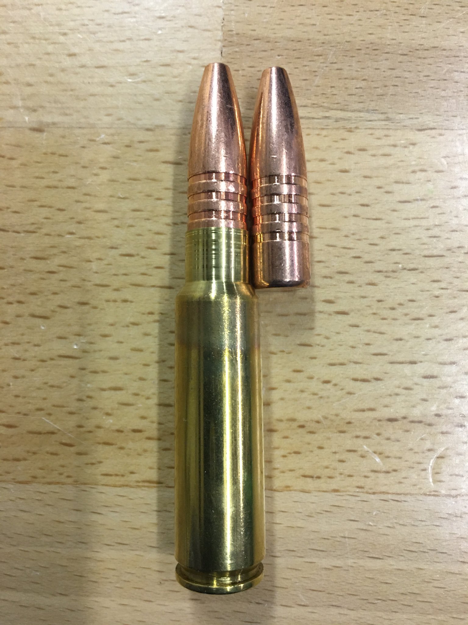

What is the powder type? How many grains? What is the overall length of the cartridge? Did you have to throat the barrel out with a special reamer?
How many step ups with sizing buttons? 2?...
300 To 338 to 375?
60-65 grains of powder (similar to the 300 wsm)?
Or does the .375 bullet eat up a lot of case capacity?
Thanks

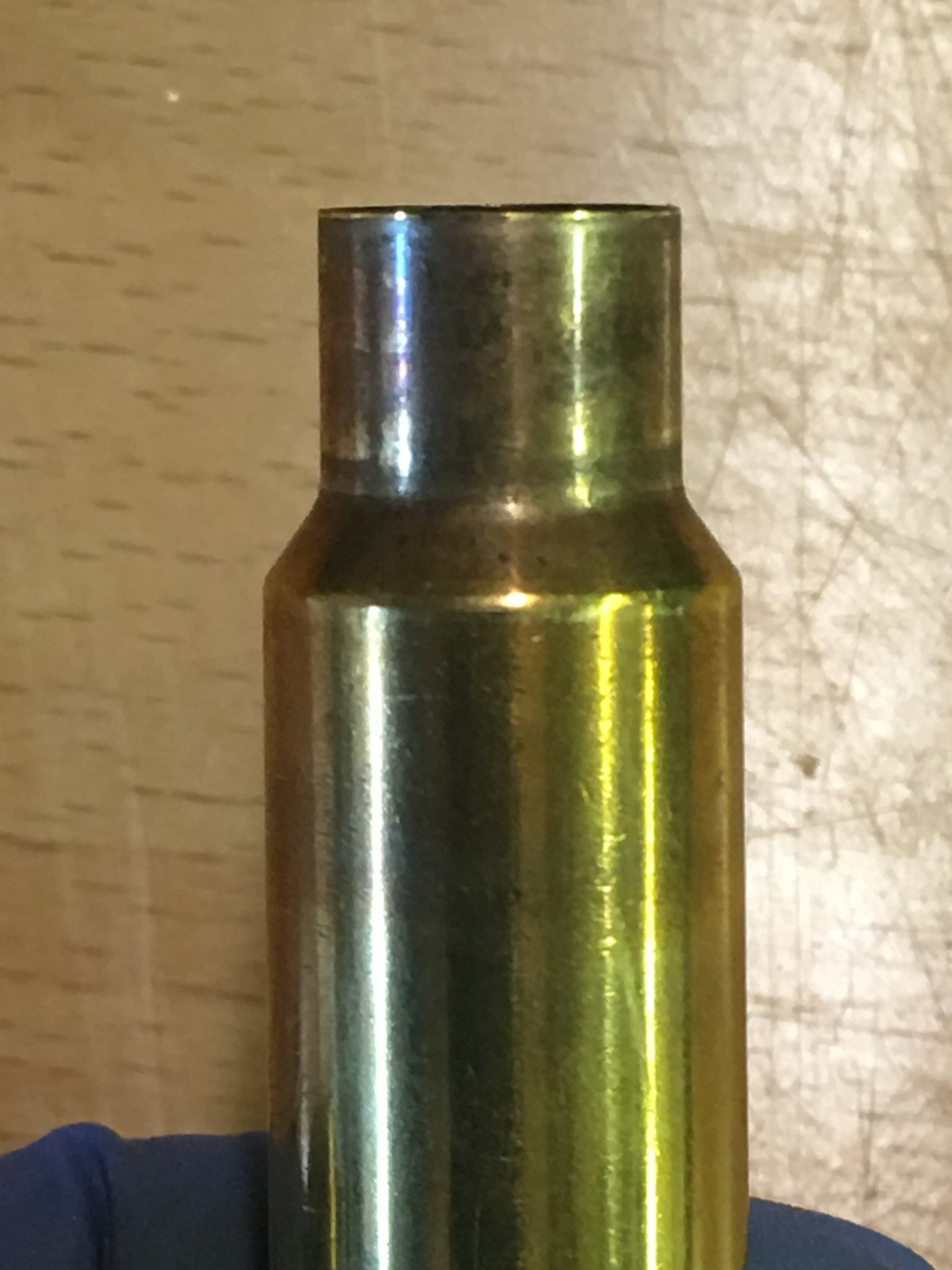

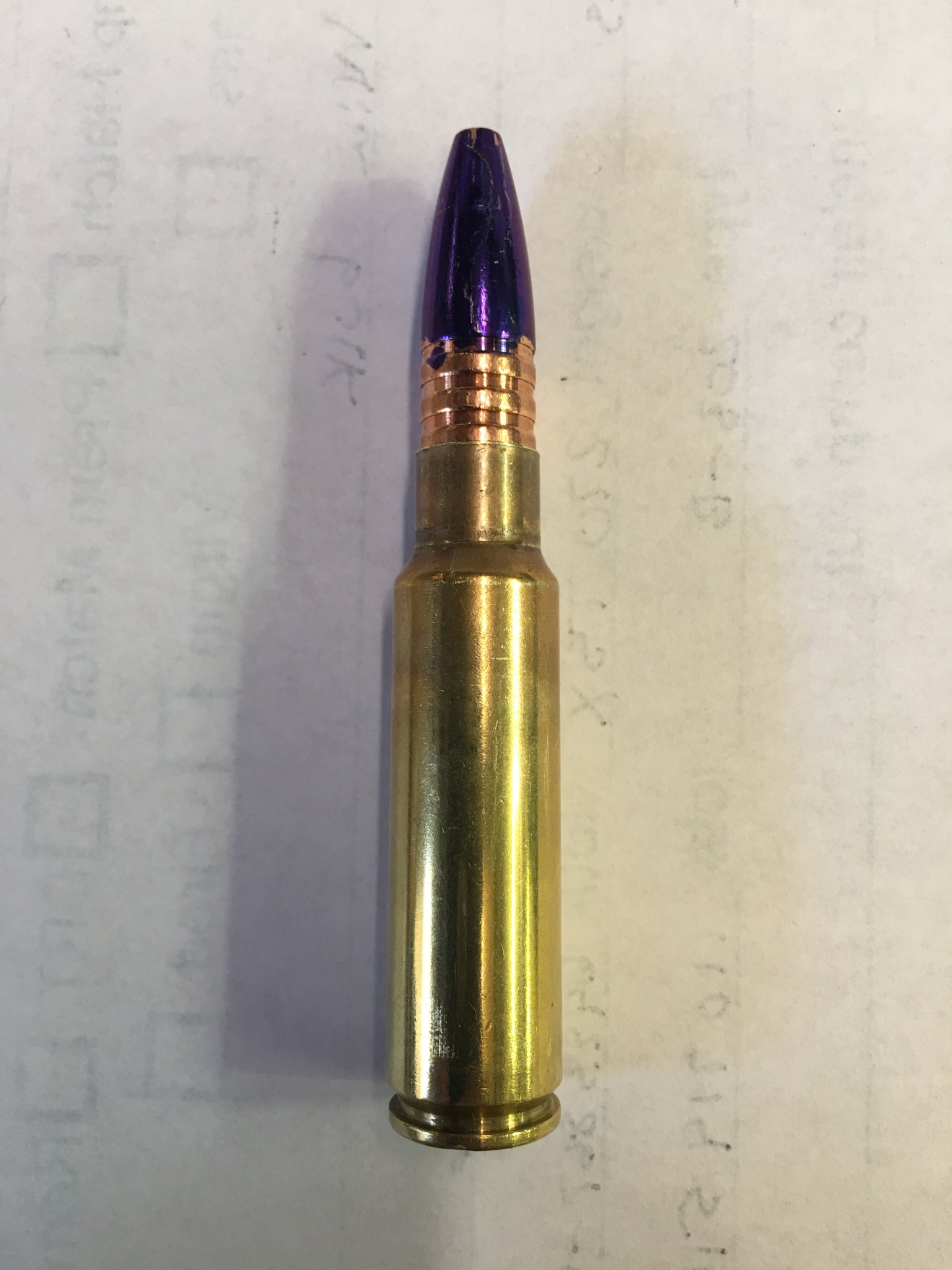

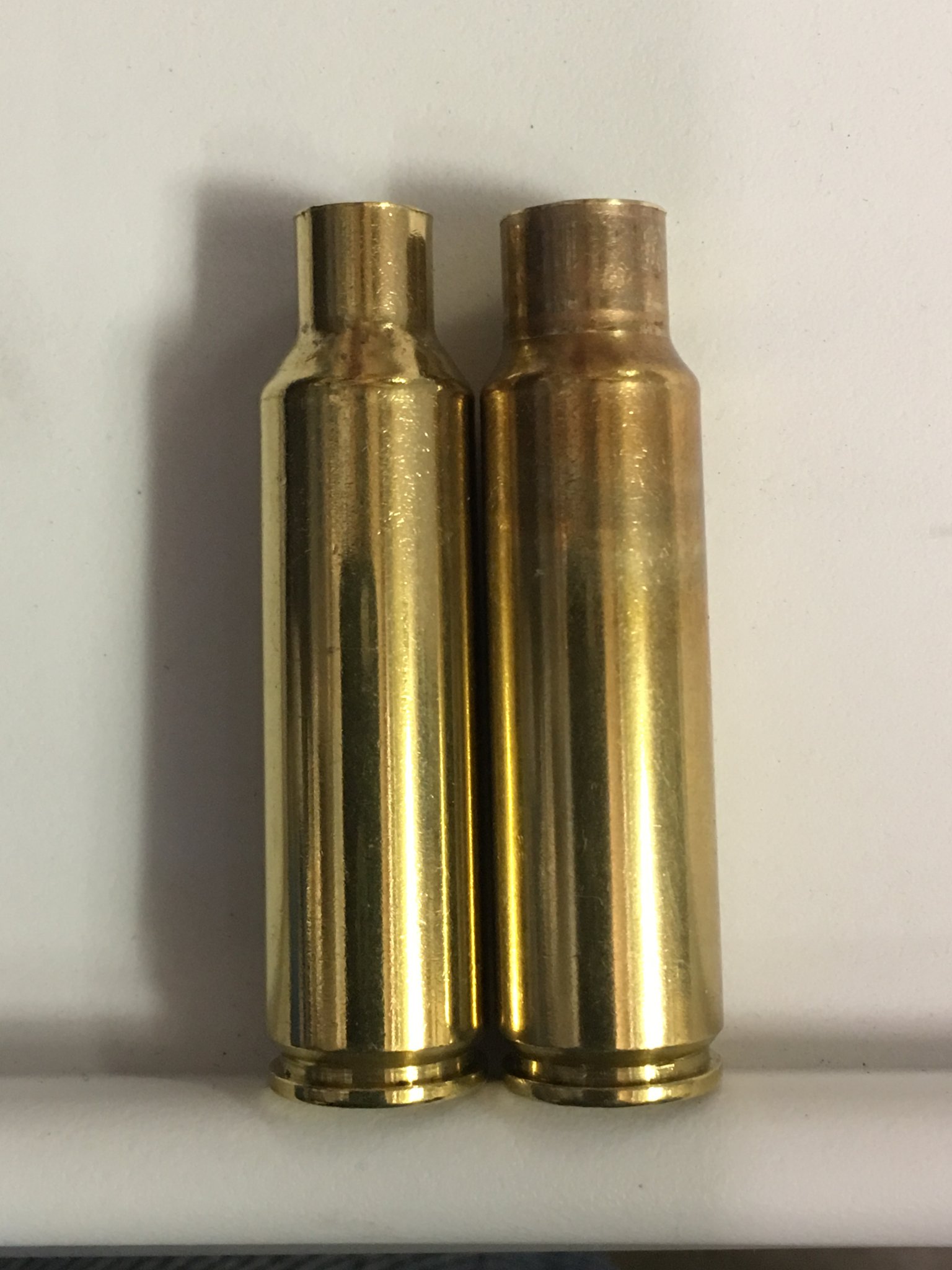

Reamer was designed to put base of bullet at neck / shoulder.
I annealed virgin brass.
Redding tapered expander, went from 30 to 375 in “single” pass.
Start expander into neck, as soon as I felt resistance change, remove case, add more lube to neck of case, go a little deeper with expander, resistance changed, add more lube....
powder charge is really going to depend on how chamber is set up, how far out bullet can be seated.
Too many variables, won’t go into possible powder charges that can be used.
