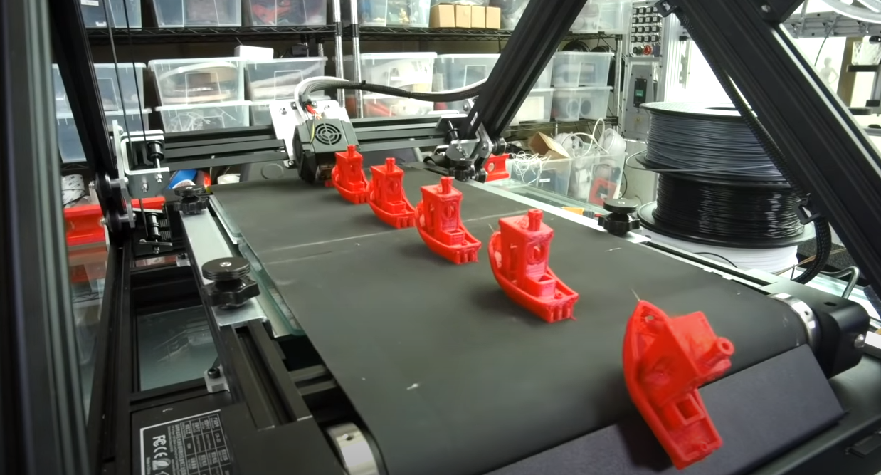

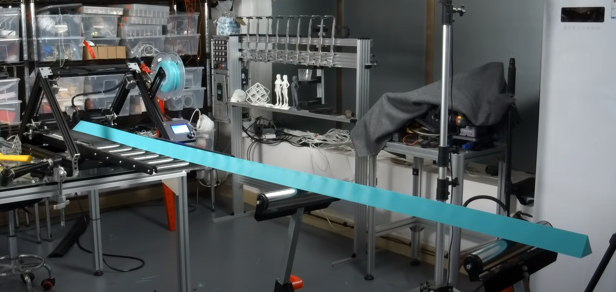

    The new Printmill from Creality looks pretty awesome too, it's a conveyer belt bed so can print really long parts or lots of smaller ones that just drop off the end of the bed when they're done. I'd say it's a design that will get refined a lot more but it's an impressive thing already.

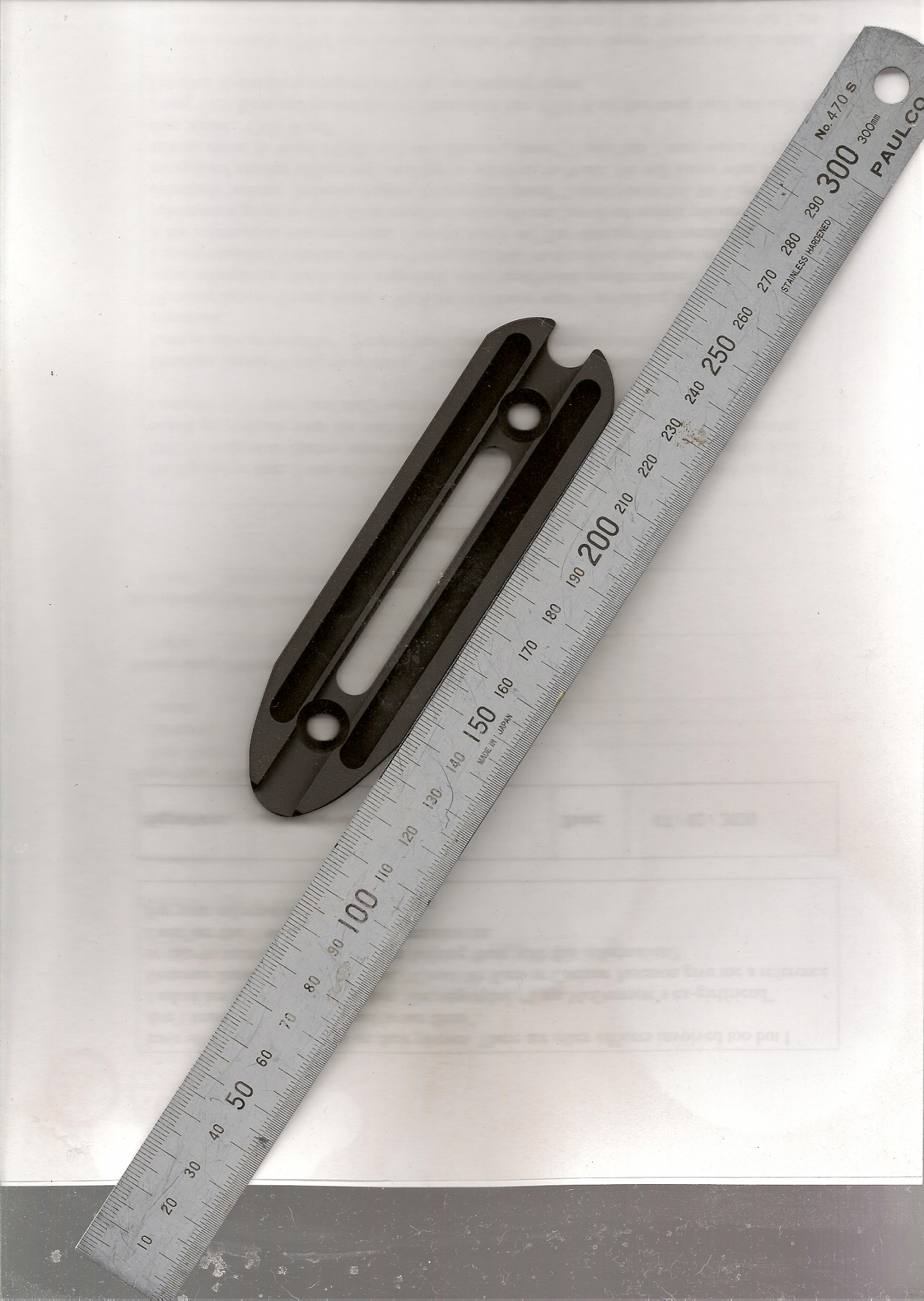

    I use a cheap flat bed scanner all the time for this. I just sit the part on the bed with a steel rule next to it and scan it then scale and rotate it in CAD so it's square and the right size and draw around it. Using this method and some radius gauges or a cheap plastic contour duplicator you can draw some pretty complex designs.
