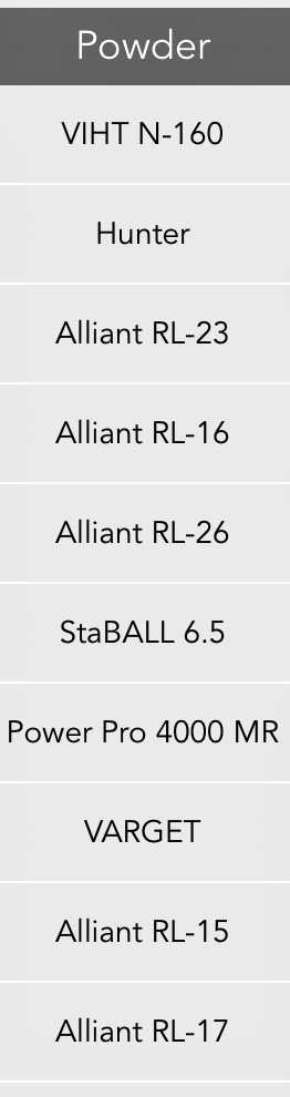

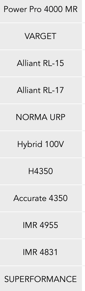

Btw Hornady now lists these powders for 147-153 gn projectiles in 6.5 CM. According to Hornady, PowerPro 4000 MR produces (along with RL26) the highest speed for the heavy 147-153 gn bullets, at about 2750 fps, from a 24” barrel.
Interesting that RL26 is known for giving exceptionally good muzzle velocity, but typically not the smallest group size. [RL16 in my experience produces around 100 fps less, but have seen group size below 0.2 MOA.] It seems 4000MR continues in that tradition.

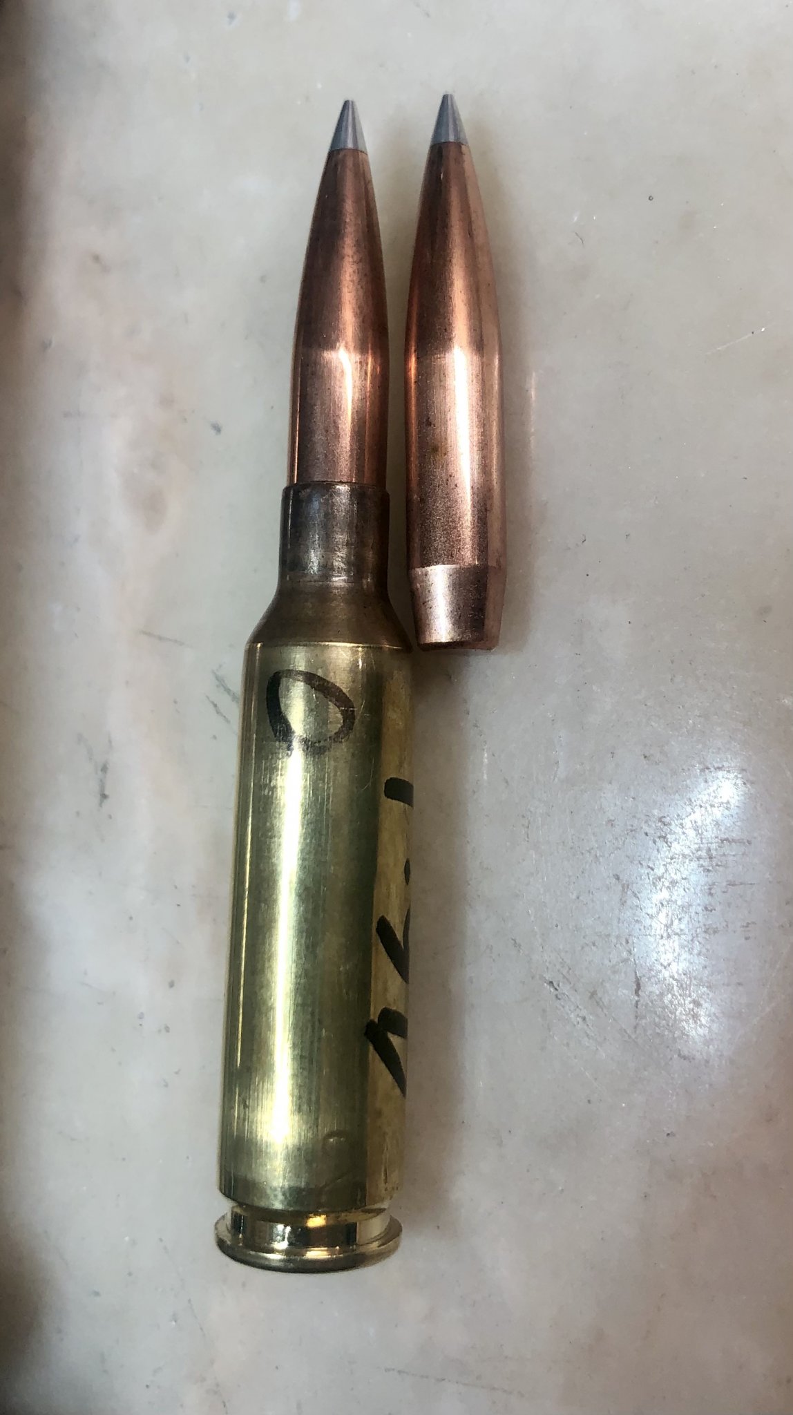

Is this powder a practical alternative to get long heavy bullets in the 153 to 156 gn range up to descent speed? I think not, unless you have a long freebore: Load density is not ideal in the Creedmoor case for a 147-156 gn long shank bullet that sits so deep in the case. Load will be too compressed.
Note that 3,500 rounds have moved the lands forward in my rifle by 0.2” or more. I can now load very long (COAL of 2.984”) to avoid the donut area, still avoid a jam (aiming for 20-25 thou jump), and that gives more chamber volume, which requires more powder to get the speed to book max. Loading such a long heavy bullet in a new rifle with typical freebore to magazine length will likely not work well (bullet will intrude way too deep into the powder column and cause a compressed load), and i doubt bullet can be seated deep enough to avoid a hard jam, which is not recommended, before the load gets severely compressed.
And the bullet shank will be touching any donut present around the neck shoulder junction, which will not help accuracy.
Bullets in a highly compressed load can also be pushed out gradually in the hours after seating it, which can lead to an unexpected hard jam and an unsafe situation. I had to use an old Phillips ultrasonic toothbrush to settle the powder. A drop tube would have helped here. So please handle with due care.
Once your barrel goes past 2,000 to 2,500 rounds, you might have some success with 147-156 gn projectiles using this powder. While you have normal/typical freebore suitable for say a 140 gn ELDM ,there are better alternative powder/bullet combos available to you. If this is the only powder you can find, you can probably make 140 to 145 gn bullets work well enough in a new rifle.

Yep: Hornady 11’th edition lists 4000MR for 6.5 Creedmoor 140-143 gn and 147-153 gn.
Speed is pretty good, similar to RL-26. Availability is pretty good too.
