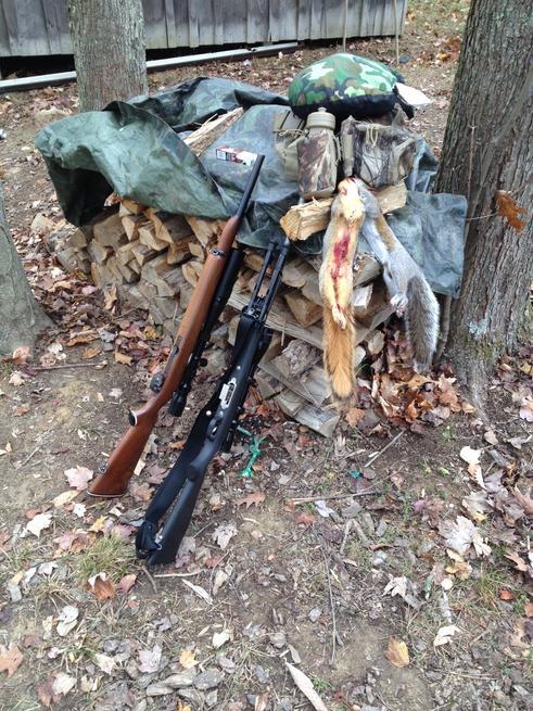

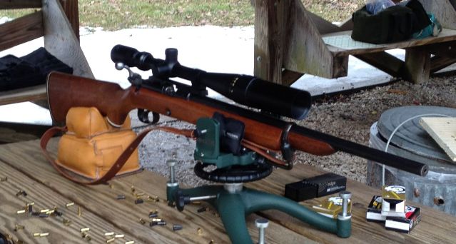

If a repeater is a priority to you, then at least consider locating a nice Win Mod 52. The B or C model is likely the best. Most, (not all) are repeaters. The quality of the machine work and bluing is simply at the top of the American gun makers art. The precision of the lock work and trigger is top notch. Prices are in the $800 to $1500 and up range which is similar to the 40X. The 5 rd metal mags are high quality and mine feeds anything I put in it. Trigger is better than my Remingtons by a small margin. Mine is a clapped out 1932 model pre-A speedlock carbine that is far from pristine and at 82 years young the original bore is not new any more. Even so, it shoots nearly as well as my best Rifle and in the 30 rd Dot shoot was able to average 0.267" at 50 yds. The older Pre-A's look a little dowdy but the newer B's and C's are more modern looking and usually shoot as good or better. Another option might be a custom Sporter Spec BR rifle. This are amazing repeaters and have been known to score 2350's out of possible 2500's in ARA matches.
Pics attached: Pic of the rifle, a typical 50yd 5 shot group, and shot from hunting camp as this rifle brings home the bacon and the squirrels, lol.

To emphasize my mod 52 comment above, Frank Green posted on here recently about his Model 52D custom rifle with custom bbl, bedding block and bedded action. This showcases the potential of those old rifles when given modern upgrades.... Irish
Quote: The three groups at 50 yards measured a .156", .116", and a .144". Last group I shot was a .512" at 114 yards.
