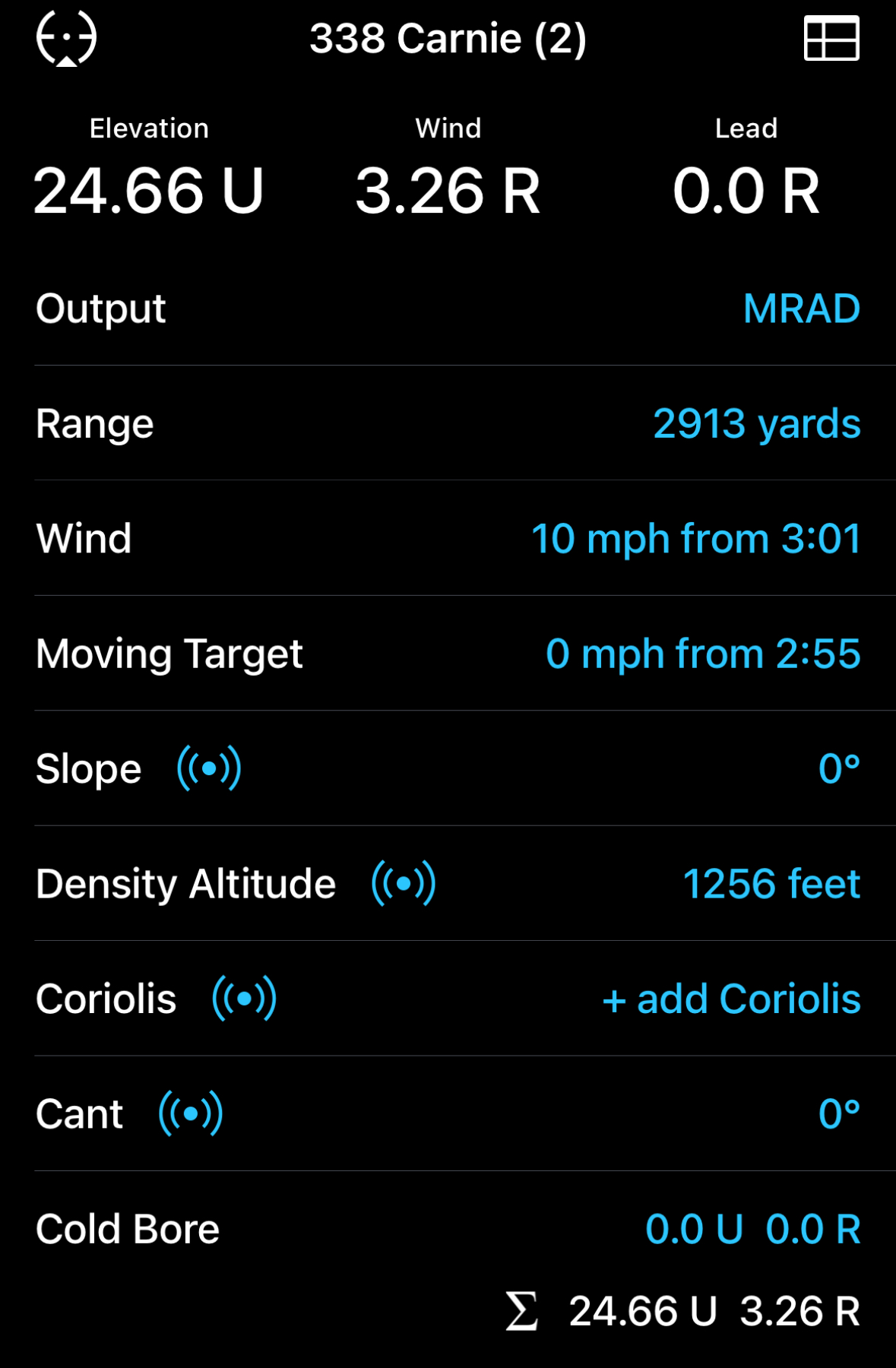

No i do not shoot solids/CE Lazers in my 33XC.. I shoot 300gr ATips and Berger. I shoot them in one of my 300 RUM Ackley Improved. What I dont care foe is all the extra elevation Ive had to dial in shooting them,. The difference at 2913 yards was 38 mils with A Tips and 52 Mils with CE Solids
Reactions: A5scott
