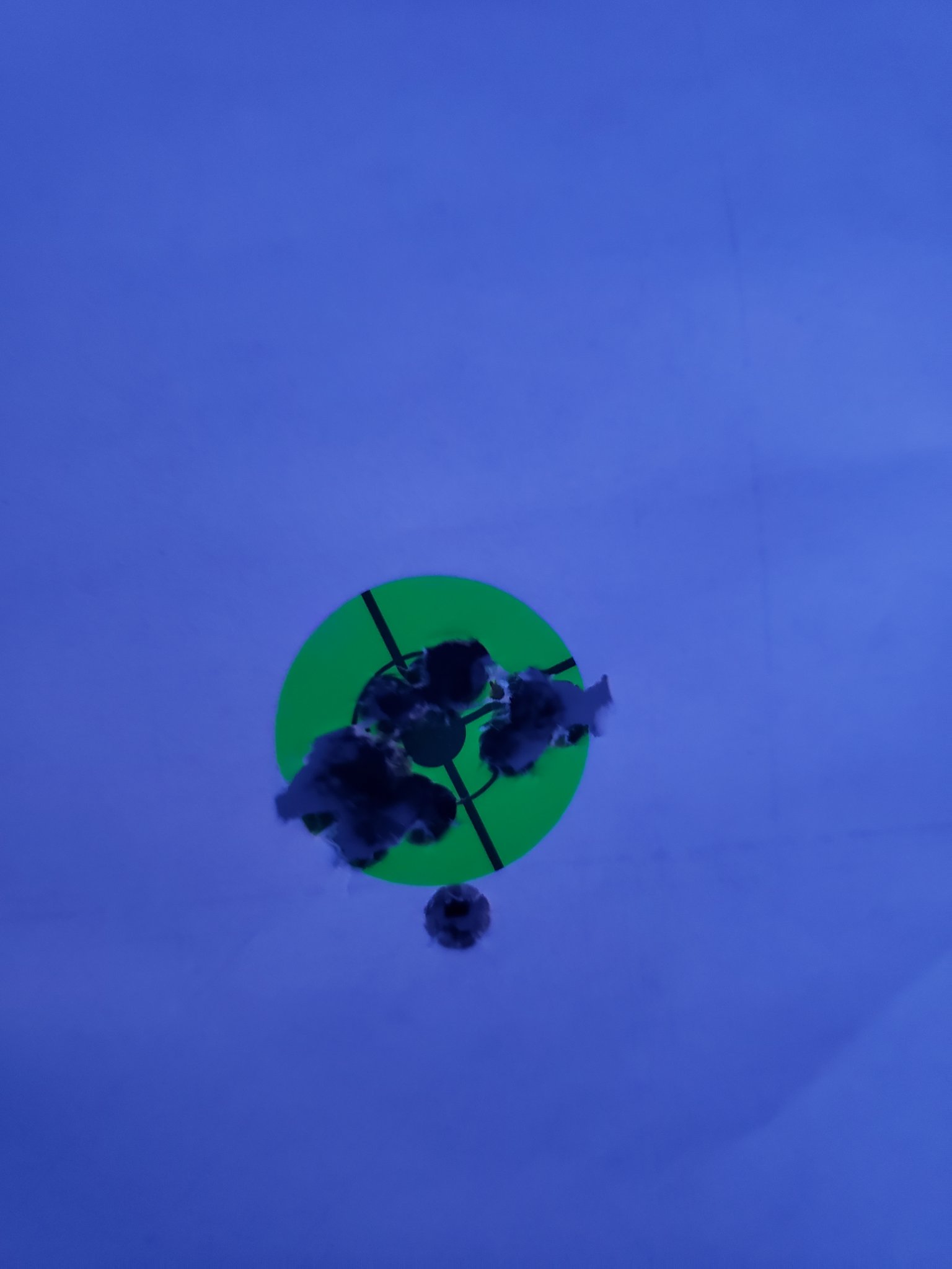

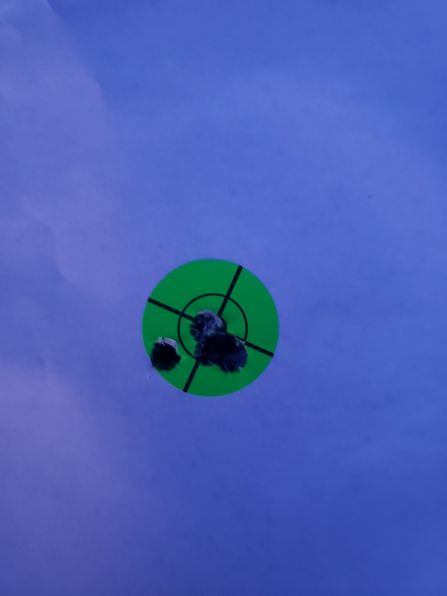

Tried this in my 22BR. 28gr under a 88gr ELDM in new Lapua brass got me 2990fps and single digit sd. Worked up from 27.2 .2 at a time. Accuracy was 1 moa or worse until I hit 28 grains. Five shots in the first picture and 20 in the next, both are 1" dots.
