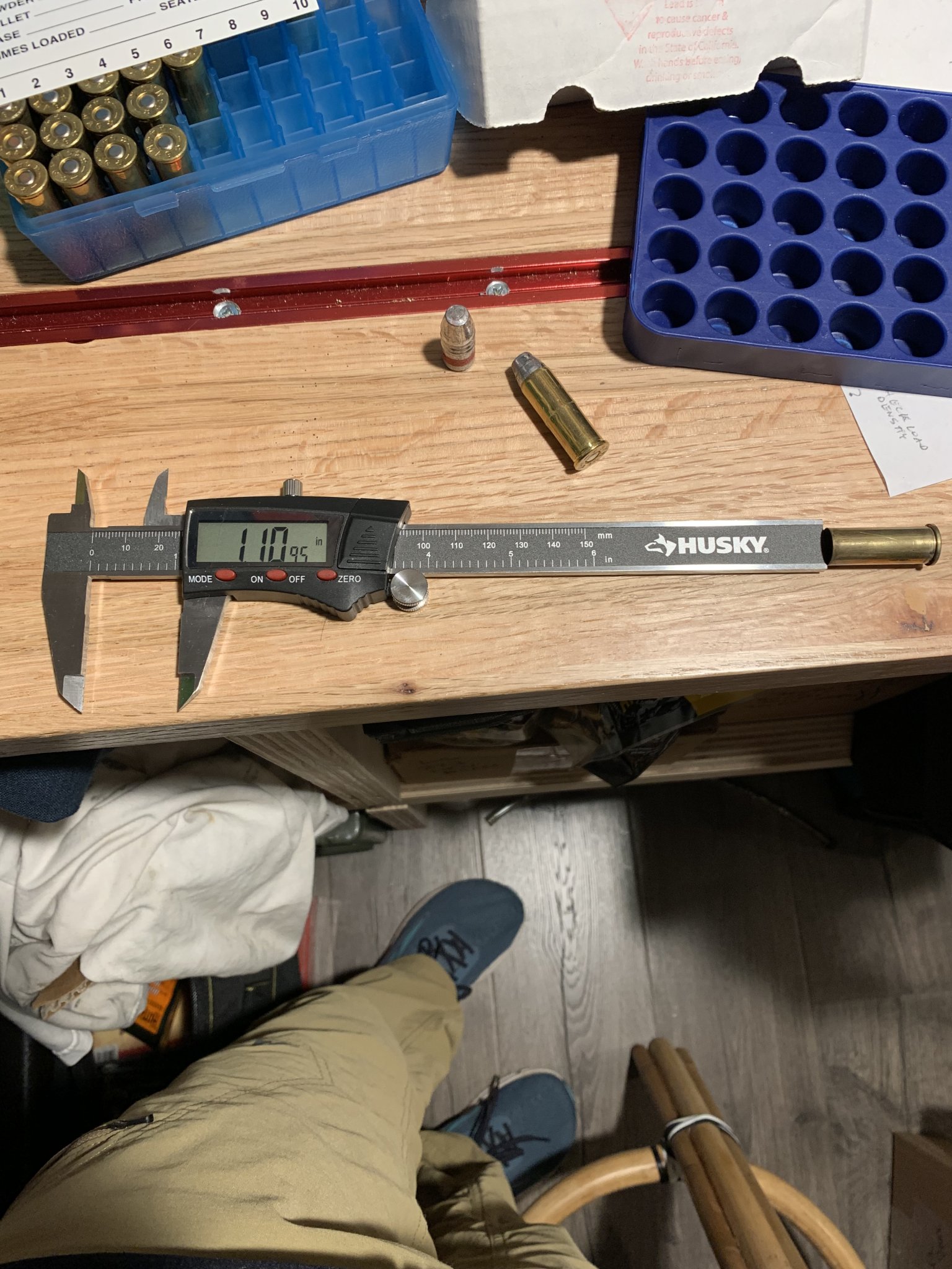

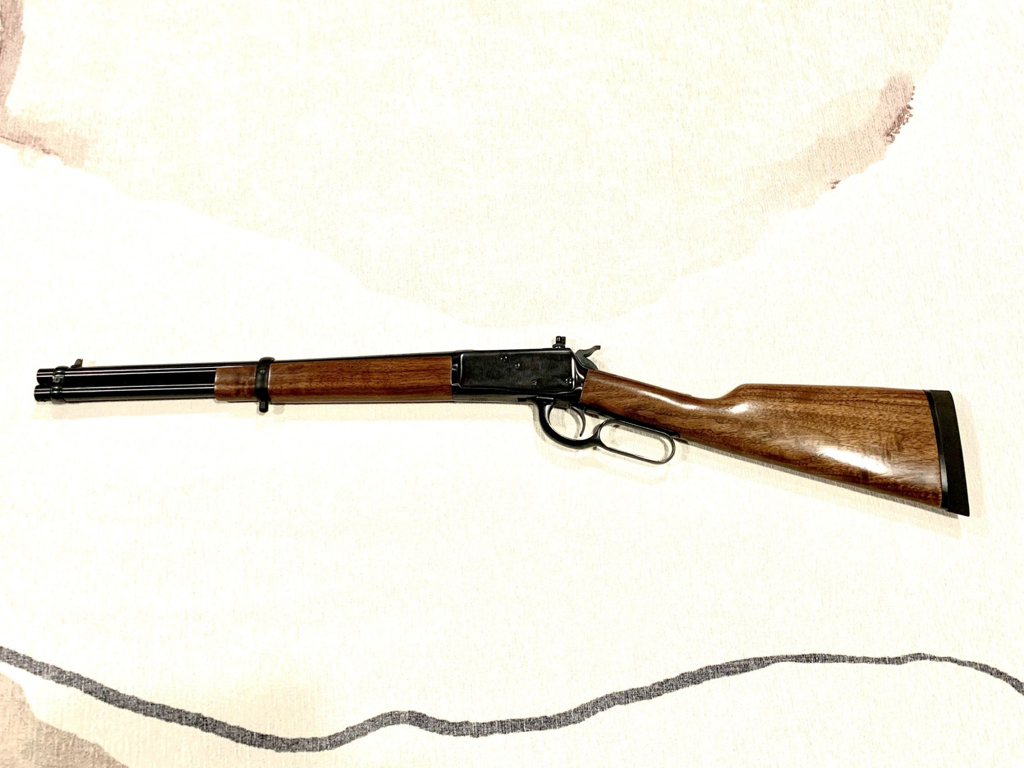

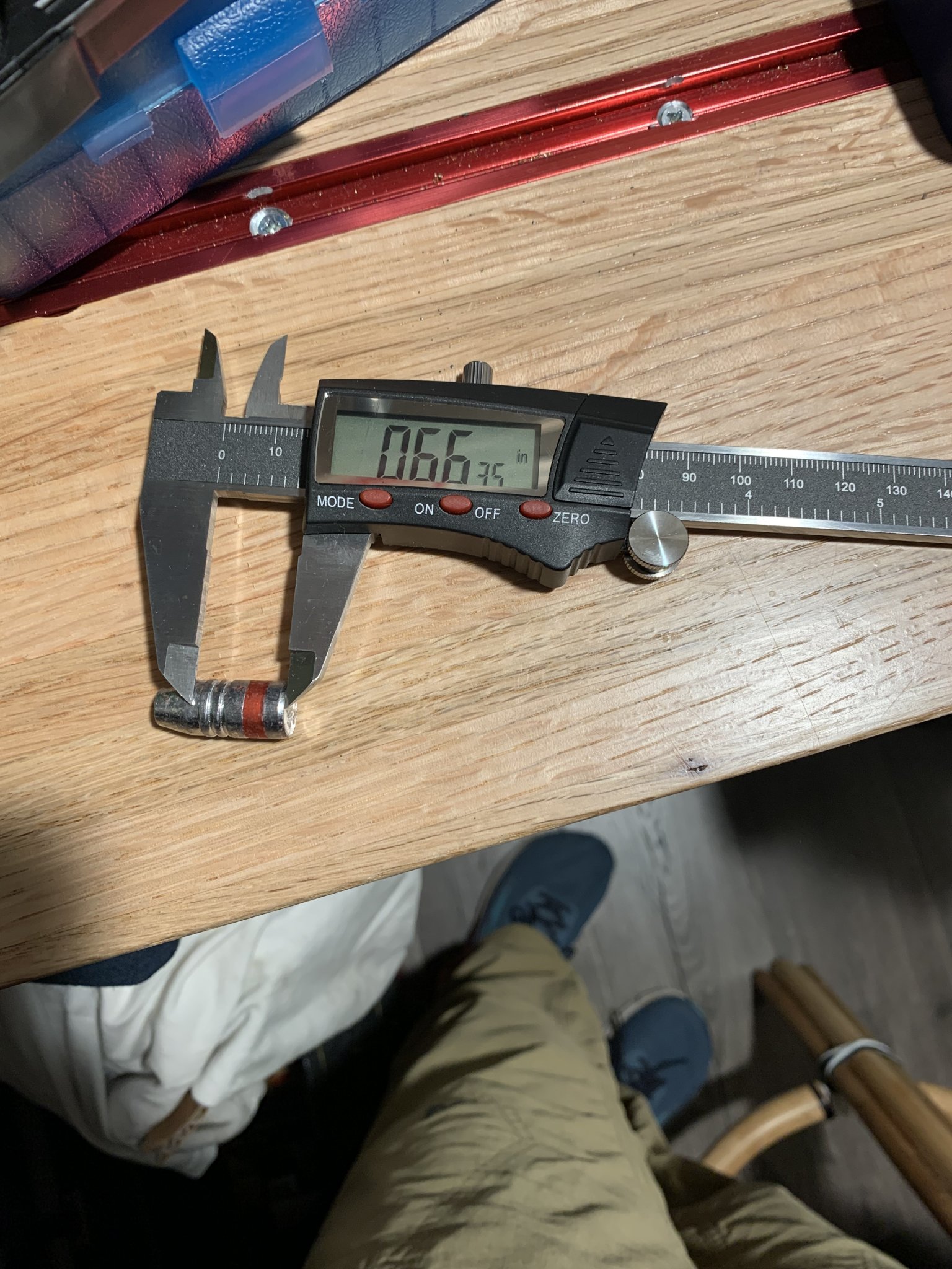

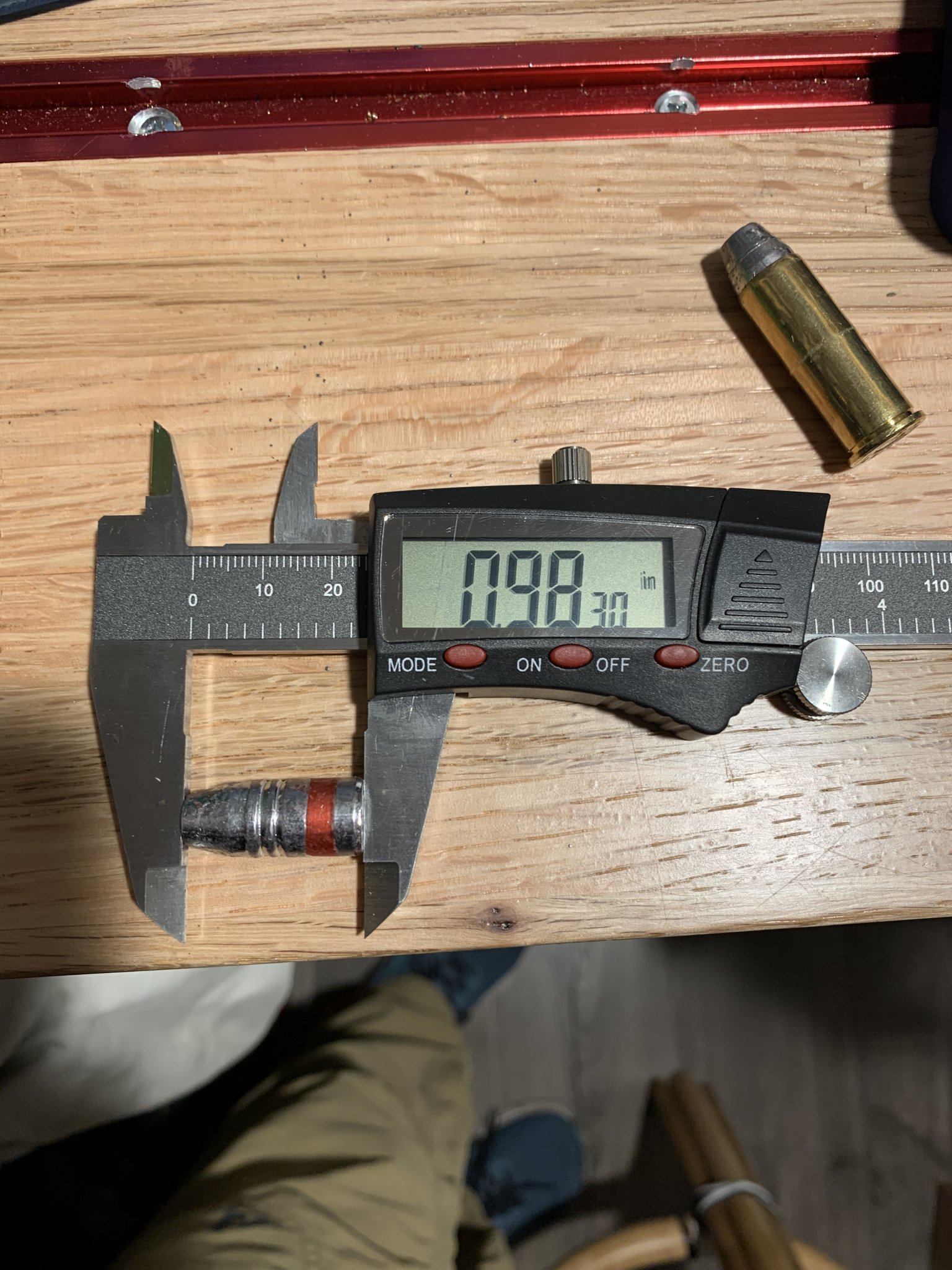

    Hello, I’ve got some .430 320 SSK bullets from Penn Bullets I bought years ago that I’m trying to load for the first time with H110. I need to keep the OAL to 1.6” so they will cycle in my Rosie 92. Apparently, “THE” load with these is 21.5 grains of H110. To actually get that much H110 under that bullet, I would have to seat this pretty far out, much farther than 1.6” OAL. This bullet does have crimp grooves for that and I’m guessing that’s how they loaded the 21.5 grains that’s mentioned so much and that they were using a pistol, not a lever gun. These would fit, loaded that long, in my Ruger Vaquero, and likely recoil more like my 4.75” barreled 454 Casull, but they will most likely not cycle in my 92. I did some measurements and the 100% load density with H110 loaded to OAL of 1.6” is 17.3 grains. I loaded one this way with 17.0 grains and it will cycle in my 92.

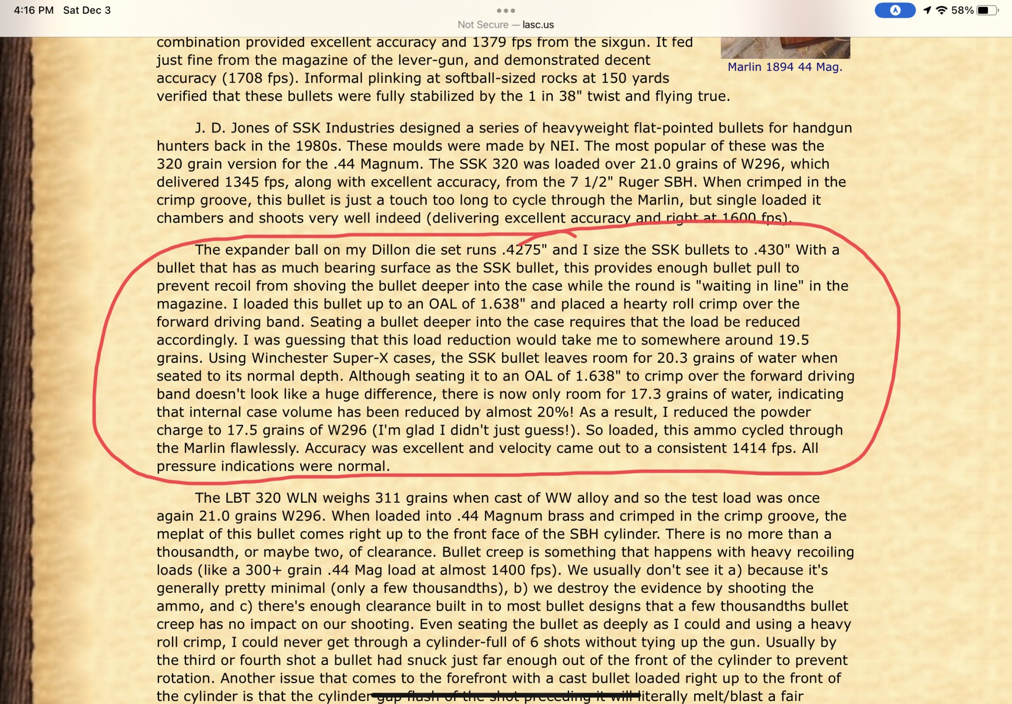

    2. I know reduced loads with H110 are dangerous, but I believe that has to do with available loading space, not actual grain weights. In other words, even though 17 grains is less than 21.5, because it still fills 98% load density of the remaining cartridge space once the bullets seated, this should still be a safe load, although it will be slower. The bottom picture below is a loaded round. Is this correct?

    I might have found my answer in the following article. Not much information regarding loading these for lever guns, but I might be able to go to the top crimp groove and load out to 1.638” or so and it might still feed. Some say their 92’s will feed to col of 1.7”, which seems a bit long.
    The picture below is the paragraph pretty much addressing my questions above.
    Its my understanding those were designed for Thompsons and single shots.
    I would wager you are correct hence the reason I can’t find much if any mention of using them in lever guns. I will say that round pictured above will feed in my Rossi, but I also took the action apart last summer when I replaced the stock and spent a good deal of time smoothing it up. If I can get them to 1400 fps and if they shoot well, that’s good enough for me.
