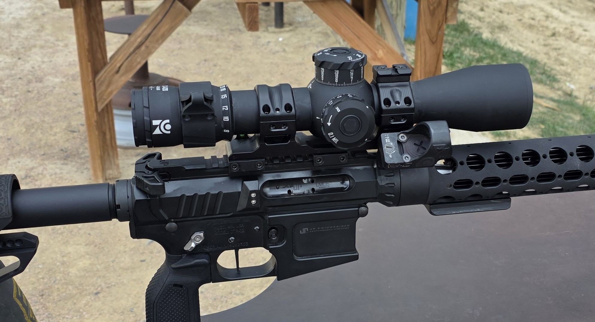

45-degree Offset
Pros: Easy to acquire by rolling the rifle over.
Inline with the bore and basically at a co-witness height so I can use whatever zero scheme I want.
Cons: It's awkward to use from the support side.
Mounts take up rail space.
I have to take extra shit with me to support the gun while it's canted at an angle to zero.
My situational awareness sucks with larger optics because when the gun is rolled over the optic blocks my field of view.
What ends up happening is that my brain then sends all the signals to my right eye so I end up seeing through a tube with a dot in the
middle surrounded by black. That sucks transitioning from target to target, but hey sweet cheek weld.

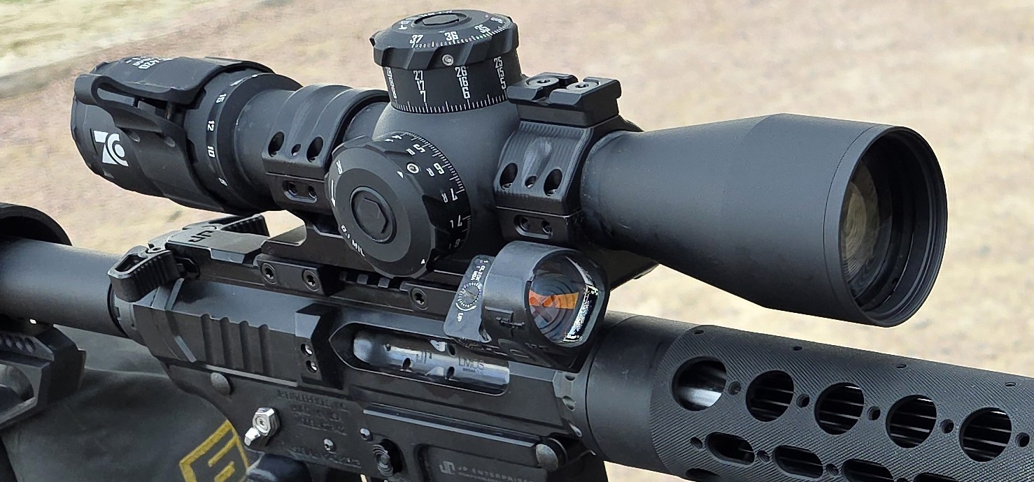

12:00 mounting location:
Pros: Easy to zero, I can just stay in position with the same bipod and rear bag and zero at 100 same as the optic.
The optic is no longer blocked by the scope so when in use I have increased SA going from target to target.
I can use the optic from the dominant or support side without much issue.
I can see the dot just over the elevation turret so it's not really a chin weld with the cheek riser, I basically lift my head and there's the dot.
Deconflicts rail space for accessories like dope card holders, brass catchers, levels, etc...
Cons: Taller profile. This can get in the way depending on the situation but so can the 45 offset.
Limited options for quality stand alone mounts unless going with a new mount that has the option to swap turrets.
Those are just some of my experiences in experimenting with the two set ups over the past year.
