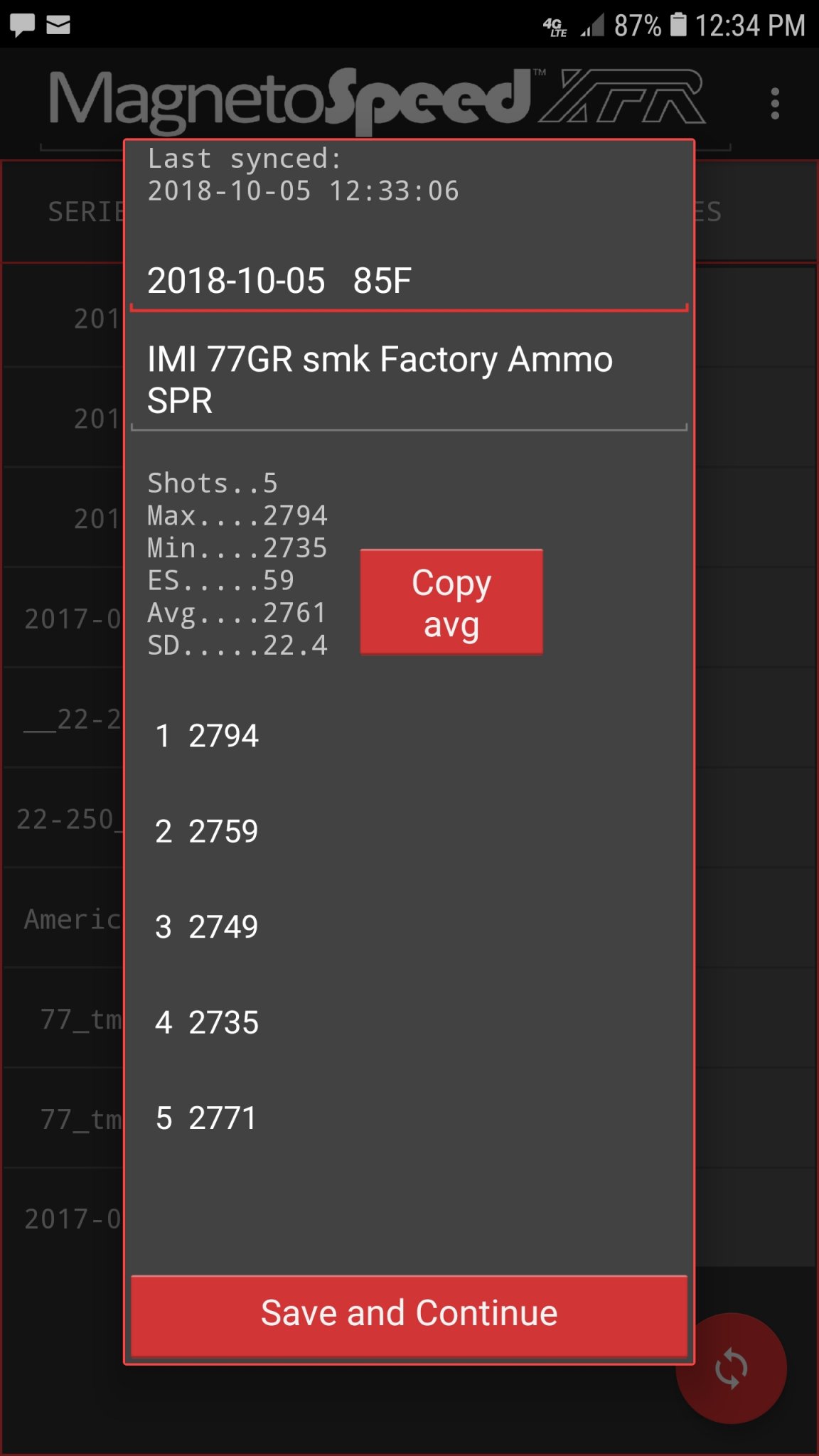

Thank you. That looks very good. Velocity is marked a bit slow to match the 262 ammo. I would still buy some and try it when available.
Just providing data for anyone interested
This is IMI 77 grain out of an 18 in WOA SPR .223 wylde barrel with 9 inch form 1 suppressor
