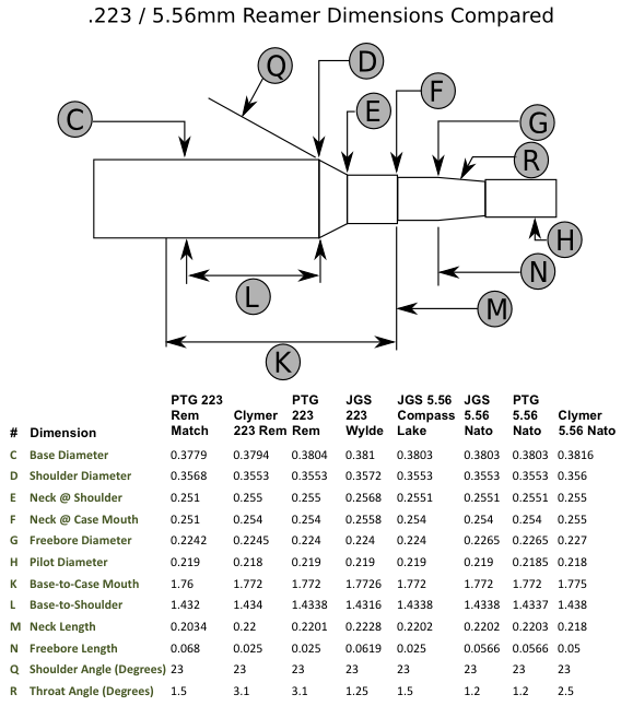

5.56 isa slightly roomier chamber with a longer freebore generally, not roomier than a sloppy 223 chamber though. Generally speaking yes. Just dont go shove a 77gr 5.56 round into a short throat 223 chamber absentmindedly.

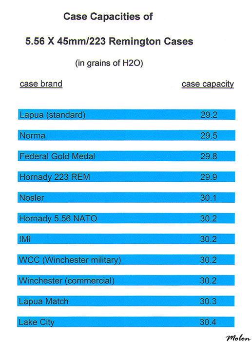

As far as the brass goes they are not the same, there is 223 Remington commercial brass & 5.56 Lake City NATO brass . Accurate Arms site has load data for 223 Remington & 5.56 NATO pressures .

I’ve found difference in the internal capacity of commercial brass and military brass, the outside dimensions are the same. In testing the two types of brass with W748 the commercial holds more grains of W748 than the Military NATO brass.
