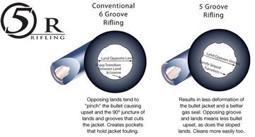

They are said to clean easier, as the brush/patch doesn't need to get into a the tiny 90° corner that exists in a conventionally rifled bore where the land meets the groove.

In the following pic you can see the difference between 5R and 6-groove "standard" rifling:
I have several rifles with 5R rifling, a couple with 6 grooves, and one with 3 grooves. The 5R may be a tick easier to clean for the reasons mentioned above by turbo54, but it's not a huge difference. The other reason it's supposed to be easier on jackets is because the lands are not 180 degrees opposite one another within the bore, in theory "squeezing" or "compressing" the bullet less from directly opposite sides. I've never had any issues with the non-5R barrels messing up jackets, so I really can't say I've noticed anything special about the 5Rs in this regard, either. I can say they shoot very, very well.
