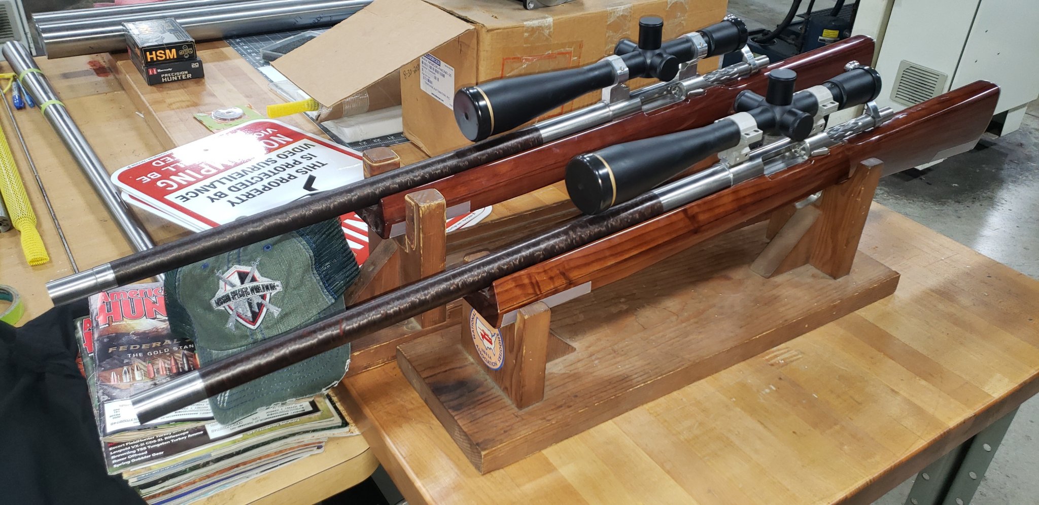

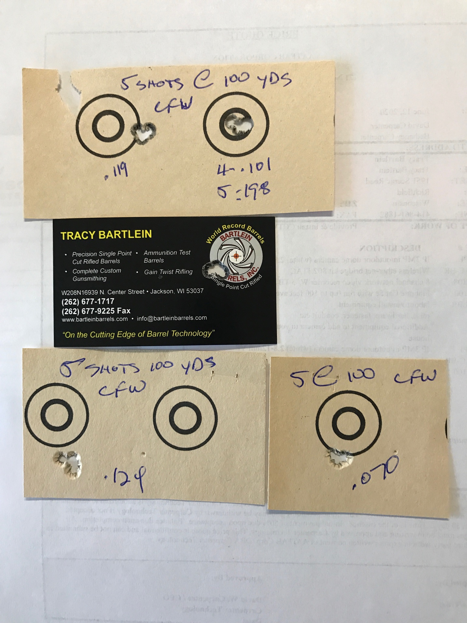

Here some pictures for your viewing pleasure....first one is of Mark's new CFW barrels in 6PPC. We made him only two and he test fired them last week Tuesday. No load tuning etc...put 15 rounds thru each gun. Three 5 shot groups. One group is missing as he used a different target just to check that the guns where still on paper.
The last picture is of his target that holds the current world record for 10 shots in the unlimited class at 100 yards. Like the target says....that's a .104" for 10 shots. Not pictured is his other current world record group is a .081" for the light gun class. Those barrels are 5 groove.
Guess what barrels are on his cfw that we just made him?
Later, Frank
