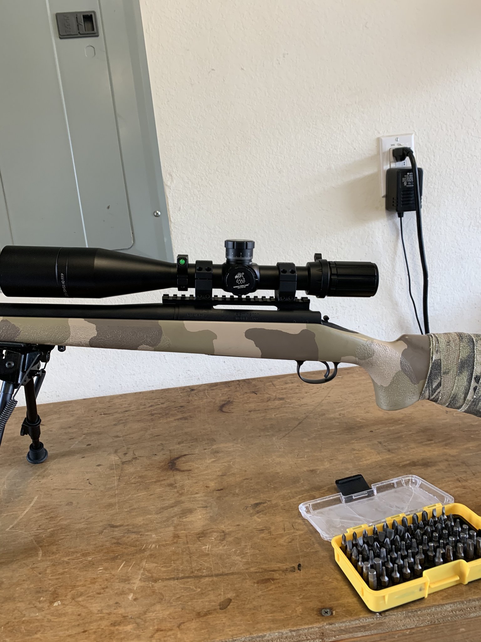

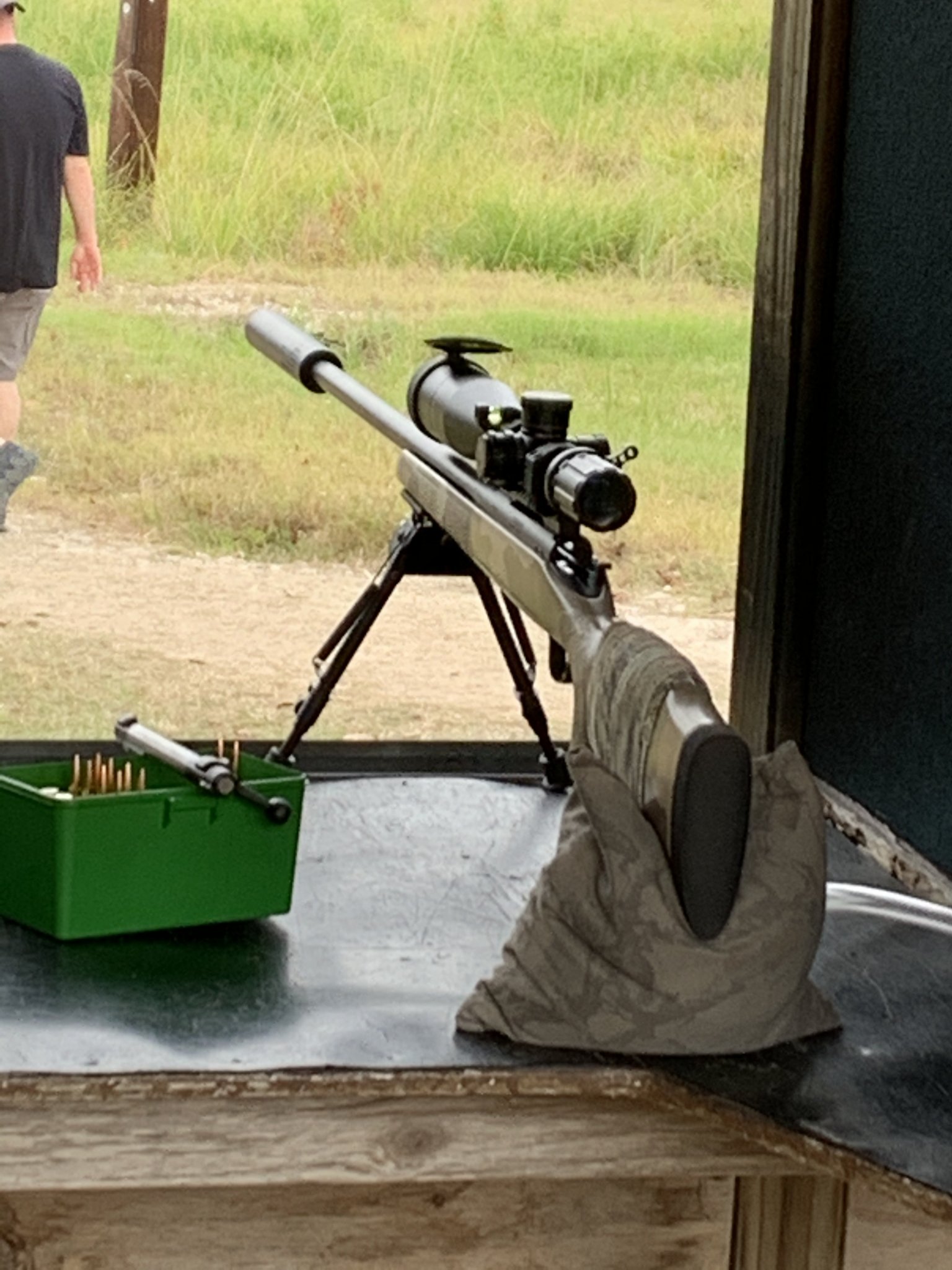

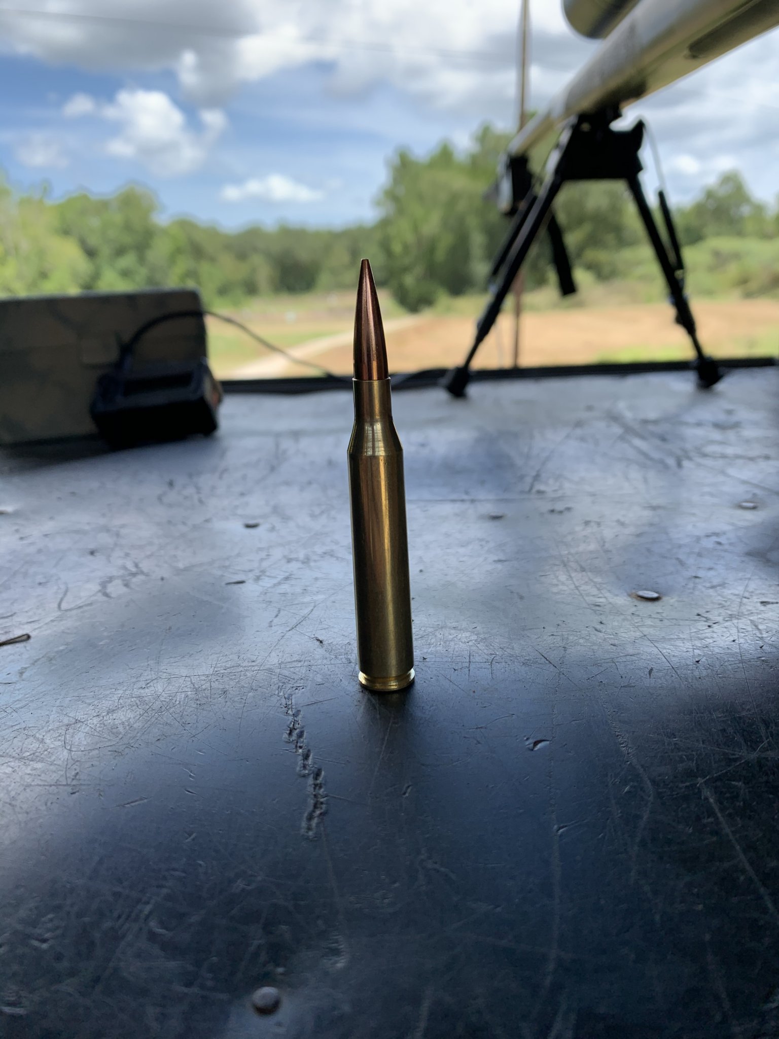

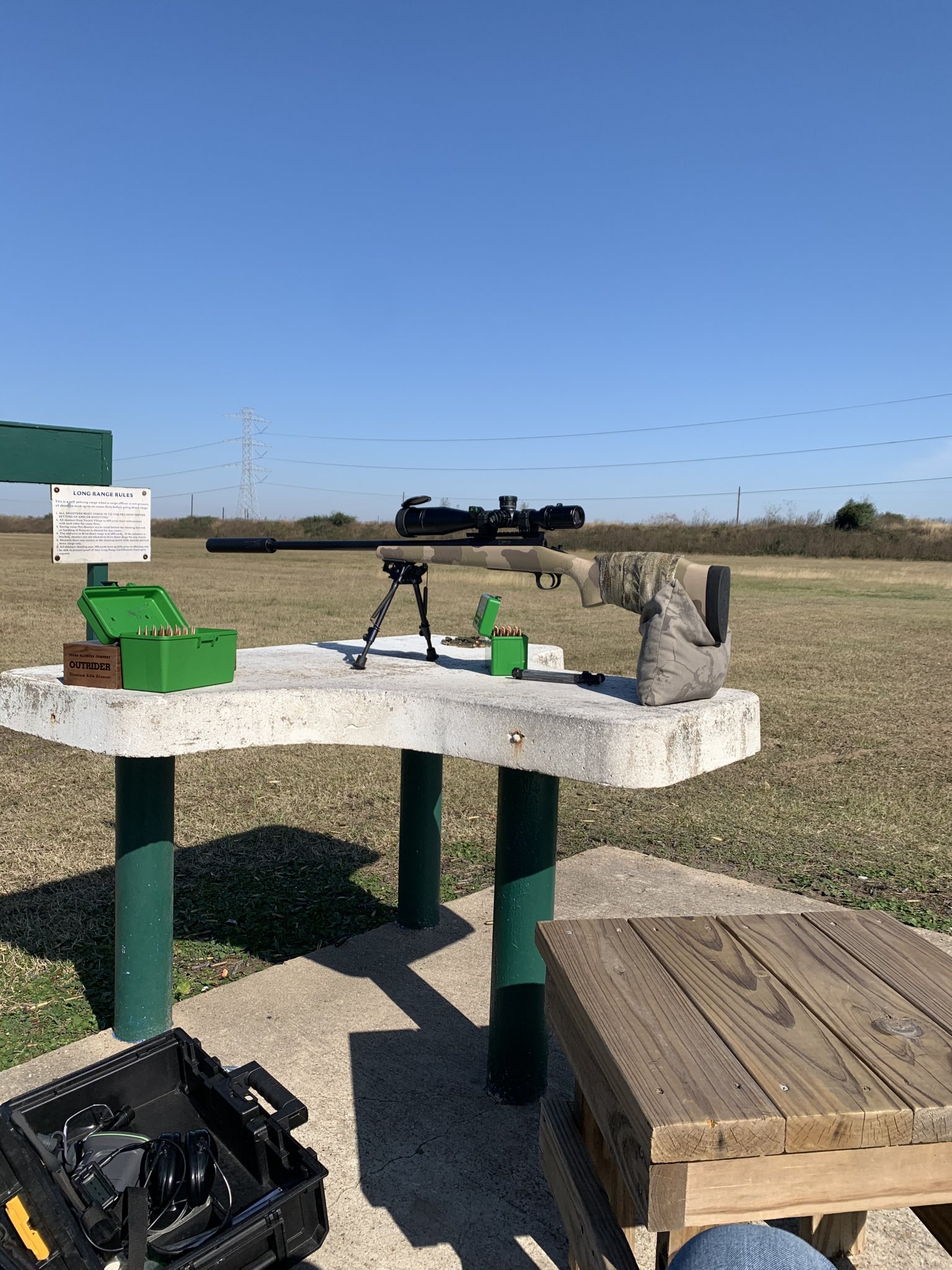

Built my 6.5-06 on a Rem 700 long a action
Shielin Select match grade barrel 26”
McMillan HTG desert cammo stock

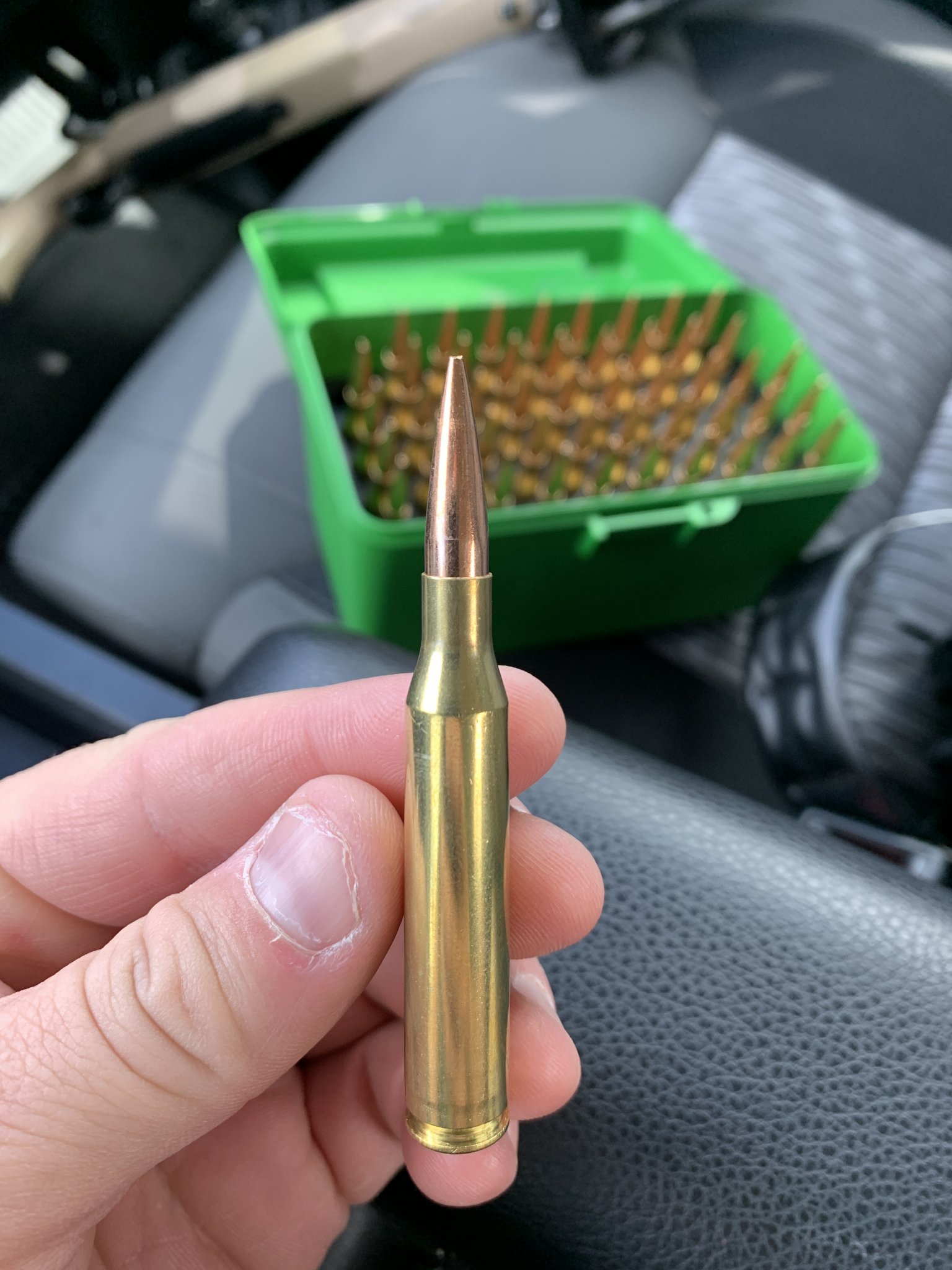

Texas silencer company titanium can on the end. I was getting 3100-3175 with Retumbo/140 Berger’s when I could get it. Then moved to H-1000. Velocities not as high but still a great powder/ bullet combo. Now shooting the 150 smks at steel and paper with H-1000. I have always used 25-06 run through FL 6.5-06 die then clean and load. BUT with the whole populace buying all components I’ve been forced to try and use Lapua 30-06 brass that i have lying around. Running into failure to chamber Issues... found that I have to turn the necks which is a huge PIA. They chamber now but have not shot them yet to fire form. We’ll see tommrow. 😎

Yeah I tried 30-06 and it doesn’t really work. the necks are either too big and won’t chamber or after turning the necks down two or 3 thousandths to .013” the round will chamber but the necks split off upon fire forming. for me I’m tired of messing with 30 odd six it’s too much of a pain in the ass I’m just gonna use 25-06 or .270
