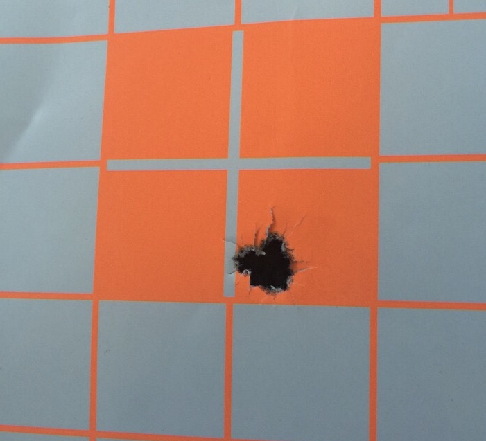

My hawk hill 7.5 twist likes 140g eld the most by far. Generally .4 groups with an odd .6 here and there.
