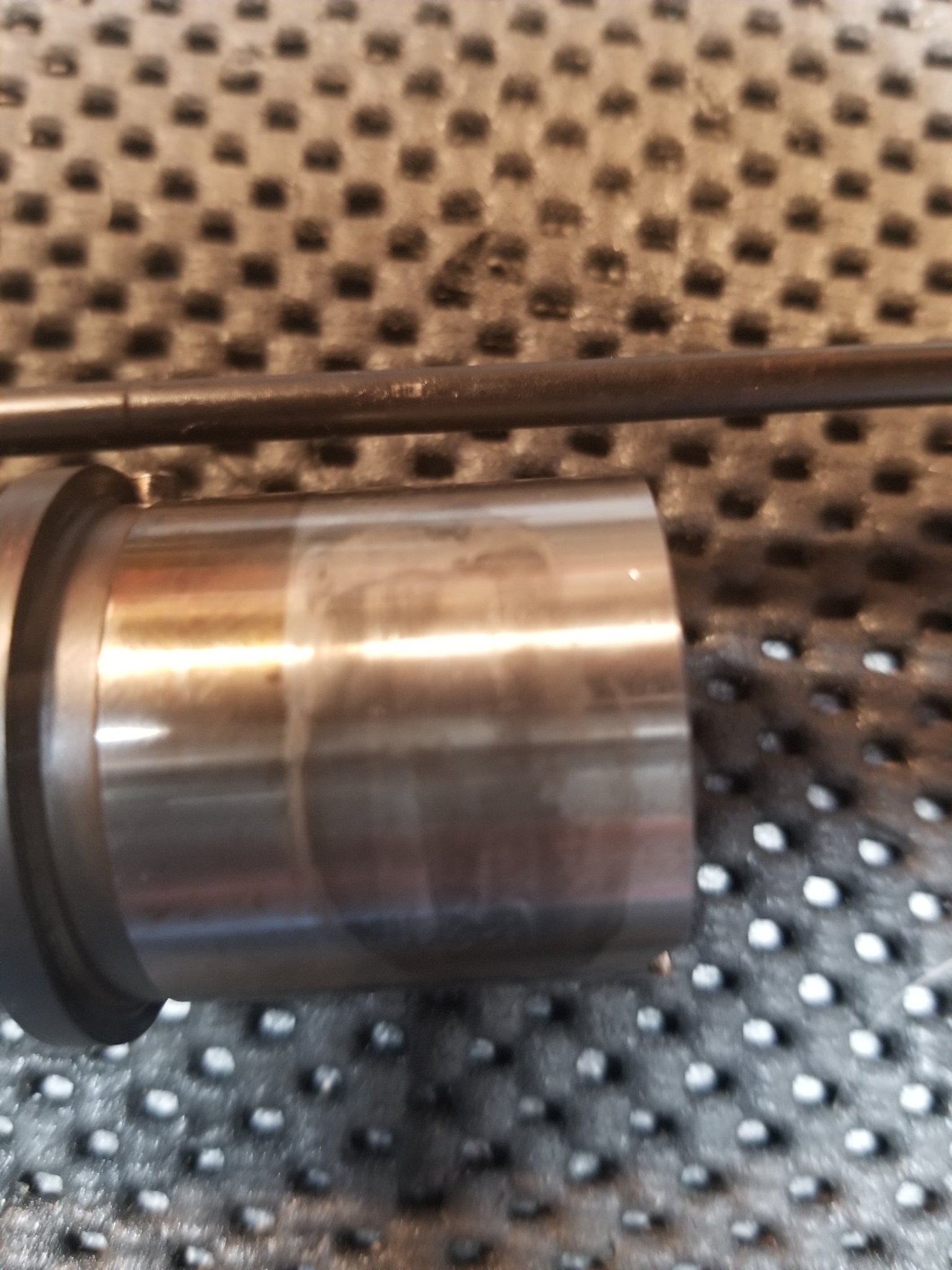

    After putting this together last year and taking it out a few times, I was let down by the accuracy. It is well over 1 moa with both 140gr Hornady match as well as 130gr. Federal GM Berger.
    After doing some browsing I saw some threads about leaping the receiver face and "bedding" the barrel extension.

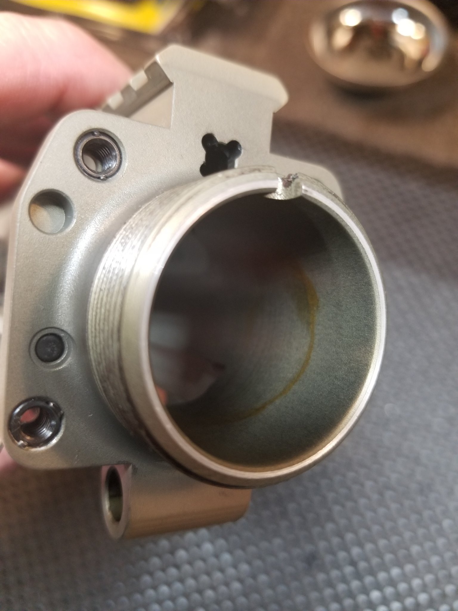

    So tonight I broke it down to give it a look. As you can see in the attached photos there is maybe 30% contact. There is a significant amount of play.
    My old bench calipers are suggesting the upper ID is 1.184 and the barrel extension OD 1.180.
    I guess I'm going to take a stab at the "thermoset" technique with some shim.
    Any other suggestions?

    If you are looking to lap the receiver X-caliber BART 2.0 is what you need. You can use the tool hooked to a drill but what I have found to work best is put the receiver in a vise with the barrel part up, and let gravity help. Do a few turns at a time and don't rush it. If you need to bed it check out the video I've pasted here. It uses a gasket compound that is good with heating and cooling cycles.
    One more thing about the BART, you can also use it like you would a geissele reaction rod.
    With regards to actually shooting as some posts here have said I will just add that shooting AR rifles is an entirely different ball game since they magnify every bit of movement or influence you put into them.
    Happy building!
    Reactions: Halfnutz
