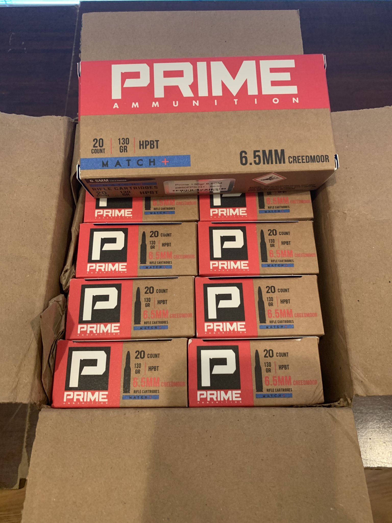

This is good info for me as well. Just built my 6.5 and was wondering the same thing, starting point on loads. I bought a bunch of this to get going and get my rifle dialed in.

Starting load will be 42 and work up to 43.2gr of Reloder 16 or H4530. I found the sweet spot was 42.8-42.9 in my Prime brass with 130's and a Fed 210M primer, loaded to 2.775" OAL. This load gave same velocities and accuracy as the factory Prime ammo.
Since I have H4530 on hand I’ll go with that. I really do appreciate the data and help.
