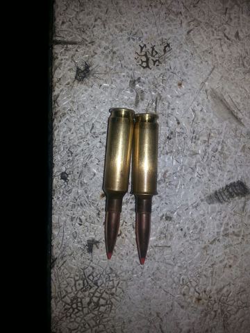

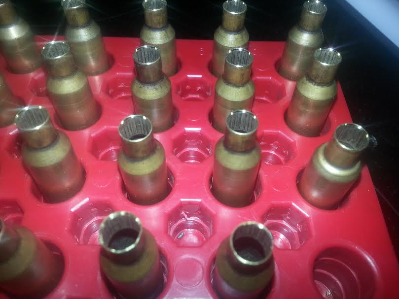

got another question guys. so I've been reloading 120 grain amax with know problems and decided to try some 140 amax. I annealed the brass, sized, checked case length. and here is what's happening. some of the brass loads fine and the others mushroom at the shoulder. I checked the bullets and they measured .262 to .264. case length is 1.920 and oal I set to 2.800 I'm using the same hornady dies. any help would be greatly appreciated.

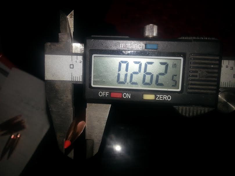

I seriously, seriously doubt you're finding bullets .262" in diameter. If you are, that's a serious problem in an of itself.
You are collapsing the shoulder because your case necks are too small, you're not deburing/chamfering the case necks, you've over annealed the brass, or some combination thereof.
chamfered brass and heres a pic of the bullet size. and was wondering about the annealing. the one brass on the bottom right I tried to adjust the sizing die a little deeper and it mushroomed the brass also

Looks like you are not setting up the dies properly (too deep). Easier to see it than explain it. Go to RCBS web site and watch the short video on die setup and you should be gtg.
here's how I set my dies up full length sizer screwed down until it touches the ram and I tighten the locking ring. decapping pin sticks out 3/16 of a inch from bottom of die hornady spec. on the bullet seater I screw down the die until it touches the ram and then back it out one turn. when I start screwing down the bullet dial until I get to 2.800 oal. some times the brass collapse and some times it doesn't. sorry for all the post just trying to get all my info out there

OP: To set up your seater die, back the seating stem way out of the die, and install your seater die into the press just a couple of threads. Then put a ready-to-load case into the shellholder and raise the ram. Next, thread the die down until it starts to get tight. The tightness you feel is the die contacting the casemouth and beginning to crimp. Once you feel the tightness, back the die out about a turn. Lock the jamnut on the die and adjust the depth of your seating stem to achieve your desired COAL.

The only die you initially set up to touch the shell holder is the SIZING die. You DO NOT begin with the SEATING die touching the shell holder. Set the SEATING die up as follows: Put a case in the shell holder and raise the ram all the way to top of stroke. Then, WITH AN EMPTY CASE IN THE SHELL HOLDER, screw the SEATER die down until it makes contact with the mouth of the case. Do not force it any further. Now back the die out about 2 rds and lock the lock ring. Then when ready to seat a bullet, back the seating STEM out of the die a LOT. Charge a case, insert it in the shell holder and place a bullet on top. Raise the ram to top of stroke again and screw the seating stem back down until it touches the bullet. Lower the ram slightly and screw the seater stem down some more through trial and error until it seats the bullet to your desired depth. Lock the seater stem down.
If I have mis-interpreted your post please forgive my error.
ETA: If you DID set the seating die up to touch the shellholder, it will have to be backed out probably an inch or more. So backing it out just a couple turns still ain't gonna fix it. Start over using the above procedure.
MOST seating dies have the ability to apply a roll crimp if one is desired. By backing out the die so that it does not touch the case at the top of the stroke, you are "turning off" this crimp feature like another poster said. If this crimp is over-applied even the slightest bit, the shoulders will collapse just like yours are doing.

I have had this happen before when I had the bullet seating die miss adjusted. As with the prior post it looks like the seater die is touching the case mouth.

^^^^^^This ^^^^^^^^^^^^^^ could very well be the issue. Hornady seating dies are different than most other dies, If the O/P didn't set the seating die up per the Hornady instructions. I own a few sets of Hornady seating dies, they are different.
I started reloading again tonight and everything went together like its supposed to. i'm still pretty new to reloading and don't have anyone to lean on for help and you guys help a lot thank you. I must of had the seating die in too far.

Yes-only the seating die will collapse the shoulder like that, and at the seating stage is where the case got destroyed. You cannot screw the sizing die down far enough to do any damage like that. Glad you got it figured out.
