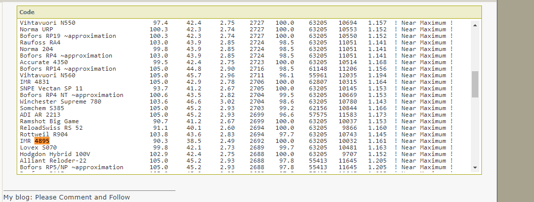

Found the forum for the IMR4895 and near max load is actually 38.5gr
Psi- 63205
90% velocity-2692
muzzle velocity- 10032
IMR also burns a little slower than Hogdon 4895
In a small case like the 6.5 Creedmoor you don't want a small charge of fast burning powder. Especially with the 147. I would try H4831SC with the 147. If you max out case capacity and are still to slow then try some of Alliants powders.
38.5gr near max load
Psi- 63205
90% velocity-2692
