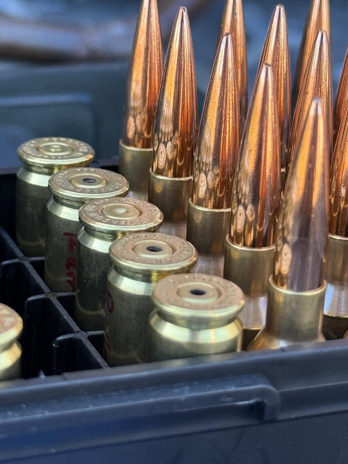

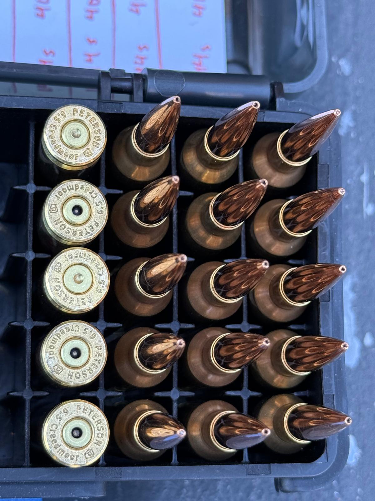

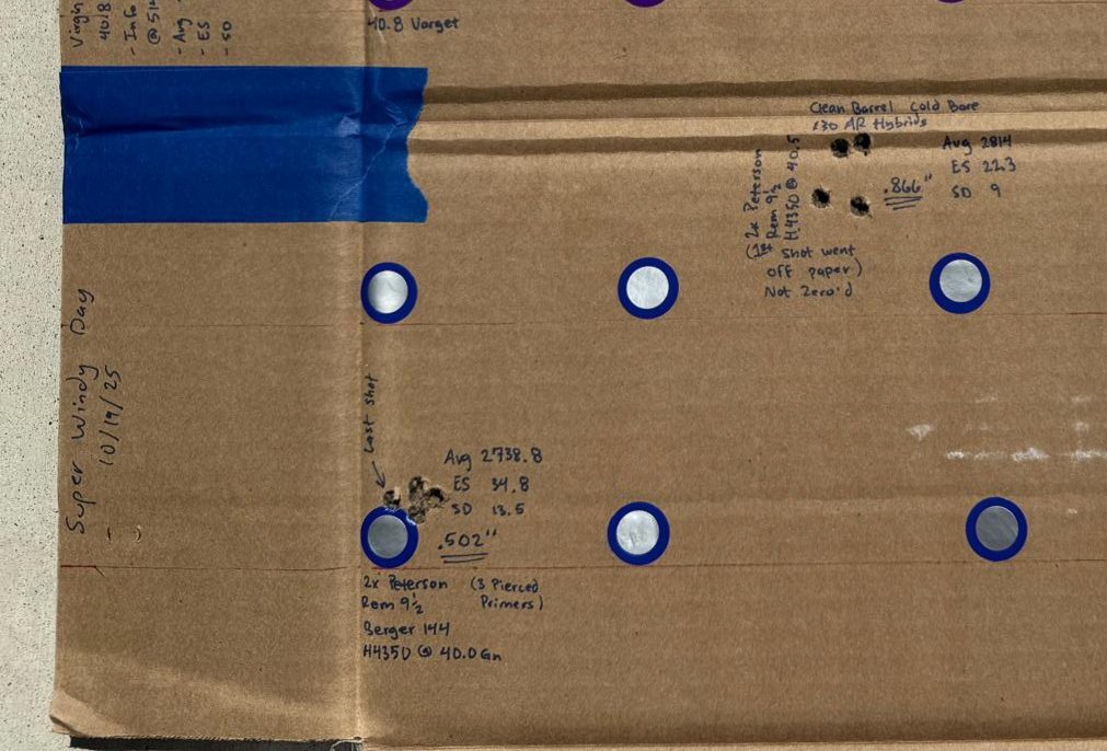

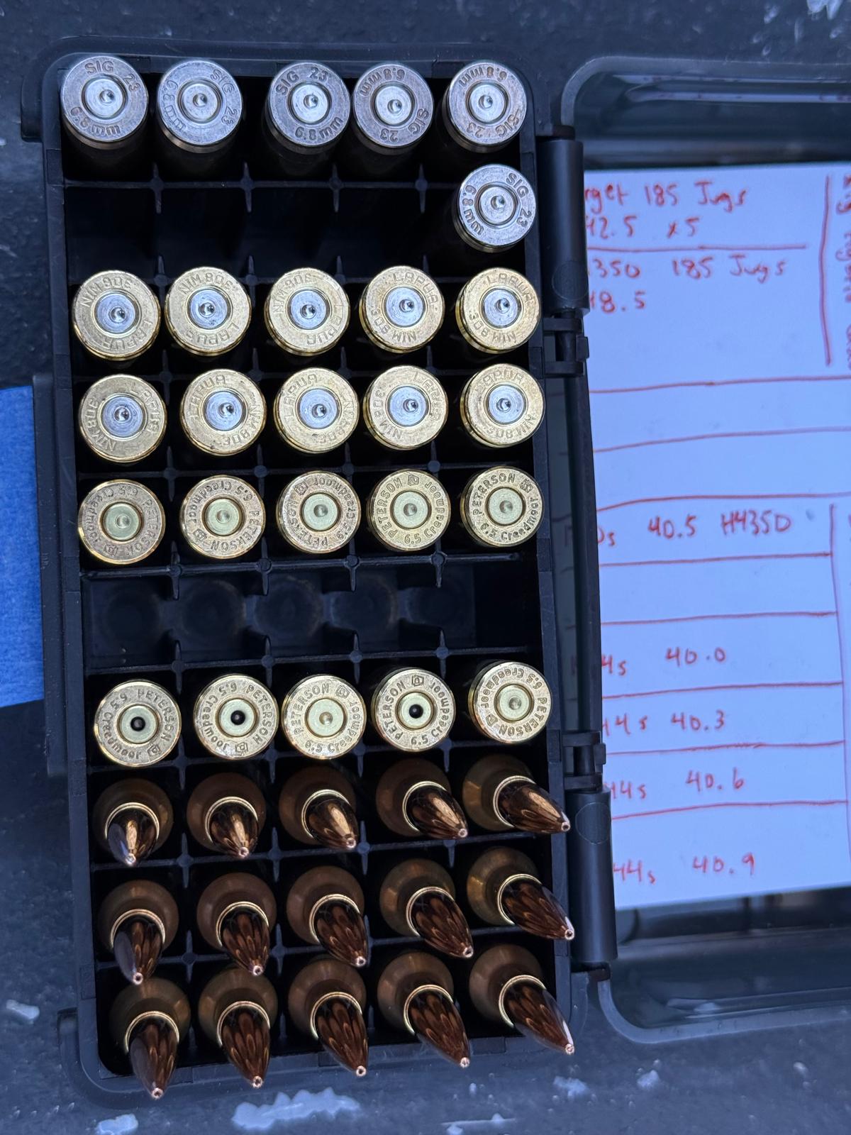

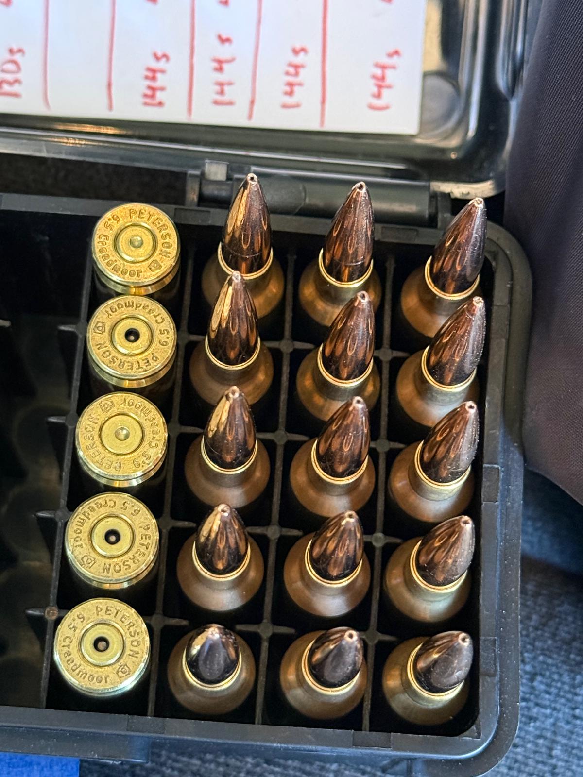

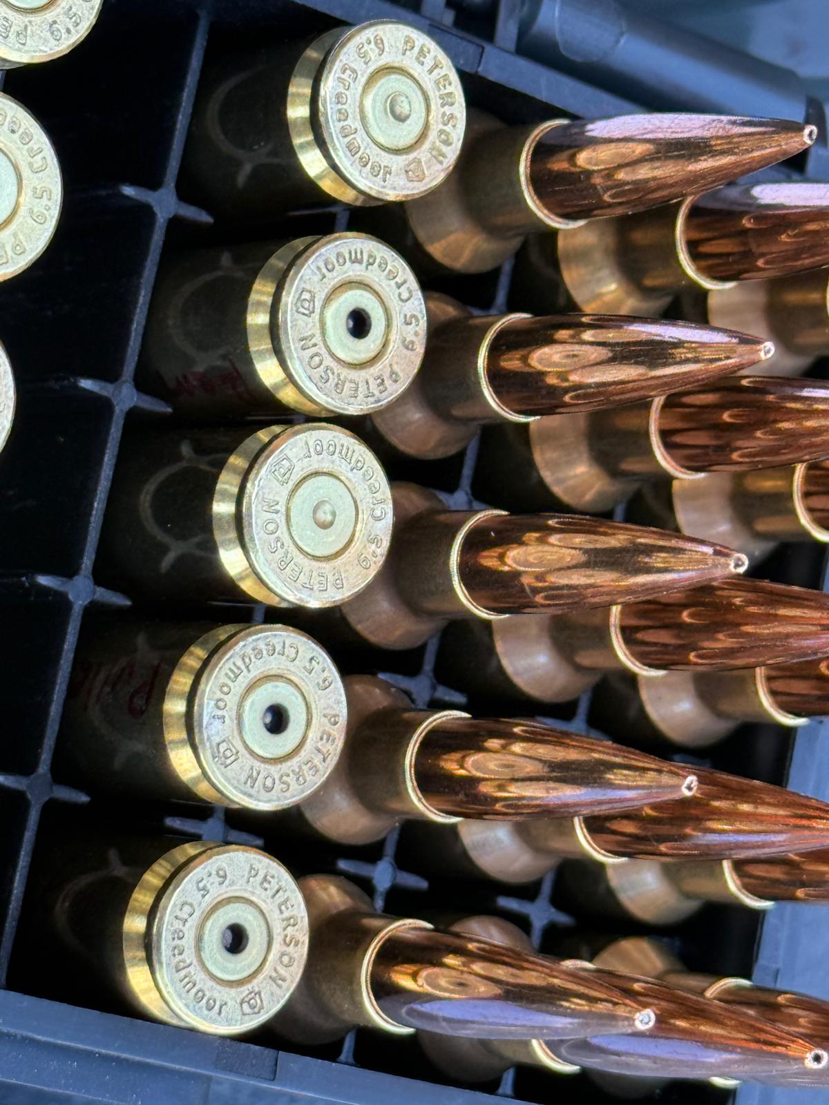

Reason I asked, I just got back from shooting and had 3 pierced primers. My charge weight was 40 grains. I've been having trouble with this damn rifle. Before, I had mediocre groups. Today, I had a very acceptable 5 shot group but 3 pierced primers. Primers are Rem 9 1/2.
View attachment 8790252View attachment 8790253View attachment 8790254View attachment 8790255View attachment 8790256View attachment 8790257

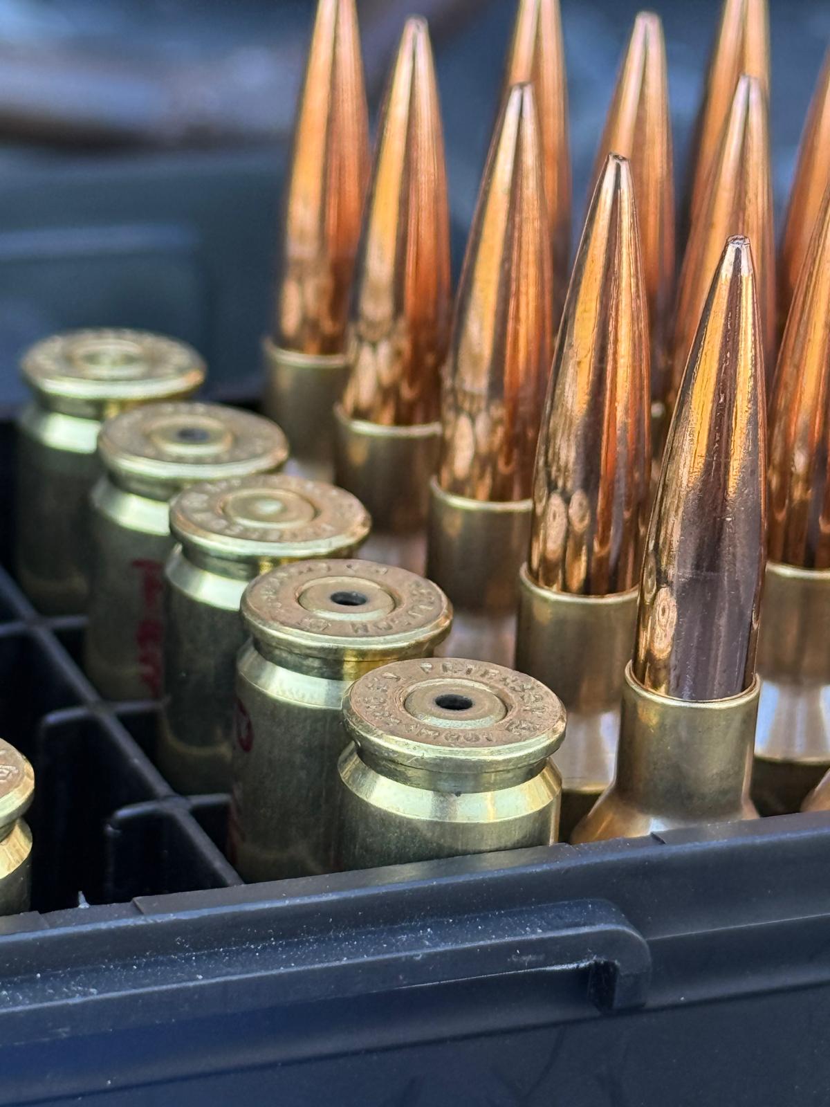

For reference on the below pic. The other 6.5 CM fired cases had 130 hybrids with 40.5 grains. View attachment 8790258
Anybody else care to share some knowledge or tips on my precious post up there?
I suppose I can switch to Wolf LRM and back down the charge a bit more and test. I just happen to have more rem 9 1/2 primers so I wanted to stick with those.
