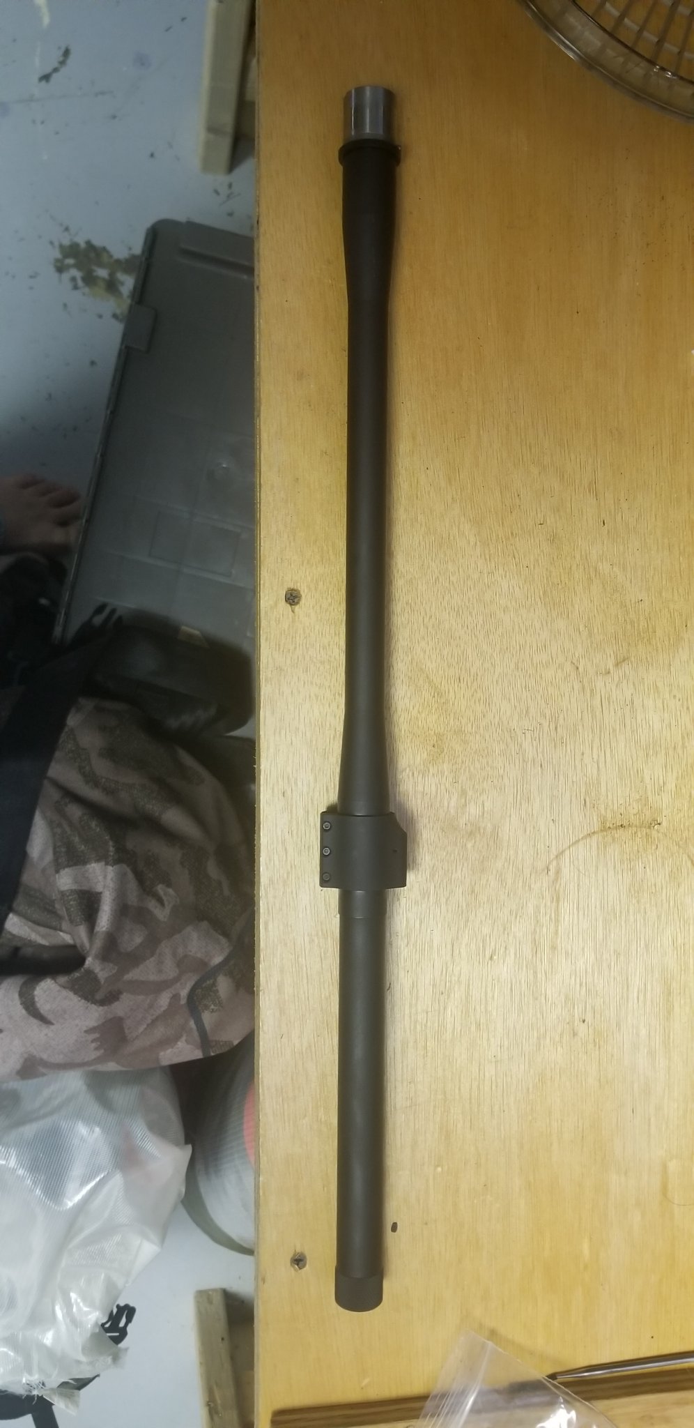

I have my Gibbz side charge with extended "competition" handle. 22" black JP barrel got here the other day. Hopefully putting them together tomorrow. Just need to pick up a low pro gas block and put it on backwards. May put some rounds through it by the end of the week.

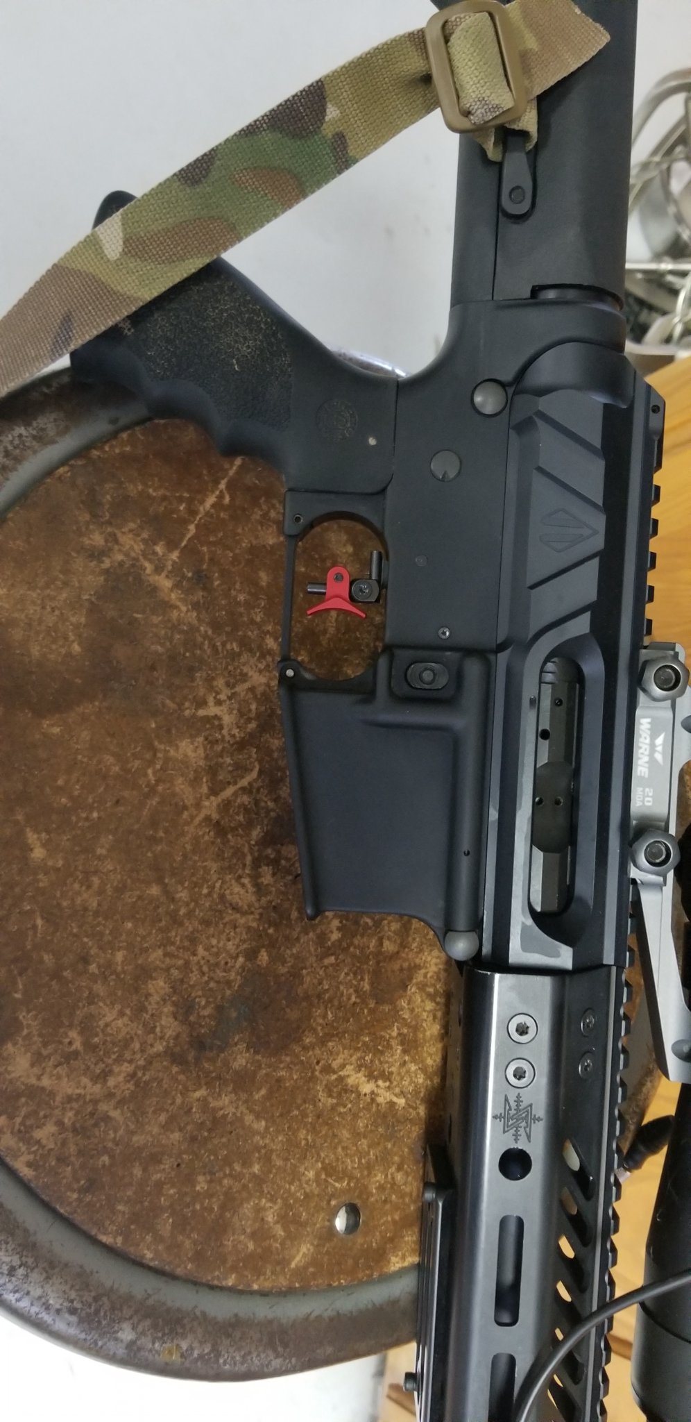

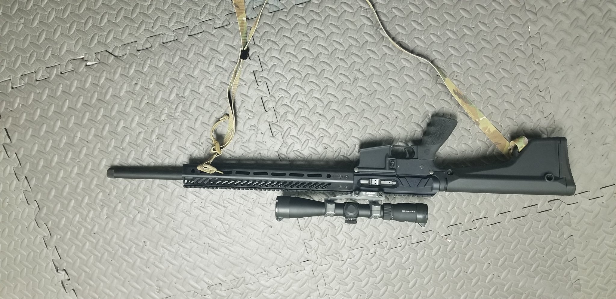

All put together.
Gibbz left side charge with extended handle.
JP 22" supermatch barrel
Scope is a leupold vxr 4-12, that will be changed out when i save up enough $$
Have a magpul prs stock on the way.
Trigger now is a cheap rock river 2 stage, either going larue mbt or may save up more money, thinking timney calvin elite.
But it is a straight pull, no gas system rifle.
Hopefully trying it out tomorrow.

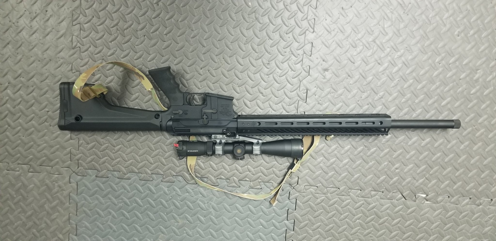

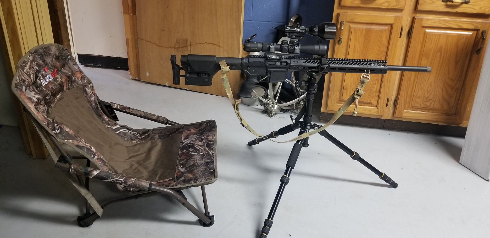

Thought id throw a updated pic in with magpul prs stock. Also its getting a timney calvin elite trigger. In its current setup for yote hunting.
