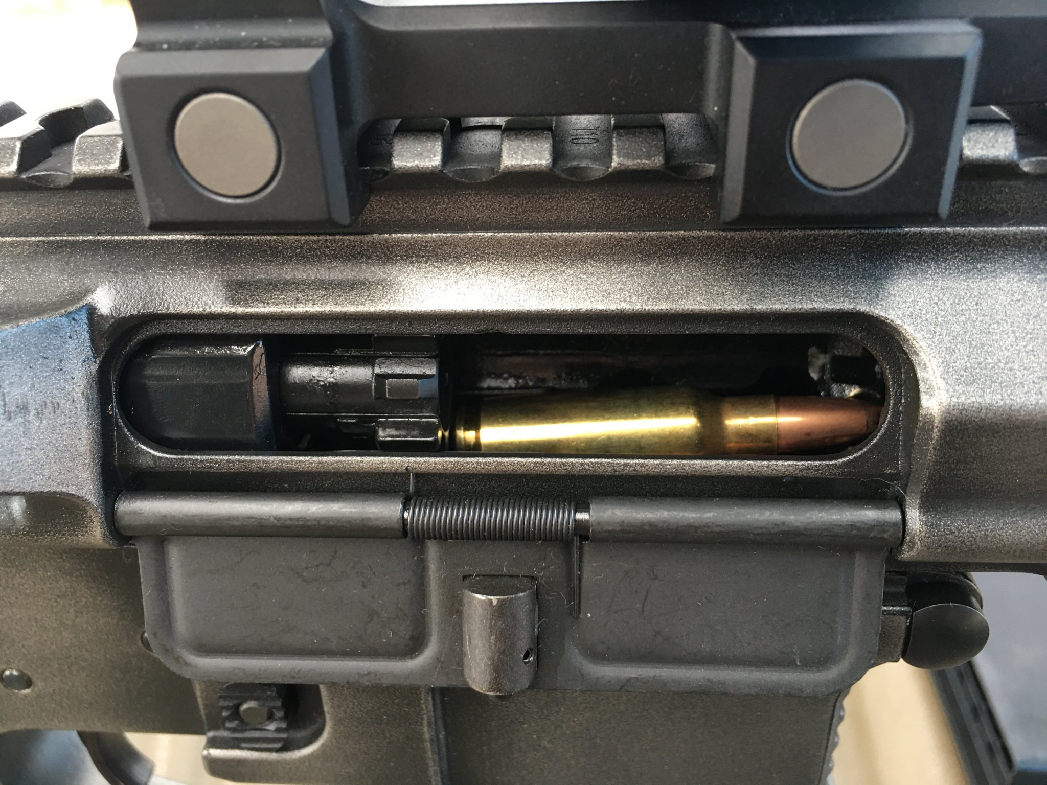

I have a newer 6.5 Grendel and the second round from the mag won’t go into battery. I replaced the rifle buffer with a nice JP captured spring buffer and still no dice. The thing shoots great as a single shot, but both factory and hand loads have the same issue. Tried two different mags, same thing. ideas?
I have the same problem. For me is excess friction between bullet and feed ramps.
Bolt is dropped...

A springco(Tactical Springs TX) RED spring will force it in there. A lot of LEO use the red spring and H2 buffer to keep things moving when they get hot, dry and dirty. Barrels must be ported correctly to work with a stiffer spring and heavy buffer.
You may want to take a close look and figure out exactly what is slowing it down. Is it the tip of the bullet or feed lips on the mag? In the past we have trimmed the front corner of the feed lips on a 45* angle, it will release the cartridge smoother. You may also want to look for sharp edge on the feed lips.
Not sure about OP, but for me it’s on the feed ramps. Bullet tip is not touching back of barrel. In the above picture I have a sprinco red installed and that’s the first round in the mag.
I haven’t tried other mags yet. Also the feed ramps on this barrel (criterion) are the worst and toughest I’ve ever seen. Plan is to pull barrel and polish.
Definitely polish the feed ramps if they are rough. Be careful not to re-shape them if you don't know what effects that has.
What magazines, and how many rounds are you putting in them? I've found my 15 round ASC mags just work better with only 12-13 rounds in them. Would be nice if the full 15 was gtg, but they aren't 100% that way so it's a simple fix. I have other larger mags if I want more capacity.
Even in 5.56, the times I've seen an issue like the picture above, it's been a magazine issue, either from too many rounds (guys jamming 31 in a 5.56 mag) or something like the ASC mags I described.

Two or 3 rounds in a 10 round mag. I‘ll look into another mad, but I might try to take some friction off the feed lips

Does it stop where you took the photo half in and half out of the mag or is the cartridge going in the chamber but the bolt does not lock in?
That wasn't my pic. That was an example from another guy. Mine looks like the bolt is closed, but it appears the bolt isn't rotating into battery as I have minor difficulty opening the action with the charging handle. If I load a single round in a mag and hit the bolt release or release the charging handle it fires. However, it won't pick up the next round in the mag, chamber and fire it.

Was my pic since I’m having similar issues. I’ll hold off so as to not steal OP’s thread. I’ll make my own when I get time to mess with this rifle.
