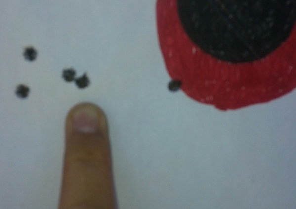

1st pic is from the day I "Found my load" 100 yards

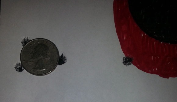

Today 750 Yards - I need a lot more practice doping the wind, it was hell but heres a 5 shot group.

You are really squeezing alot of velocity out of your Grendel. I haven't used reloader 15 in my grendels, and with a 20 inch barrel, I loose velocity there too, but I'm only getting 2540 fps with the 123 scenar... 2700 fps is COOKING!
I really think the Grendel is a neat round, and even with my modest velocity, mine doesn't go transonic until around 1400 yards, so I stay with more modest velocity and my brass lasts almost forever....I quit counting after 6-8 reloads. I use the cci450 primers though. You might take a look at the Grendel website if you haven't already. Great choice on a terrific round!
i agree with unknown 2700 for a grendel little bit too fast for me my satern 1:8.75 (i didnt know sater has 1:8.25)26" running 28.3 xbr8208 pushing almost 2600fps
accurate enough never tried byond 400.
