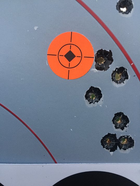

I was running low on light by the time I got to shoot and got the gas block adjusted, these were the only groups I could get before I couldn't see the cross hair. The POI shift is me adjusting elevation.

Thanks again - is that two, 3-shot groups?
Also, is the 4.6 lbs of the upper without optics?
Yes that is two three shot groups, in lighting where I could barely see the crosshairs. The high round was my initial shot at 100, when zeroing, over-adjusted, fired three, then came up and fired 3 more.
Yes 4.6 without optics. If you go with the 18", and a lighter brake you could probably get it down closer to 4 lbs.
I'm certain it will shoot better than I represented it. But sub moa isn't a bad place to start.

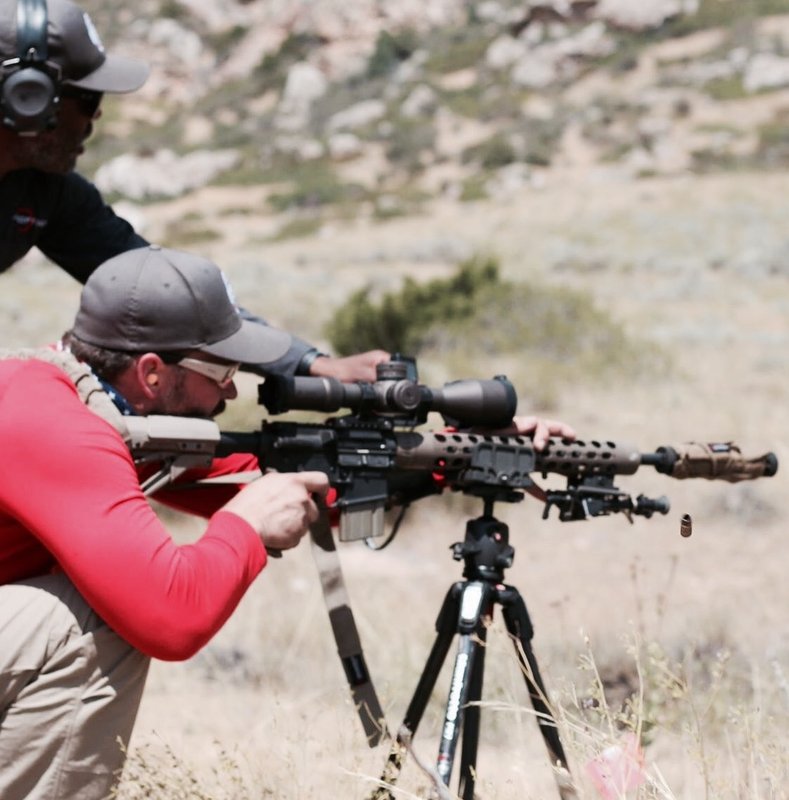

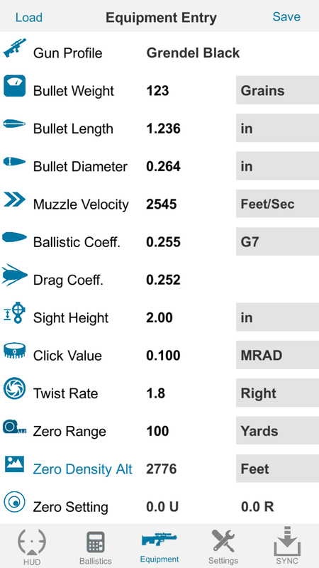

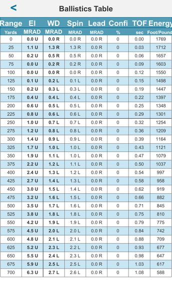

Got a chance to run this thing with a labradar. 123 ELD Hornady Black runs at 2,545 fps average over 15 shots. Also took it out to 700 yards on MOA sized steel targets. a little more elevation, and wind drift than I expected, but once I learned the how it shot it was not too difficult. Unfortunately I have a problem of wanting to shoot fast with a gas gun.
