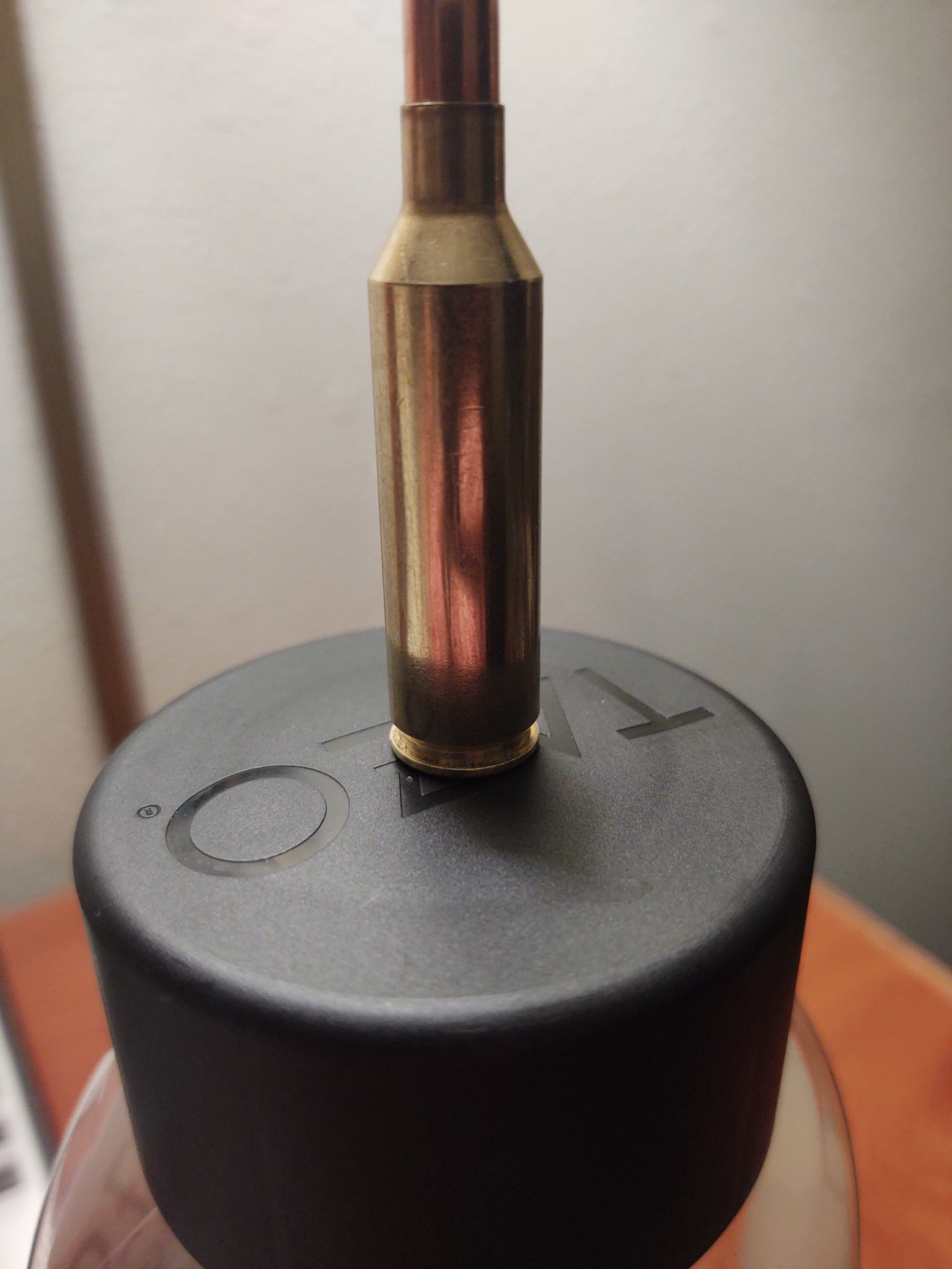

This pic is of case after being resized ( they all look the same that have been resized bullet seated or not)

Edit: you can see where the sizing die die not size the entire neck, so it never touched the shoulder. that is your problem.

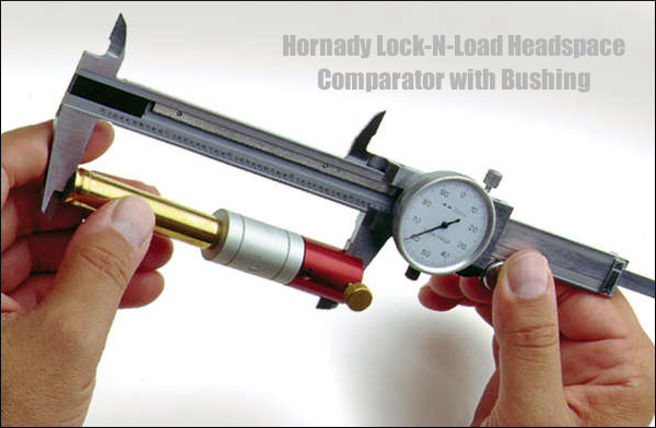

1. You need a way to measure shoulder setback, or bump. No, not the length of the case. I mean using a comparator, or something that can act like a comparator. It should look like this:
Measure a fired case. Note this number. Screw die down and resize, until the resized case is your first number, minus 2-3 thousands. "oh, but what if I measure it and it is longer than the fired case?" Screw the die down further. This is normal. Trust us.

Without the right tools you’ll never know correct die position.
The tool pictured is the right tool.
