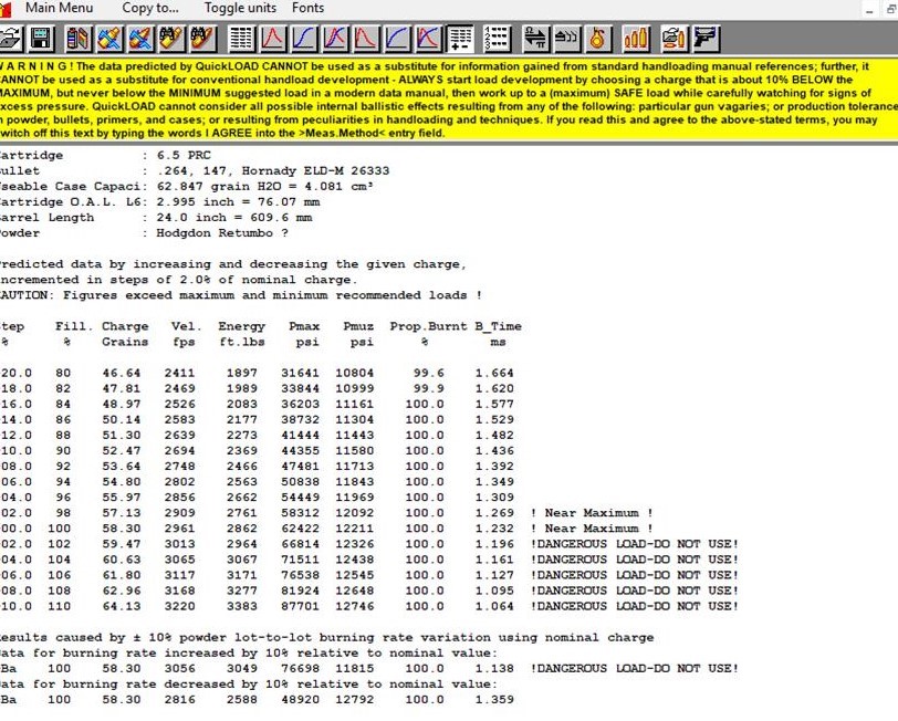

    What's your cartridge's COAL (like 2.995?) and how far are you off your lands?
    With a COAL of 2.995 and 58.3 grs of Retumbo, it seems to me you should be able to get over 2900 fps. But that's getting some high pressure.

    I only asked about your jump to get an idea of how much room you might have to lengthen your COAL. Looks like you're loading pretty long at 3.100". For my Berger 140's I'm now loading at 3.085 COAL at .011 off my lands. For my Berger 153.5's they're at 3.057 COAL at .039 off the lands and I get 2944 fps with 57.2 grs of Retumbo out of a 26" barrel.
    Keep in mind that different lot of powder will have different burn rates, so one is bound to see differences from what Hodgdon has on their load data. Based on my adjusted burn rate for Retumbo, you load configuration might look like this at a COAL of 3.100 (just to give you some perspective):
